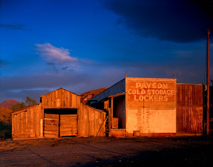

Hi all. I used to be into film in a big way. I'd shoot 4x5 Velvia (50, shot at 40) landscapes in Utah, bring them home and develop them using the Kodak E-6 kit, then print them on Fuji Type-35 using R-3 chemisitry. I loved doing that. Did it for years, concentrating on the San Rafael Swell of central Utah. So much fun. I've attached some of my old pictures.

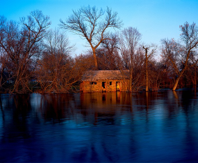

I'm long a fan of controlling saturation in the camera. Here's an article I wrote about it: https://photos.kf7k.com/saturation.asp
And of course Velvia was helping!
That one with the river is overexposed by at least 2/3 of a stop and came out bleached, but I went with it because it helped make the image feel a little more abandoned and old than my original idea while shooting it. A half grad would have fixed it. I've never printed that slide. I'd hold back the sky some if I did.

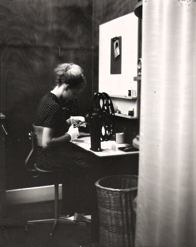

Europan
May 21, 2009
645
Äsch, Switzerland
Gigabitfilm 25 in 4" Ă— 5", Anniversary Folmer Graflex, Euryplan 127 mm, diaphragm opening unknown, exposure time half a second, original developer from the Gigabitfilm company, enlargement on paper 24 cm Ă— 30 cm, cheapo household scan, digital enhancement

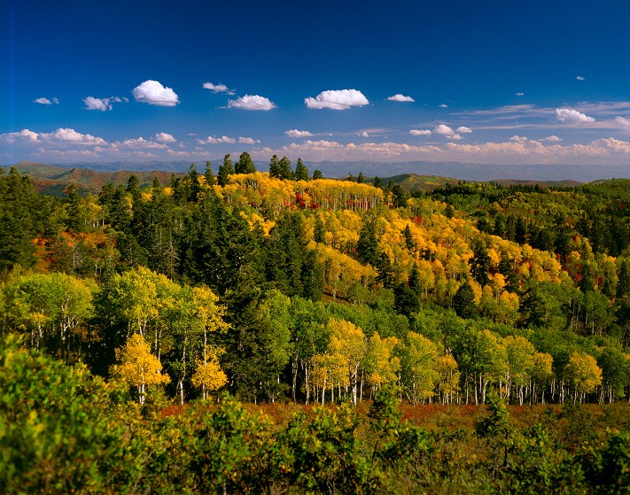

Welcome back/. Velvia 50 is my favorite film. Unfortunately, Fuji has discontinued it in large forrmat sheet. I;ve got 2-3 boxes saved in my freezer. It;s even hard to find in 120.
My Velvia 50 in 120 and 4x5.
