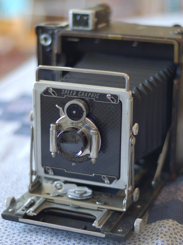

I've got a Speed Graphic. I've got a bunch of random lenses, so I ordered lensboards to suit.
First fun problem: The 10" Tele-Optar, which on casual inspection appears to be sized for a #1 hole, *isn't*; it's about a freakin' MILLIMETER too big to go through. So I've got this nice lens, historically correct, distance scale for it already on the camera, but after a week of trying, I still can't mount it. What was done with these historically? Are there lensboards with a 45mm hole instead of the usual 43mm, and if so, why can't I find them? Or were they always mounted in shutters?
All right, so as it happens, I have a couple of brass lenses that front-mount conveniently in an Ilex #3 shutter, and I have an electronic Ilex #3 sitting around that isn't a useful shutter (it can't be triggered manually, except for the preview lever) but works fine as a holder for a barrel lens. The good news is that the shutter fit nicely in a #3 lens board, and after some farcical switching around of flanges from one shutter to another, I got it actually mounted. Trouble is, the shutter body is so big that I can't mount it on the camera; it collides with the little arm at the end of the linkage from the body shutter release!
Well, there are #3 lensboards for Graphics, so I can't be the only one who ever tried to do this. Is there a trick to release the shutter arm so it gets out of the way? (And while you might say "just mount the barrel lenses directly", and you'd have a point, I don't have flanges for them and I don't have lensboards sized for them, so I'd have to find more parts, and I bet you anything those parts wouldn't fit together as expected either! The Ilex is actually a sort of convenient lens adapter in some respects.)
My current plan is to have a fit of frustration, jump up and down a few times, then spend money I don't have buying lenses I don't need. That's a good solution, right? :smile: But seriously, where do I find the odd-sized lensboards for the Tele-Optar, and how do I keep the shutter release from getting in the way of things?

Is this a pacemaker speed with the metal lensboards? The arm is held to the shaft by a little screw - just loosen it and either pull the arm forward and out of the way or slide it off the shaft. I buy boards, undrilled, from heavystar on ebay, and drill them with one of these. You can also spend a lot of money and get a universal iris.

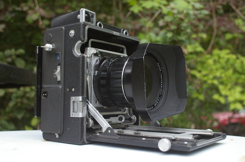

nt, Not sure what your difficulty is exactly but I agree with Tom.
Here is a lens that is almost as big in diameter as the lens board, with the shutter release in its original position but out of action
The rear focal plane shutter is used. The lens board is of laminated aluminum, machined in a lathe.

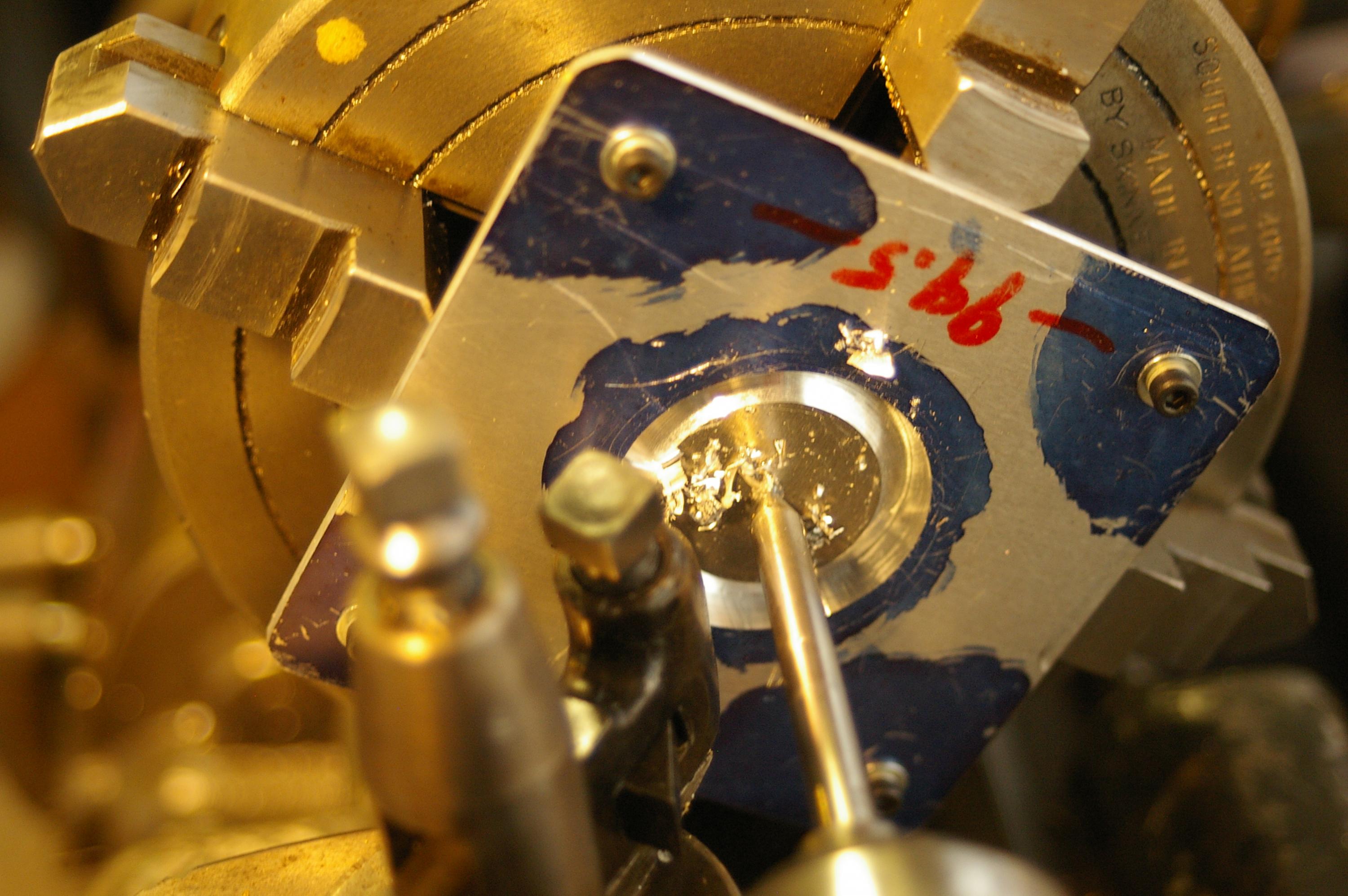

To use that trepanning circle cutter you are going to need a heavy duty machine that can run at slow speed, with a rigid table .
I have one of those cutters here but I can't use it.
Here is how i do it in the lathe.
