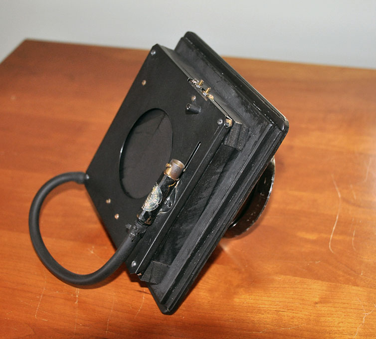

I used some tips from Jim Galli as well, and set out in search of something to use as a "sleeve" to fit over the front of a 15 1/2 inch Wollensak lens. Only a Packard #8 shutter had a large enough opening for this lens, but the shutter housing was way too big to fit behind the lens board. Looked at some plumbing and HVAC supplies, but eventually found a perfect fit in an old kitchen gadget at home. Cut to length and painted black, I then used black epoxy to attach it to the shutter housing. It slides on and off the front of the lens easily, but gives a nice snug fit.

Yep, the glue I used was actually silicone, not epoxy, so it's removable if I need it to be. The shutter housing is 7.5" square and the aperture is 4" diameter.
If I have need for a shutter on a smaller lens, I'll just go the more common route and mount it to the rear of the lensboard, if it fits like this one does:
