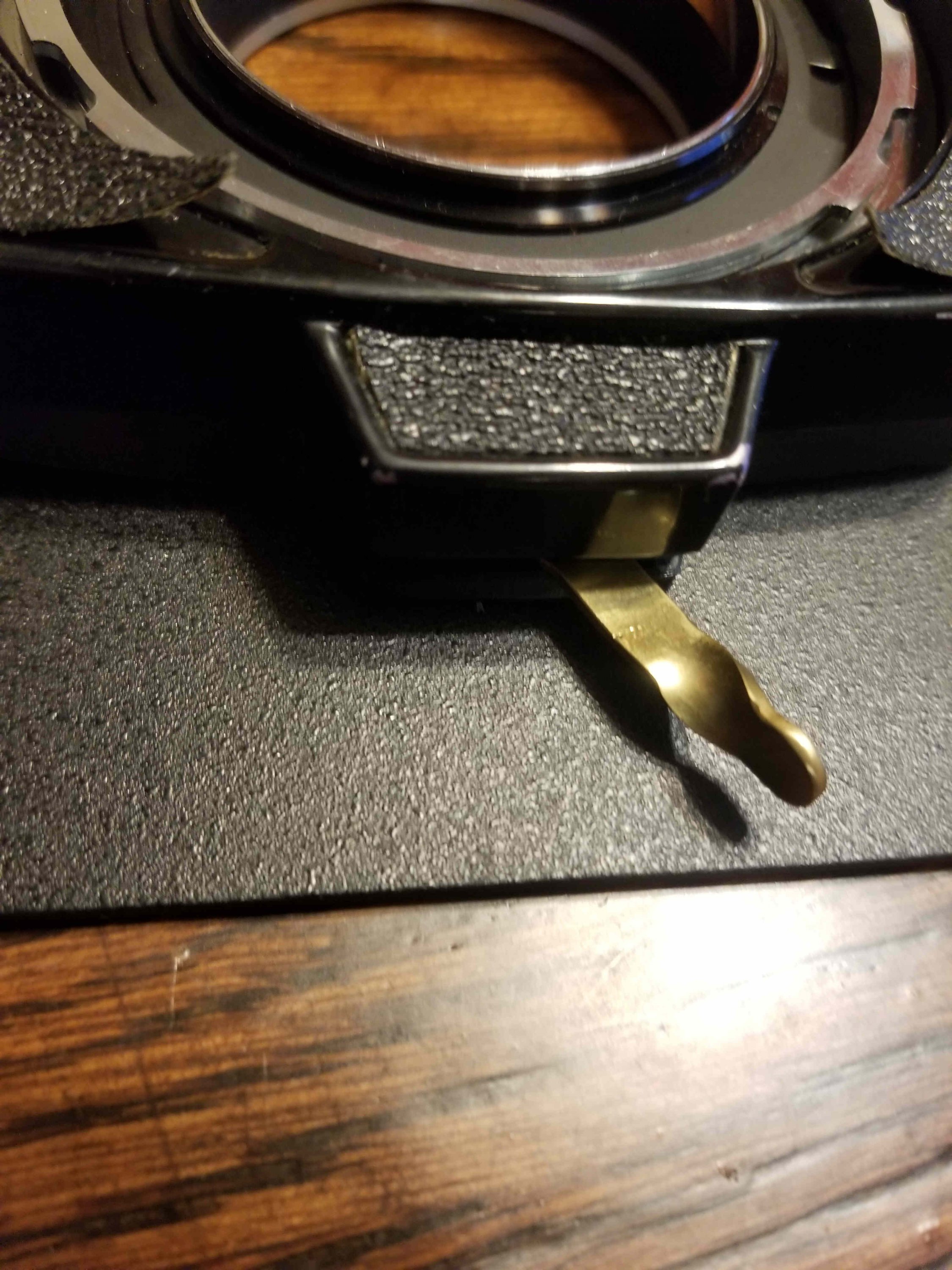

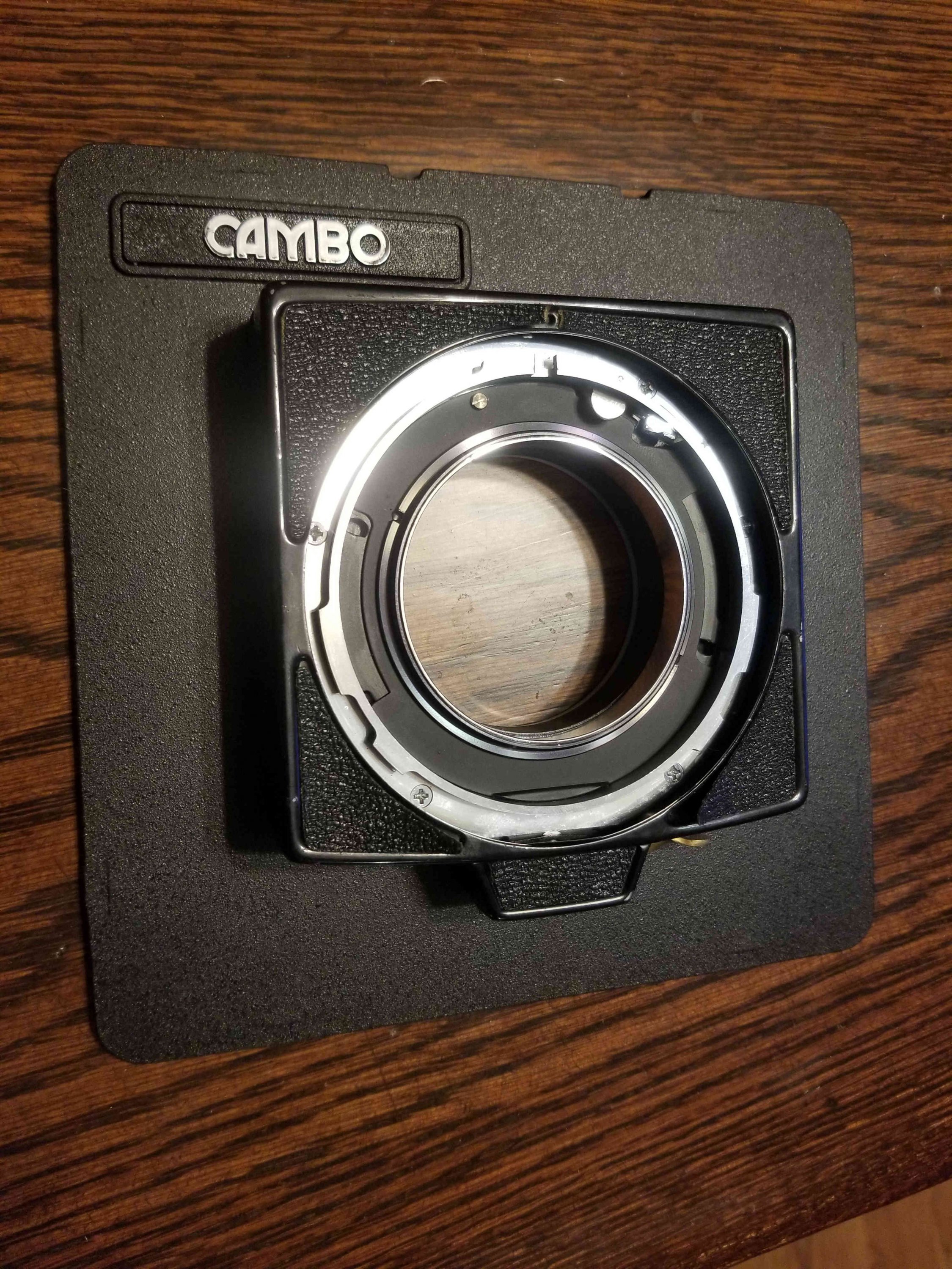

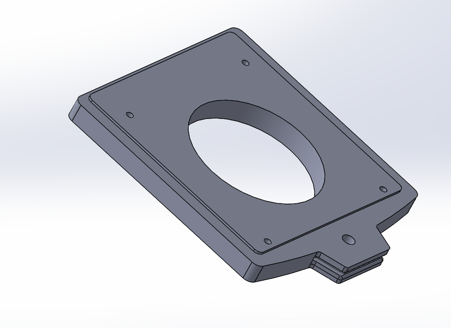

Well, not exactly. I did this the other way around, and 3d printed and adapter to use the RB lenses on my 4x5 rig. No they don't cover 4x5, but I can use the movements, then crop (in the darkroom) to 2x3 or whatever. The hard part was adapting a way to cock the shutter with out removing the lens each time. I sacrificed a "as is" body from KEH for the mount/cock portion. Now IF I had a 4x5 to 2x3 roll-film back, I would be all set to take medium format pictures, with movements, and "RB lens quality" One problem is that my 4x5 is a cambo rail camera. (not very portable) I kind of backed off this project when I "discovered" the baby graflex. This has kind of got me thinking about adapting this lens adapter to the graflex front standard. As my goal has been medium format with movements, and portability.
Update: the front standard on the baby graflex is too small for this to bolt right on. It might fit with some major modification to the adapter.
The little brass lever is to cock the shutter and works fine.
