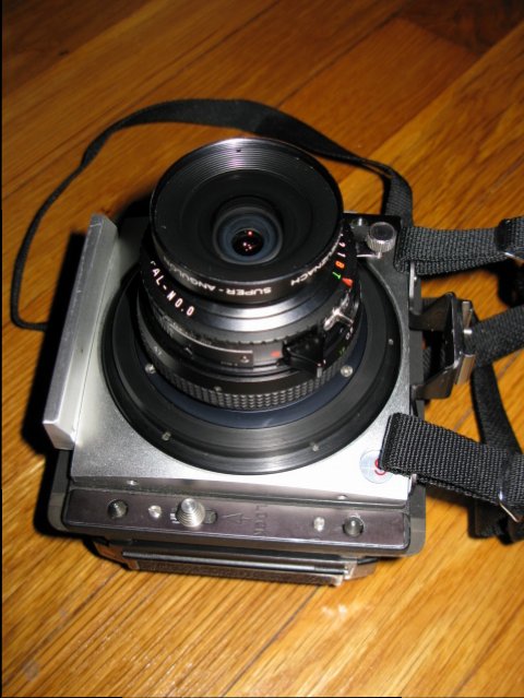

i don't think this is a lightest , but could be one of the choice you make a custom graflex xl
