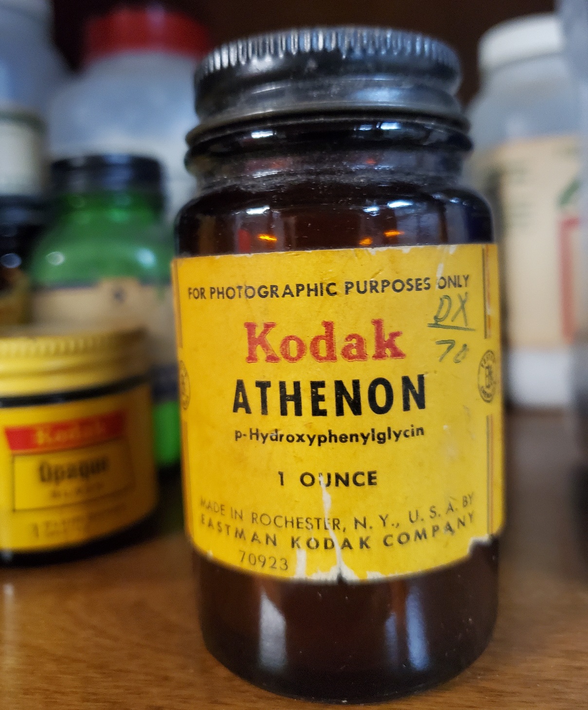

Andy, I really enjoy these videos! I've got some 80-90 year old Kodak Athenon (Glycin) it looks remarkably well preserved, I need to try sometime. I used Glycin in print developer over 30 years back, I need to think this over.
Best Regards Mike
Best Regards Mike
80-90 years old? Let me know what you decide to do with it, and how it went!
