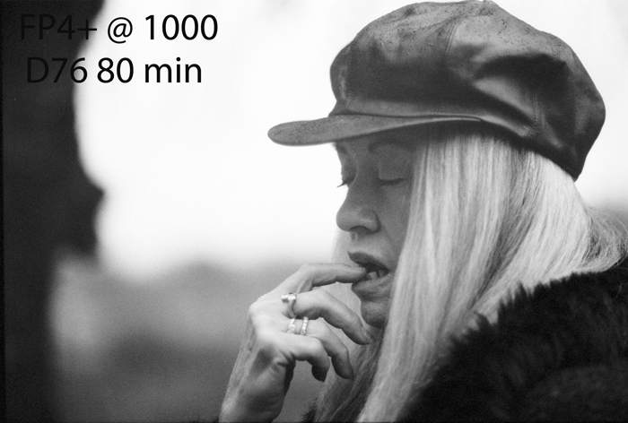

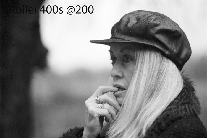

I compared FP4+ @EI 1000 developed in stock D-76 for 80m 20C with Rollei Retro 400s @EI 200 developed in stock D-76 for only 9min. Both were metered from the light hair.
It would have been better to use a slower traditional grain film maybe 25 ISO to give the same EI as the Rollei.
The FP4+ developed by this Mortensen procedure was actually less contrasty than the Rollei on this dull day.
It seems possible to get similar results to Mortensen's method just by using this modern Rollei film, which is derived from a film produced for aerial surveillance.
