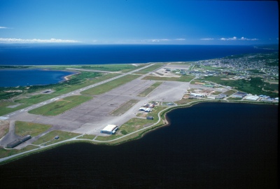

Thank you so much! I definitely have the military mode. It was, according to the photographer I bought it from, parachuted into the ErnstHarmon US Air Force Base at Stephenville, in the Dominion of Newfoundland (now Newfoundland and Labrador, Canada), sometime between 1940-1941. According to that photographer he bought it at auction when the based closed, and used it where he worked Tooton’s Photography in St. John’s Newfoundland, and later at his home.
