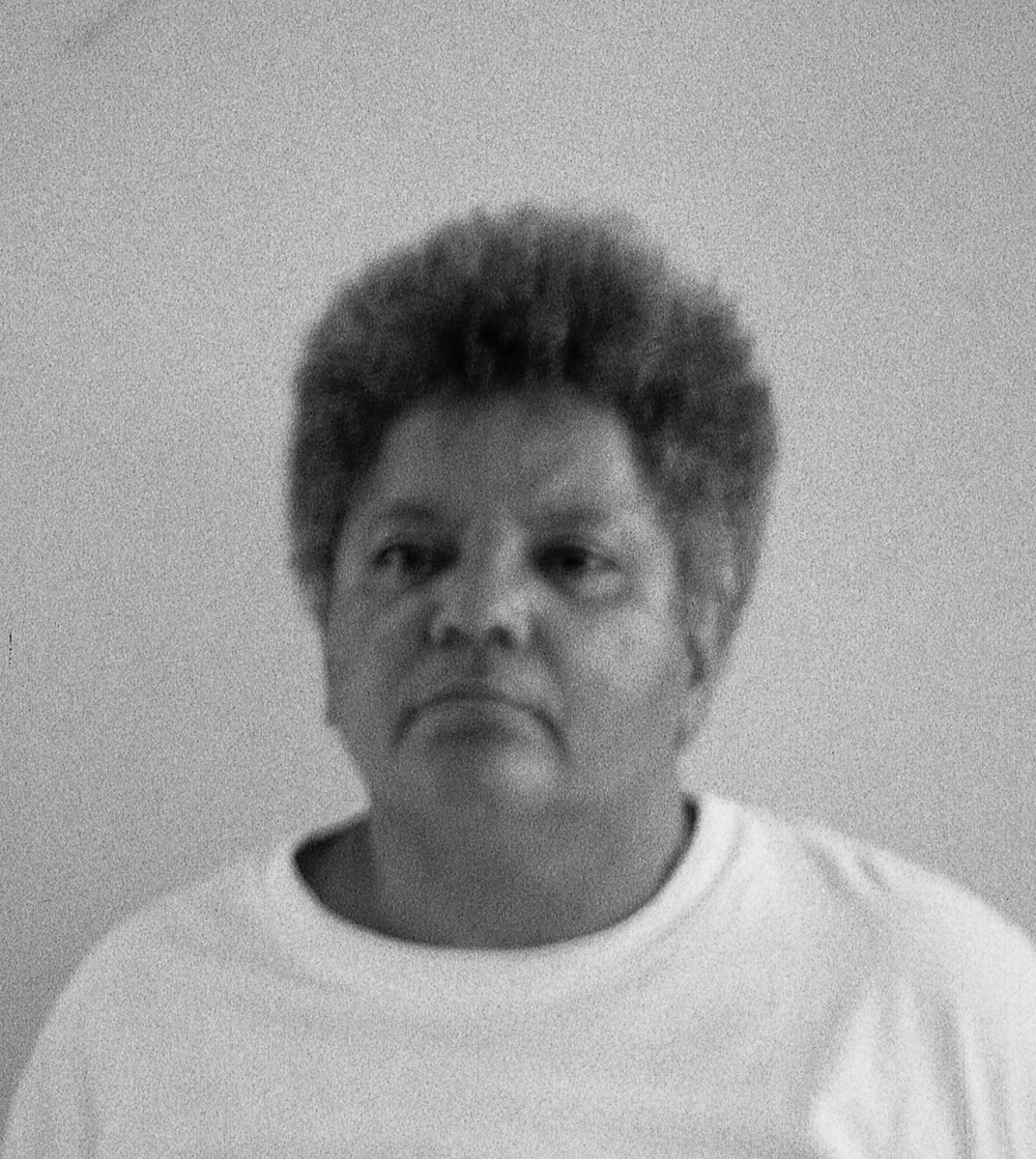

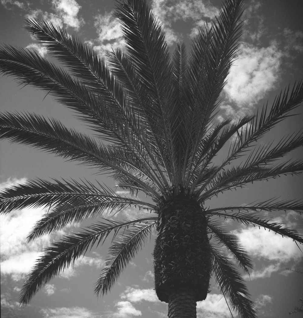

This is Shanghai Pan 100 GP3, developed in Rodinal at 1:25 from a 6x6 camera. It was supposed to be shot at 1/200, but I accidentally had the shutter on B. It's way overexposed. If you ignore the fuzzy image due to camera shake, it's got some interesting grain. But it's Rodinal grain, and I think you can do better. You might like a 135 neg of Tri-X w/ a yellow filter, shot maybe 3-4 stops underexposed, and overdevelop it a little in D76. I say at least 3-4 stops because I often shoot Tri-X at 100 and develop it normally in D76 for a different tonality and still don't get grain issues. You could also try developing Tri-X w/ the 1:1 times, but in 1+1 straight developer. That gives beautiful grain and a nice bite to the image.
The second shot shows what I got on the same roll with better exposure. Big difference. The grain just disappeared.

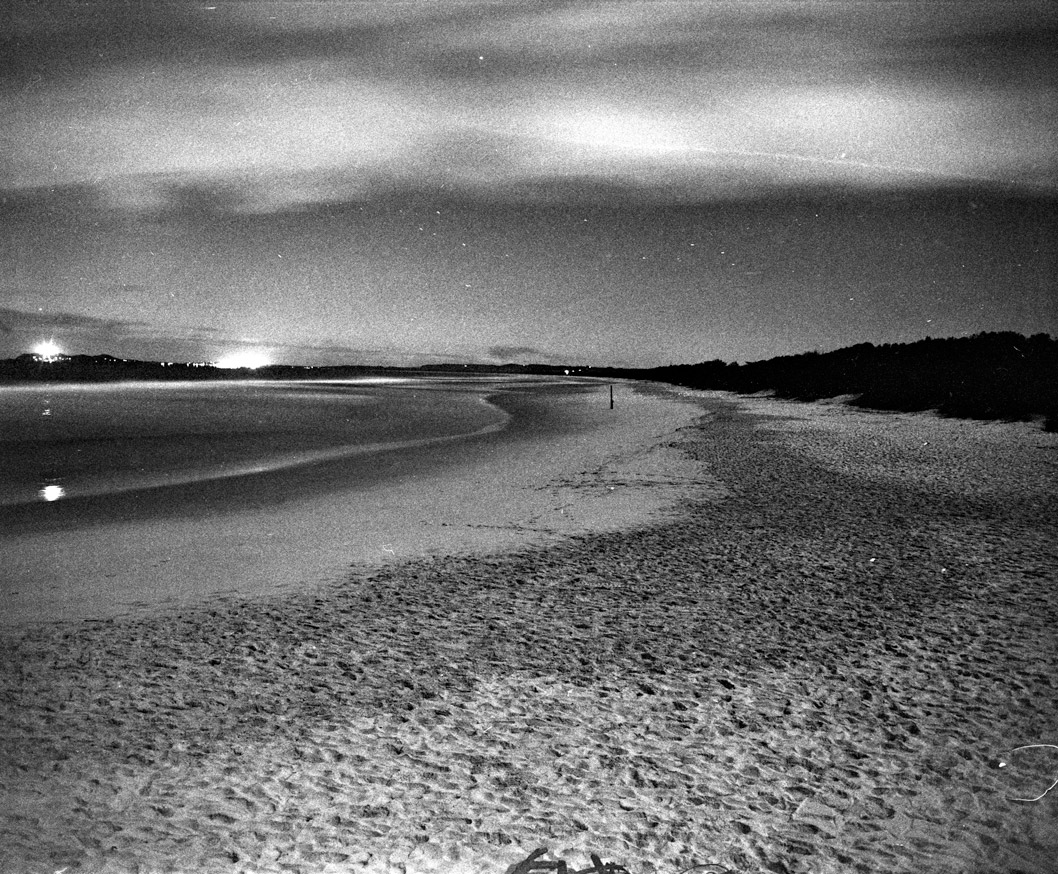

Rodinal 1+100, 2 hour semi-stand with Tri-X at 6400+
6x7cm
Tri-X 51200 Test #1, Beach Night by athiril, on Flickr
It'll be grain as in 35mm
There's also Tri-X in 35mm pushed to 1600 in Rodinal 1+50 with regular agitation, should be very grainy.

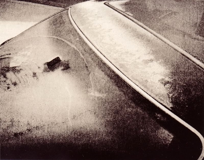

That's nice grain, Atheirll. Smooth and non-intrusive. I'm still looking for intrusive and gritty. I'm getting closer here:
Olympus Pen FT, 70mm f2.0 Zuiko, Fomapan 400, Rodinal 1:50.
And this is what I'm after. This was shot with some old Kodak 2475 Recording film on my Pen FT, 38mm Zuiko. Developed in D76 1:1 I'm trying to duplicate this type of thing, which many would call downright ugly, with modern emulsions and developers. I am getting closer as you can see from the picture above this one, but I've still got a ways to go. I do NOT want to use reticulation, masks, or whatever. I could go to Minox - that might be next. But I'll keep trying. I have very little of this Recording film left.
I do know how to get grain, but the films out now don't do these kinds of things. That's why I asked about the Replenisher. Has anyone gone this route?
To my mind, this type of result suits industrial photography very well. That's what I'll be using it for. Not pretty girls! :D
