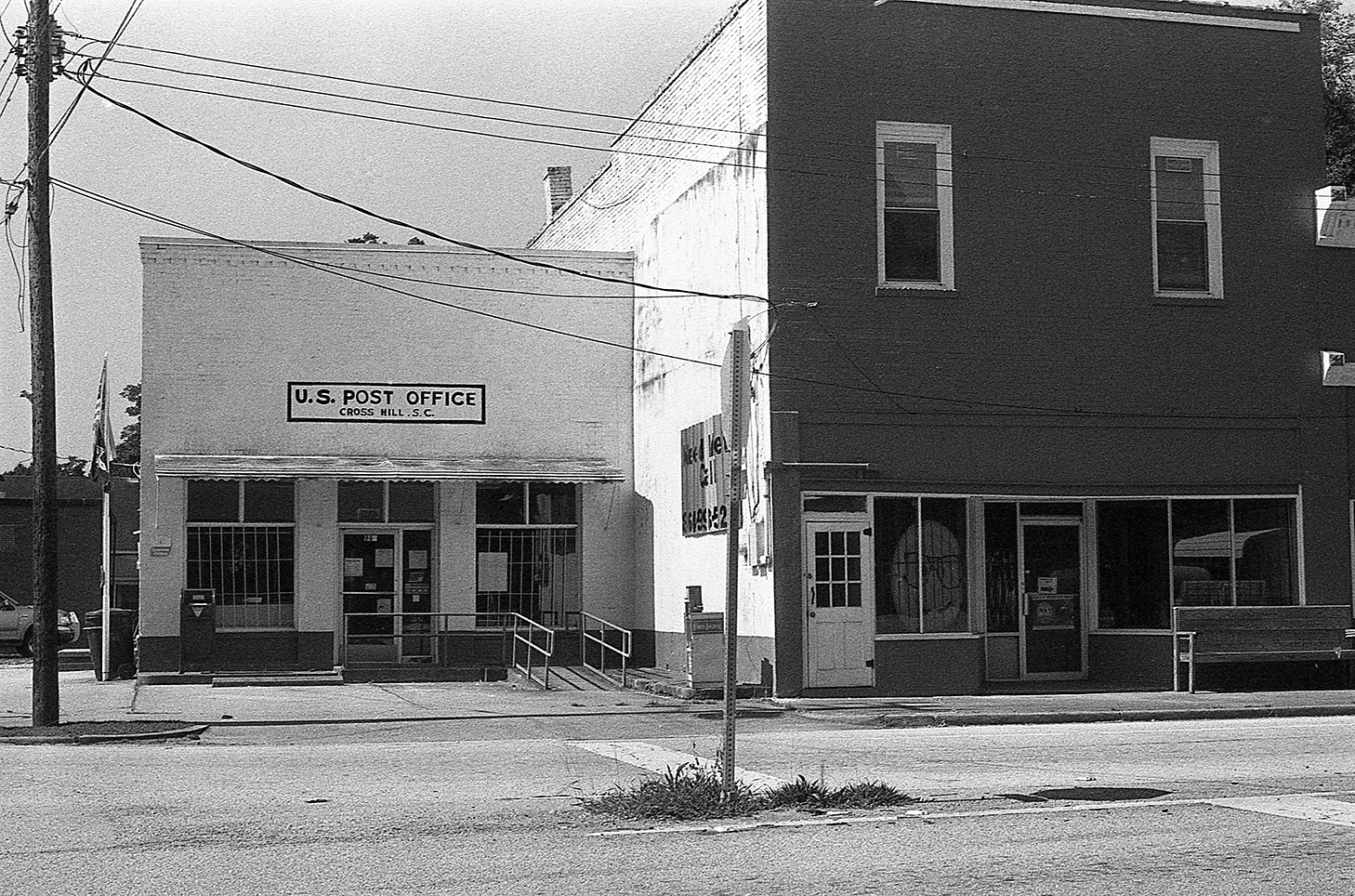

The grain was better with this roll of 135 Arista Edu 400, but... what do you think?

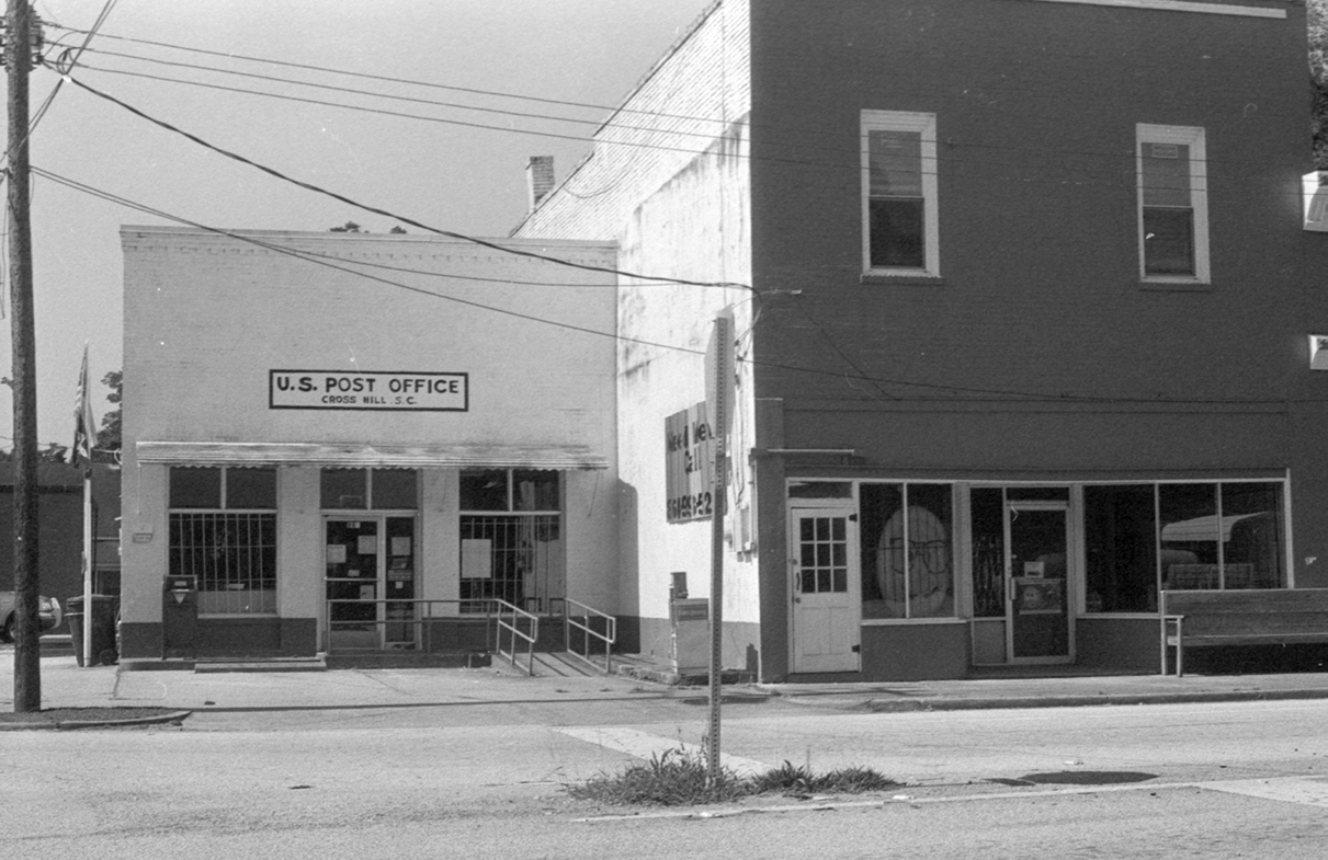

This is Kentmere 400, also developed in Rodinal. I like this grain better. Just need some outdoor shots for comparison.

Really hard for me to judge, I need to see on a wall at viewing distance for size of print. Shadows detail look good, seems sharp.
I think the sample you posted is digitally over-sharpened. It unnaturally exaggerates grain and doesn't really add any detail, and introduces additional artifacts like the halo around the power lines.

The zoom shows a sand like texture, but grain is questionable.l, on this screen
IMO.
No sharpening applied to the first image, just spot and dust removal. I usually turn off the Epson unsharp mask before making a scan, but perhaps I neglected to do that for this image. The "halo" you mentioned is from poor spotting technique, trying to remove dust from that area. Regardless, there certainly is room for improvement with my wet processing, scanning and post processing technique.
My purpose in processing this roll was to determine whether development at proper temperature, with minimal agitation, would improve the appearance of grain, compared to the first roll of Edu 400 I processed back in April. I think the grain structure is better this time around, but it's still too harsh for my liking. I won't know for sure until I can make wet prints from some of these negatives. I've seen some Flickr images of 400 speed 35mm films processed in Rodinal, including Tri-X and HP5+, that look much better than what I'm getting. This film expired eight years ago, which could also be a factor.
The second image was sharpened, BTW.

That’s what you get when scanning with an Epson flatbed. You’ll never see the grain, only this. To see the difference in grain, you’ll have to make wet prints (or use a better scanner).
Regards,
Frank

There’s nothing wrong with grain. I’m just trying to determine why my grain is so prominent and how to make it more pleasing. I’m in the (re)learning phase.
Regards,
Frank
I’m beginning to accept this.

Here's a rescan at 1200 ppi, warts and all. The only adjustment was in the histogram to bring up the mid tones. Looks better to me. I'm thinking the scanner is more of an issue, and wet printing should be ok. The exposure was 1/250 @ f11. The roll was developed in Rodinal 1:50 for 15 minutes at 20C.

Okay, that's much more reasonable. Might have forgotten to disable auto-sharpening in the first scan. I don't think you'll find the grain a major problem up to 8x10 or so.
I scanned again at 6400 ppi and the results are almost identical. It must have been the high(er) solution temps when I processed the first roll that exaggerated the grain. I had no thermometer then!
