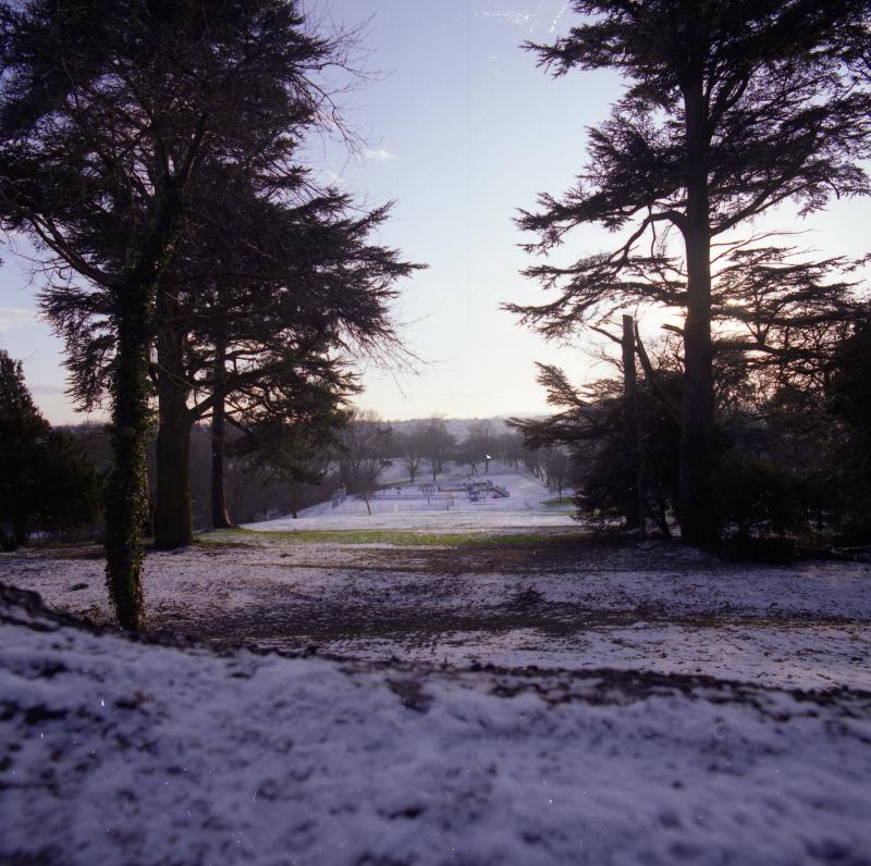

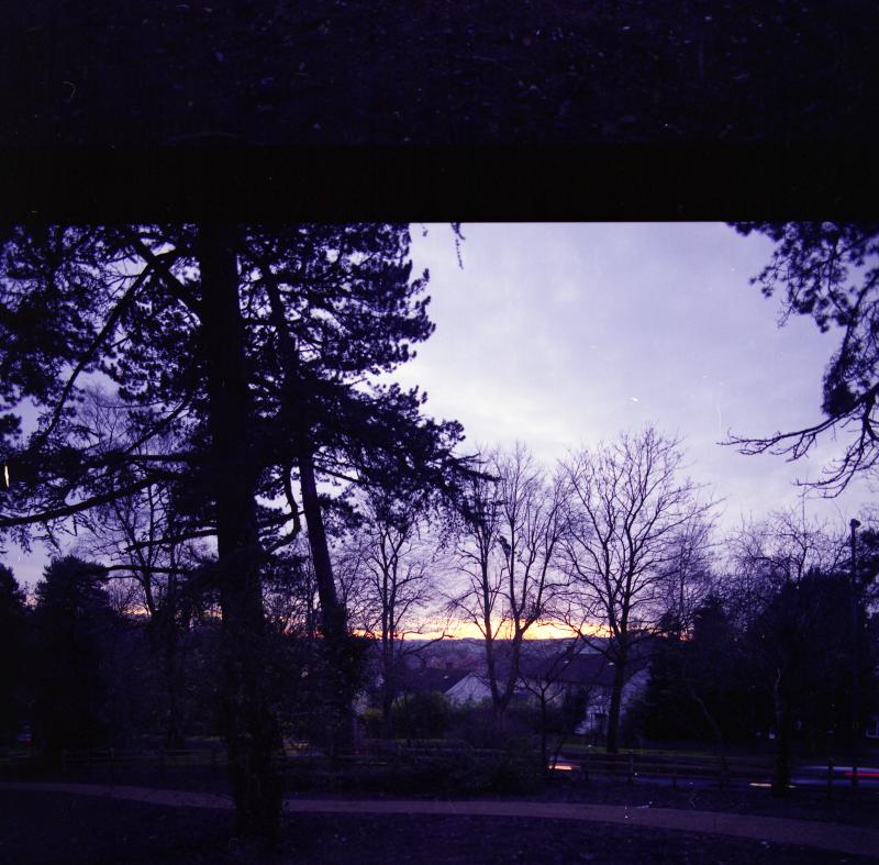

This is an example, it's slightly cropped (but only 1mm or so ), of the framing issue.
This is the first 3 frames, I then left the camera, before returning to it and getting the blank frame issue.
I can't remember the shutter speed of the first shots although it may have been 1/15 or 1/30th. The later shots were all taken at 60th or faster and came out ( when they came out ) properly exposed.
Looks to be the 80mm that's playing up as :-
I am 99% sure was taken with the 40mm.

The framing issue will then probably be due to the shutter in the lens not allowing the rear baffle door shutters to open completely in time. Not an issue with the magazine.
