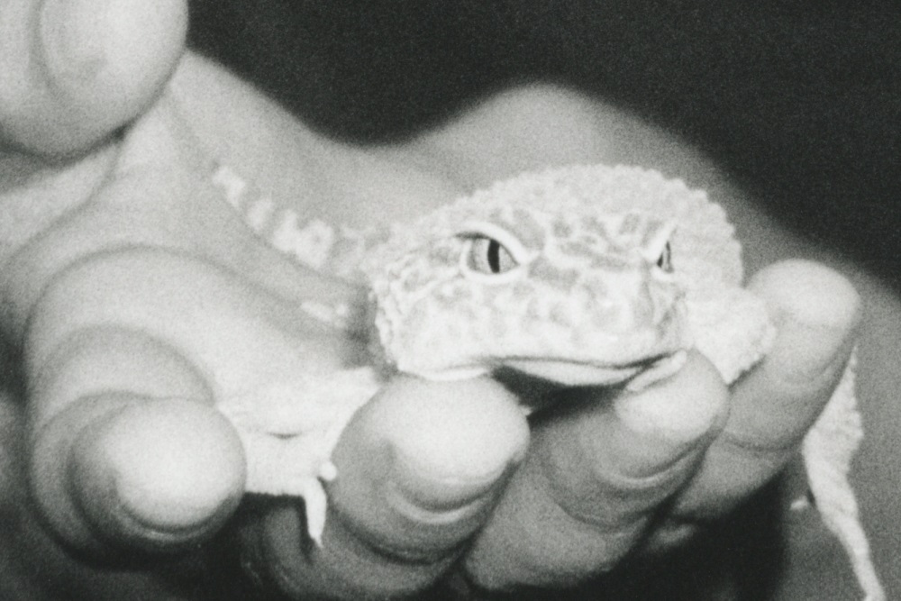

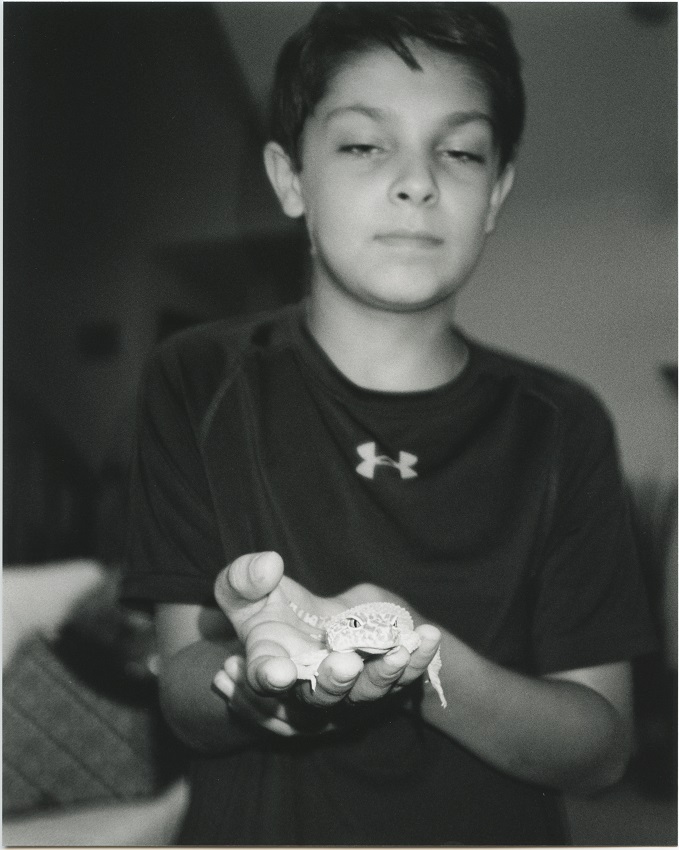

Maybe it's just that I've been printing Acros too long, but I was surprised at the amount of grain I got here. The film is HP5 developed in XTOL 1+1 under constant agitation, 70F for 9:30. The film and developer was fresh and the film shot at box speed (Yashica T5 with camera flash). The print is Ilford MGIV RC Glossy, 8x10. It's not a complaint, really. The grain has a pleasing sort of quality; I like it. It's just more grain than I was expecting. I should add this is my first time printing from this film.
8x10 print
100% crop (400 dpi scan)

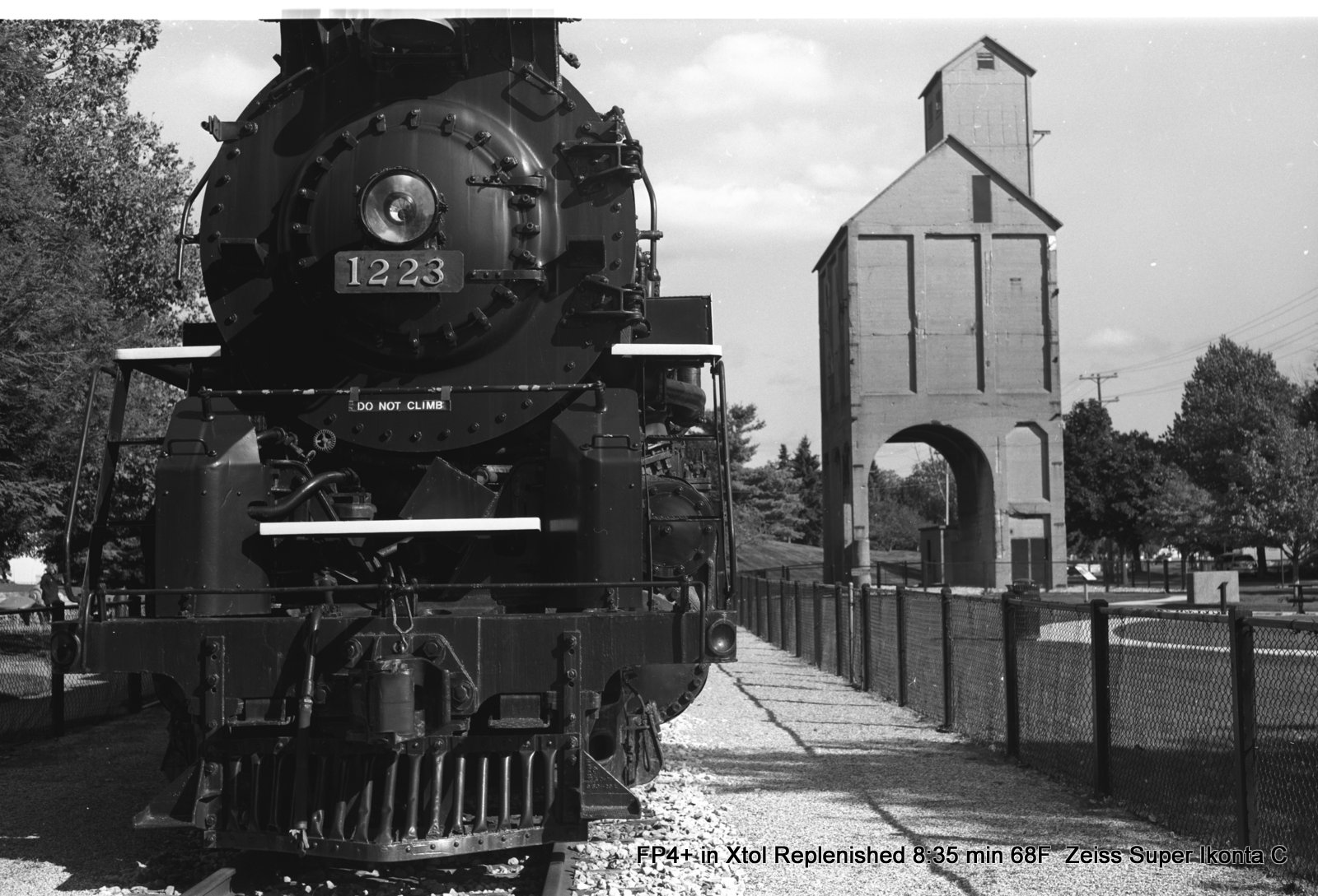

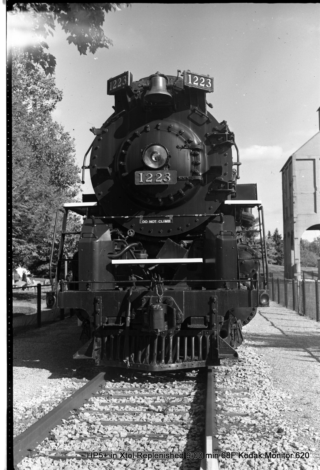

I think you might just be used to Acros also. You're dealing with a much faster and slightly grainier film with HP5+, but it is a very nice and user friendly film. I have been using Xtol replenished and it works very well with HP5+ and FP4+. I also have the same shot on FP4+ if you wish to see the difference in grain between the two.

I agree with you. Mine is from a 120/620 2 1/4" x 3 1/4" negative with the upper being a 100% crop. His looks pretty good for a 35mm size negative as far as grain goes anyway.

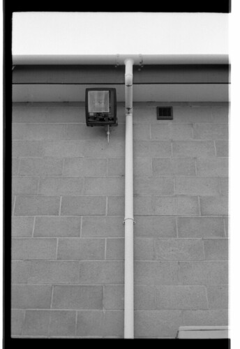

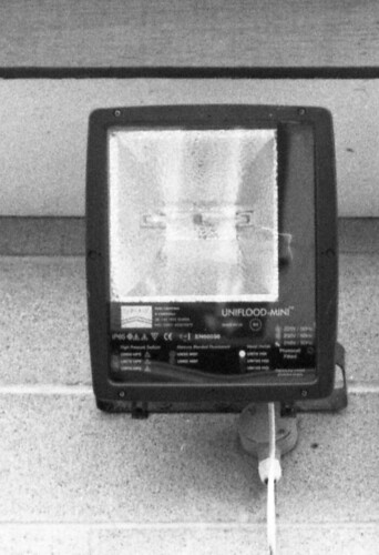

This on FP4+ 8mins (as alluded to above) at full strength, standard intermittent, full frame and crop on a flat bed scanner which without straying too far OT we are told are rubbish at 35mm:

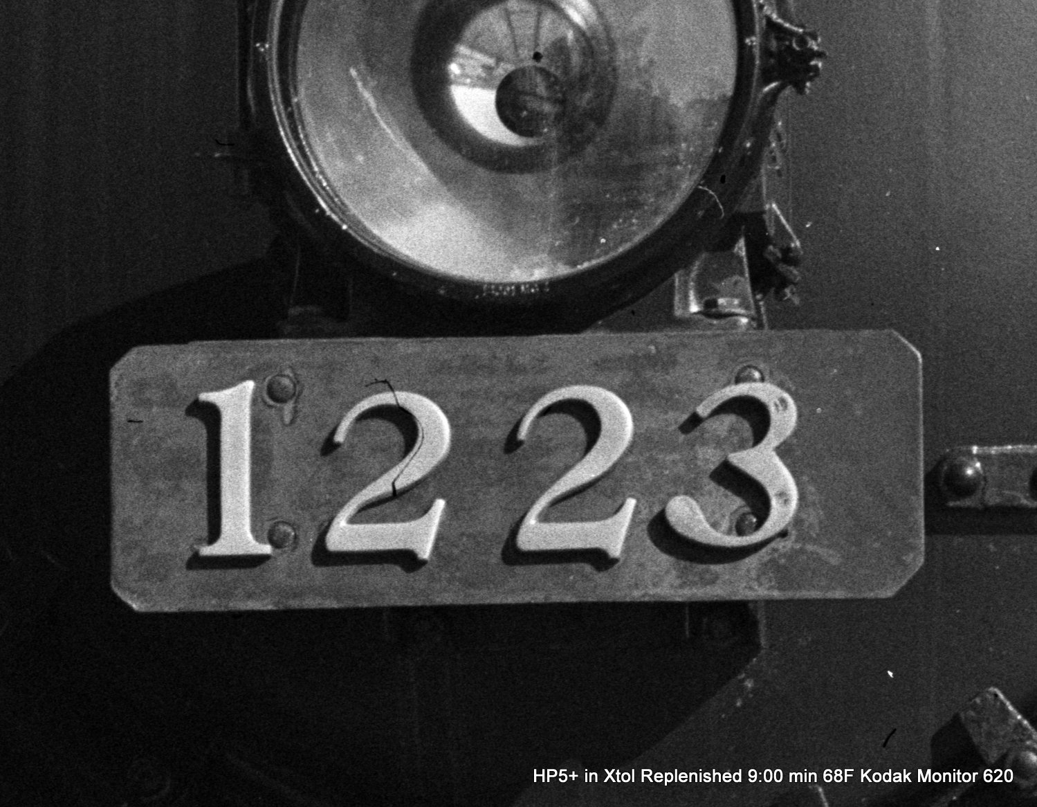

Yes, Acros is one fine film, but HP5+ isn't to shabby for a 400 speed film either. My FP4+ scans from the same shot/subject are a little better in the grain department, but you'd have to be printing pretty darn large to see the HP5+ falling behind. The crop is a 100% of a full frame (2.25x3.25) 4,000DPI scan resulting in 8964x13176 pixels. No sharpening or tweaking except slight curve adjustment. I'm very sure I can wet print or "D" print either of the shots to 16x20 and get very acceptable results. Neither of these shots is for printing since I was just testing my Kodak Monitor 620 out along with a Zeiss Super Ikonta C. Maybe I'll print each out to 13x19 on my Canon printer to see what they look like just for the heck of it.

To be very honest I have never tried it 1:1. I've used it full strength and 1:2 before I settled on the replenishment regime. So far I really like using it replenished, but 1:2 wasn't bad either as far as sharpness goes. When I get done testing out FP4+ and HP5+ I'm going to try both Delta 100 and 400 to see what they look like. So far I like HP5+ actually better than FP4+ in Xtol-R.

Here is a comparison of FP4+ and HP5+ at 100%. Only difference is that the FP4+ was shot with a Zeiss coated lens and HP5+ with a Kodak uncoated lens of near the same vintage. Pere Marquette Zeiss-001.jpg Pere Marquette HP5 monitor.jpg Pere Marquette Zeiss-002.jpg

I realize that my examples are from two different cameras, but both are very capable in the lens department. Still, to me it looks like the HP5+ shot is sharper than the FP4+ shot. HP5+ doesn't seem to have as smooth a grain structure as the FP4+ shot, but it just looks sharper to me. Barry Thornton mentions this fine grain vs coarser grain thing in his book "Edge of Darkness" and has examples there also. So, I'm changing my attitude about grain being bad to grain being pretty darn good as long as it doesn't interfere with what you are trying to convey. If I didn't like grain I'd be using XP2 film, but I've come to like it instead.
