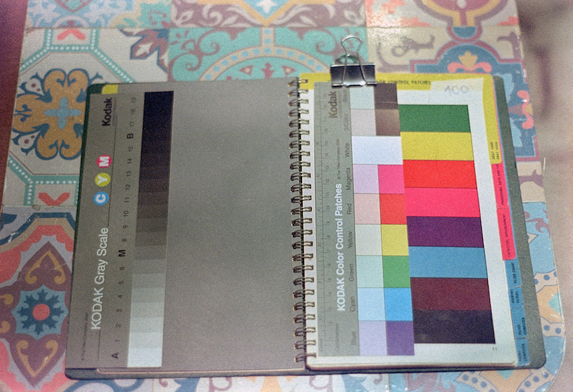

Hi!
This is a comparison of very expired and a bit fogged Vision2 (I won't use my good film for this kind of experiments) developed in C41 al various dilutions (stock, 1+1, 1+3). The developer is flexicolor lorr lu used as one shot without developer starter (just developer + water) To my eye the one developed as 1+1 looks perfectly ok, that means if I use 200 ml of mix in a rotary tank I can get 13 roll per liter of "replenisher" as kodak calls it.
STOCK
1+1
1+3
Compared

The idea here was to compare the developer for crossover or and other problems
I understand. That's why I asked about the contrast. Crossover tends to be limited in a scene brightness range that's limited to 1.5 or 2 stops to begin with. Try something like 5 stops at least to get some more solid information.
Btw, the difference in overall density and gamma seems so massive that I'd start by seriously increasing development on the higher dilutions. It looks like those negatives are very underdeveloped as it is.
Rafael Saffirio
May 13, 2020
61
Santiago, Chile
yes 1+3 is very under development, I'll settle with the 1+1, for me is a good compromise to get more from my chemistry.
This looks promising. I would love to see fresh C-41 film developed in stock and 1+1 dilution and compared side-by-side. Is it possible to get the same negative density out of 1+1 dilution? I expect the answer is 'Yes' since we are not even close to exhausting the developer at this concentration. You development time adjustments look insufficient. Tetenal recommends increasing development time from 8 min (fresh) to 11 min (13-16 films) as the developer gets exhausted. You can use a simple snip test to adjust the development time.
Is there any noticeable difference in grain?
What are the pros and cons of diluting the developer and using it one shot compared to re-using/replenishing?
Rafael Saffirio
May 13, 2020
61
Santiago, Chile
For me is that if it is one shot it can be used in a rotary tank (you can't re use developer used in the rotary because it oxidices too much too quickly) Also, but I have no proof for this, I think that the developer will keep better if it is at "replenisher concetration", and last but no least in my case al always forgot if the last time that I used the developer did the replenisment or not and to make things worse the last time that I did it I confuced the bottles and replenished with something that didn't had a label but I believe it was fixer or something acid because it killed the developer 😭
Tetenal recommends 8 minutes for C-41????
I can't tell you about the grain because this film has a dense base fog that makes everything look grainy. but the stock an 1+1 looks equally grainy to me
