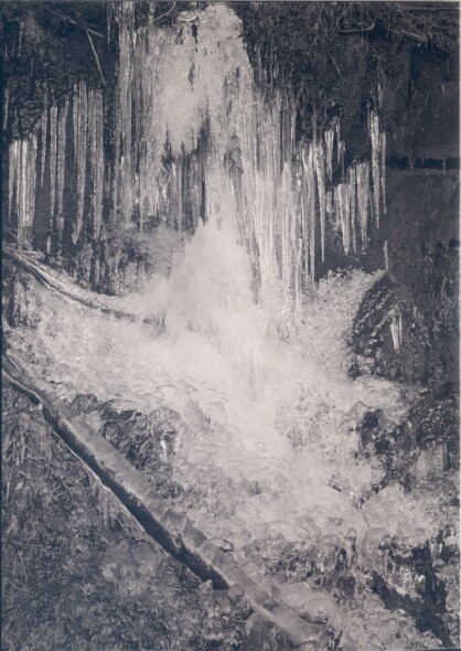

The QC must have been good on the Slavich plates I've used so far.
This one was exposed with a Heliar 150mm f:4.5 on a Voigtländer Bergheil 9x12cm, developed for "3 1/2 Gymnopedies" in Pyrocat HC 1:1:100, and printed on POP:
