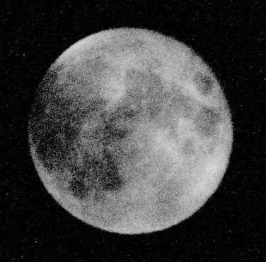

A few of the pictures from the film. No keepers. I am forced to use a tripod...

Flotsam
Sep 30, 2002
3,221
S.E. New Yor
Looks kind of grainy.
What developer did you use :D
mikeb_z5
Feb 11, 2004
217
Amazing! I think if you kept the shutter open a little longer the moon may have spelled "modafoto"! Without the quotes of course(that would just be ridiculous :smile: )
Mike
Ole
Sep 9, 2002
9,244
Bergen, Norway
Mike
And dropping one picture and rearranging the others (15,9,10,13) spells MOON...
jss
Jun 7, 2004
200
San Francisc
don't think i've ever seen "moonpainting" done before. :smile:

Two suggestions, Morten: longer lens, sturdy tripod.
Dead Link Removed
You'll get about 1mm of moon for every 100mm of lens, so a 300mm lens is stretching the enlargement capability of even a Rodinal-developed shot. ;-)

Hmmm...I don't have the money for a super tele....but I have fallen in love with the 1200 mm from Canon...

You might try connecting with a group of astronomy enthusiasts near you, Morten, and see if you could arrange to borrow/rent one of their telescopes, or just get some shots by attending one of their sky-watch sessions. All you'd probably need to buy would be a T-adapter for your camera (Canon and Nikon are common).
The 8" Celestron, for example, is about 2000mm, producing a moon image of about 20mm on film (any format, so 35mm film is fine). As a tele lens, it's not as sharp as one might hope, but it's better than trying to enlarge a smaller image too much.
