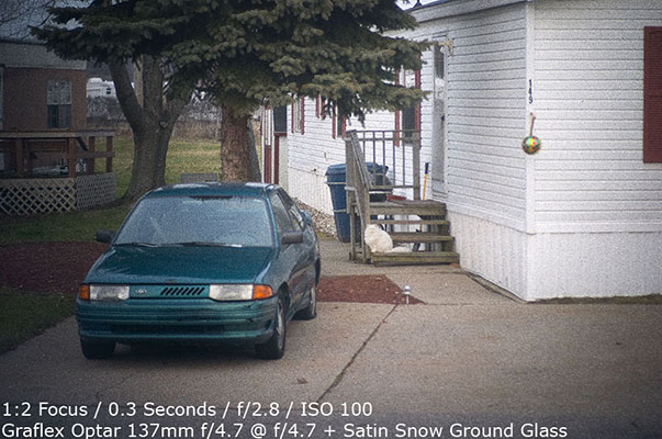

And like the bastard I am I have to immediately install it, and immediately brag about it. And even though I have not gone out and shoot just yet, I decided to set it up on a dresser in the bay window room, and set my digital camera up on a tripod with my 1:1 macro lens behind it and try to get some shots off the ground glass itself resulting in the two samples (if you view the image as it would be 1:2 life size to 35mm, it'll seem a lot clearer lol), click to enlarge to the full 6.3Mpixel size.
I must say tho, when viewing even indoors it's remarkably bright even with my f/4.7 optar. I'm just debating putting the Fresnel on the back of it, or leave it as is, need to try it out some more but I'd say for outdoor Fresnel wouldn't be needed at all, probably just indoor lighting condition. Anyways I'll update when I get chance to play more with it, perhaps tomorrow.
