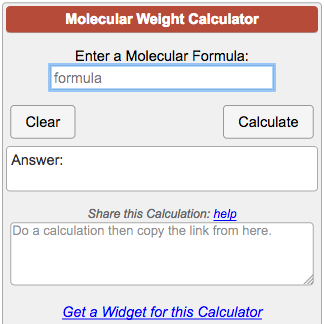

One can certainly use a spreadsheet to calculate formula (molecular) weights as mentioned above.
However, sometimes it is easier to let someone else do the 'programming'...
There are many other similar on-line calculators out there. This just happens to be the one I have bookmarked.
Once you have formula weights for the compounds you are interested in then it is all a matter of ratios.
