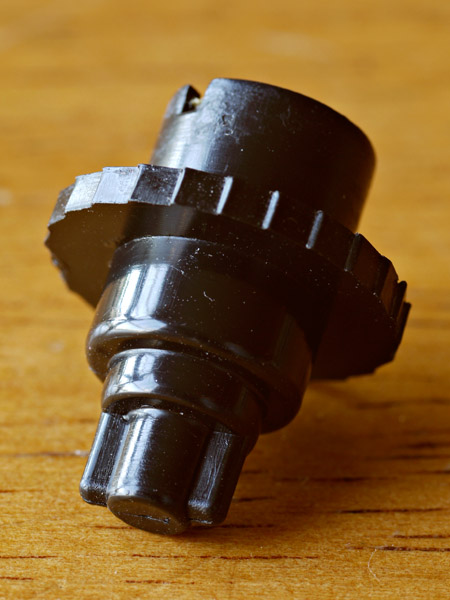

The kind of casting I am talking would preferably start with an existing part. And, as a matter of fact something like a plastic winding knob is actually a good example. The plastic piece shown below is another example (extra credit if you know what camera it comes from!). It is kind of a long story to explain exactly what I want to do with it, but in short I want to make a piece which basically duplicates the lower portion of it (not the "gear" part).
Jeff

Jeff, that very part you are showing could quite easily done witout CAD/CAM from Aluminium just by turning the cylindrical part on the lath, slitting it on a mill and inserting a cut or milled part.
Fix the latter by bolting or by epoxy-cementing and curing.
Thanks AgX. I appreciate that it could be done that way but for several reasons it is not what I am interested in. For one I don't have a lathe. And as I indicated before I was really only interested in creating a small part which duplicated the tip of that piece. Lastly I really wanted a plastic piece. That is more in character with the cheap and/or old cameras that I seem to be obsessed with these days. :smile:
