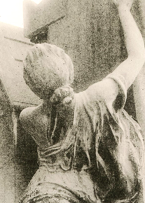

And in terms of "peppering", I've only had that occur in one type of paper (the Fujibro -- there's an example in my gallery). What I thought was peppering with Ilford WT was not -- as explained by both Tim Rudman and Wolfgang Moersch in a (there was a url link here which no longer exists) I made a while ago. There still may be examples of peppering in the (there was a url link here which no longer exists) somewhere from that initial query.
EDIT: There is, just added the links, and a crop from the Fujibro that showed peppering. Unfortunately I removed the other photo of the print I made on Ilford WT and no longer have access to the scanned file.

Yes, that's a good thread. It is good to know the difference between pepper fogging and the inherent lith grain - something being peppery can relate to two different things in the case of lith. I am thinking of pepper fogging as more of black spots erupting randomly, rather than a more general grain. I think the black spots is what I see in your Fujibro example?
