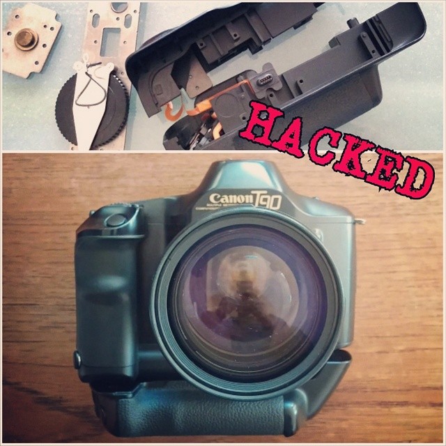

Thanks for all the replies and advice. Just thought I would follow this up...
Once I looked at everything I saw there's no way to make the grip work without cutting up the camera body. That was not going to happen so I just modified the grip so it would fit on the T90. No buttons or controls work, but what I mainly wanted was some more height in the actual camera. It doesn't seem quite as tall as the 1D series cameras as I remember, but it's much better now.
HACKED by mugget, on Flickr
It fits pretty neat, just a bit of a gap on the right hand side there.
Having the portrait shutter button would have been cool, but no big loss. I probably wouldn't have even used it anyway. I only use the grip with the 85-300mm lens, I take it off the camera the rest of the time.
Hopefully this will give some ideas to people who are having trouble holding the T90 in the "shoulder mount" type position.
