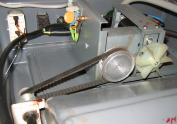

Hello every one,
first time posting here so I hope I'm on the correct page.
To make it short I would like to modify an ilford CAP40 to RA-4 but I can't find the parts needed for the conversion on european sites.
Any one here has gone through that process and still has the links to the parts?
I'm looking for:
Also if anyone has a video of someone modifying theirs I would greatly appreciate.
Thanks in advance

The links don't work for me for some reason, but these appear to be the pulley gears:
https://www.servocity.com/11-55t-3-8-wide-xl-timing-belt/ (different seller, but item description seems to match).
I know I bought the parts for my Durst RCP20 conversion at Conrad. They have a selection of such items; you may want to check them out. Have a look here: https://www.conrad.com/en/o/toothed-belt-discs-v-belt-pulleys-1210042.html
ilford CAP40
Is this one of the Thermaphot-produced machines, like the Durst RCP series? It looks very, very familiar, going by the one or two photos I can find of the innards.
The fan, belt and gears look the same as the ones in my RCP20.

I converted one of the little Durst RCP-20 machines like what's pictured by Koraks, I bought toothed pulleys and belts from automationdirect.com
Fun project. Complete waste of time. Still it's fun playing with these old beasts.

Even if it's still a thermaphot based machine, the CAP40 inside is a bit different than korak's photo of the RCP.
The space wheree is located the motor and belt is way tighter than the RCP. I openened up a CAP40 in the hope
to complete the modification. I gave up when I found a more compact thermaphot...
