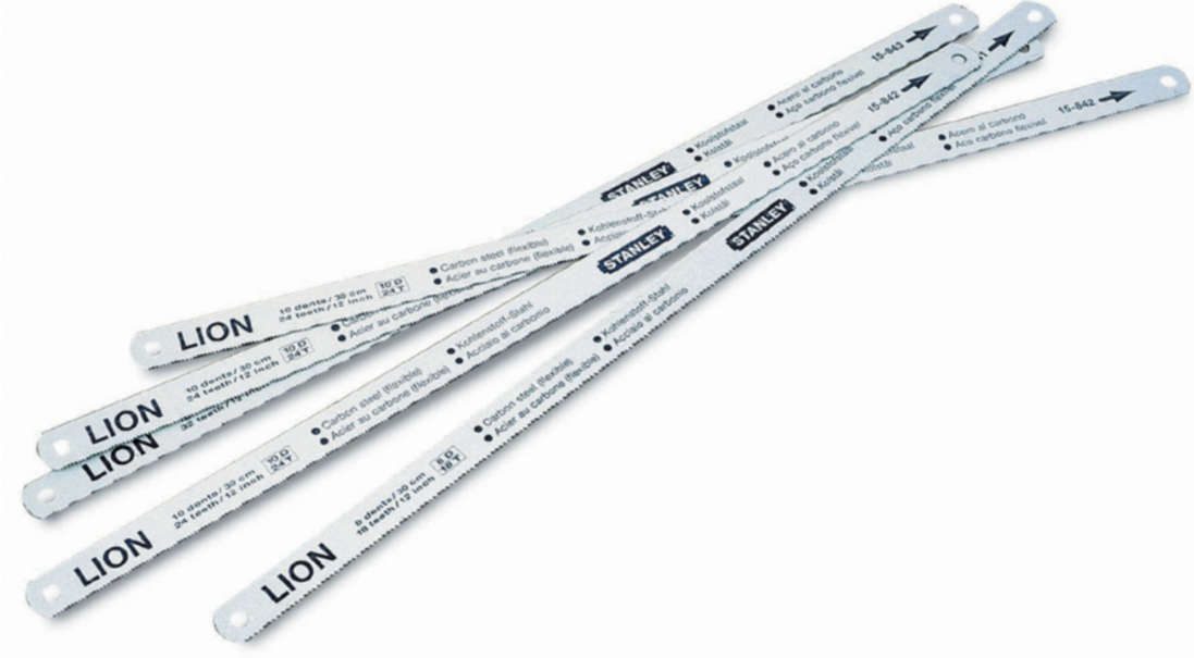

If the circle for 6x6 is not usable for 6x7 (because of to be too small)
you may have the need of this fine tool :
That sounds a bit unusual (but why not)...."HSS quality recomanded"!
Perhaps it is not enough (think of the light) - then there must be a way to higher the distance to the light source a bit! You should care about the centric of light at the end of you DIY 6x7
enlarger transfer!
