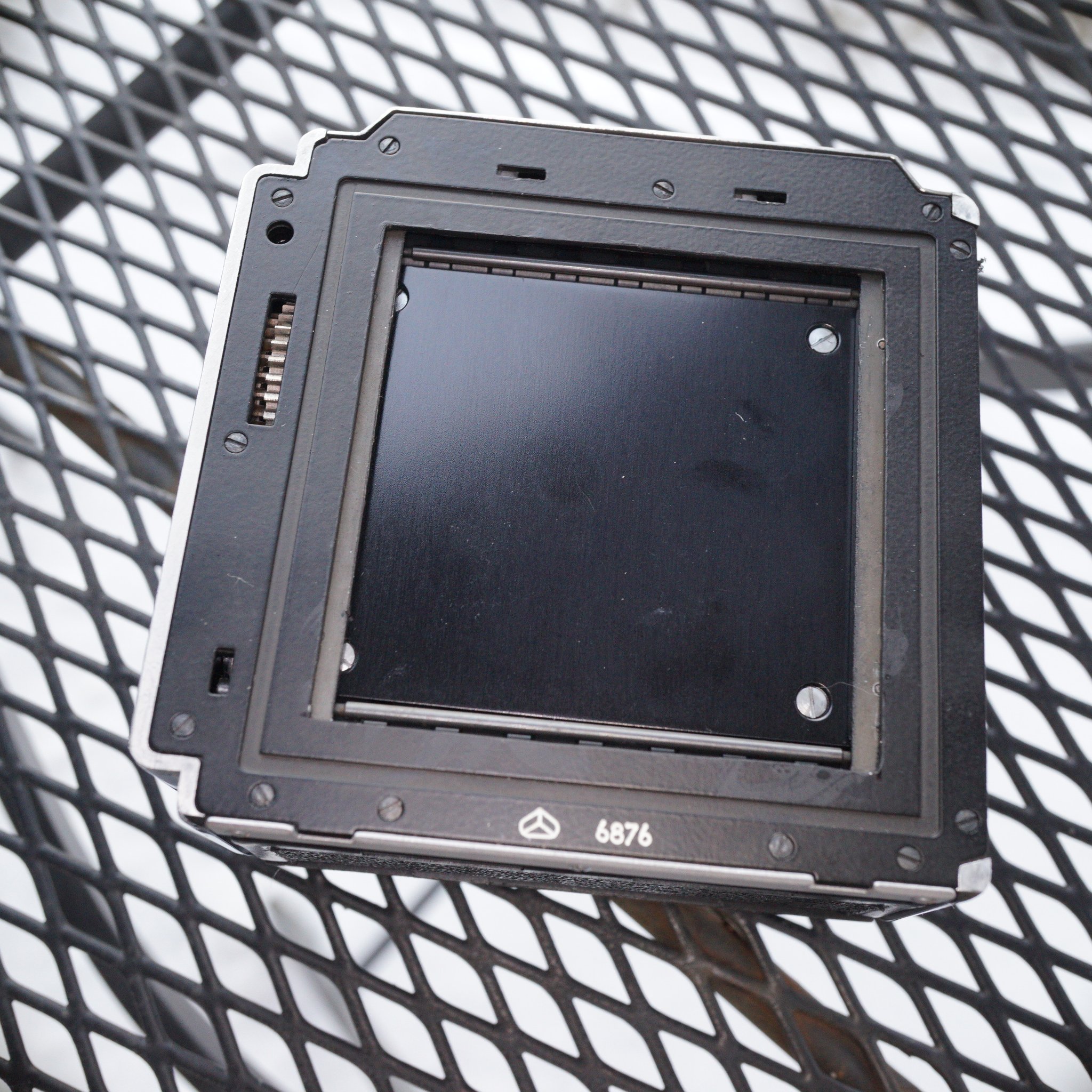

Its a relatively easy modification if you are reasonably good with tools. Stock Kiev film backs do not fit on a Hasselblad because the opening is too small. You just have to enlarge the opening by a little over 1mm, and that’s it (in theory!). The plate comes off with 12 screws (or 10 if you have an old one), you just have to be careful with the springs and sliders that jump out when the plate is lifted off. Then it’s pretty easy to trim and check that it fits a Hasselblad before reinstalling it.

I removed the plate, used a nibbler tool to widen the opening by ~1.2mm, and used a finish file to clean up the opening. I tested the plate on a Hasselblad back, and when I was satisfied, I added flat black paint to the filed surfaces.
I then repaired the NT back, removed lock mechanism all together, and left the multiple exposure disabled. I also adjusted the film rollers, and tweaked the springs and the latch used to attach the back so it would properly sit snug on the Hasselblad (stock, it was loose). These types of adjustment are required on a Kiev 88 as well. I also checked the film advance mechanism, but surprisingly it seems to be fine.

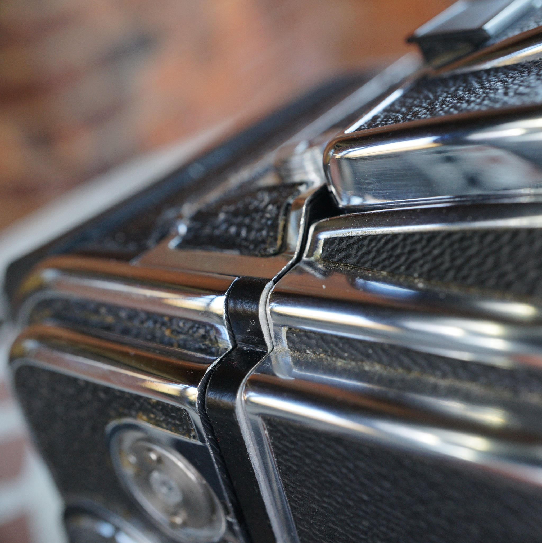

The Kiev bodies are about 1mm wider than the Hasselblads, so the back sticks out a tiny bit on the right side.
Fit between Kiev NT back and Hasselblad body
The leatherette is courser, as is the finish, and the gears are not as smooth. The dark side light seal is different, so you have to modify the Hasselblad replacements. Dark-slides are also narrower, so you cannot interchange them with Hasselblads.
