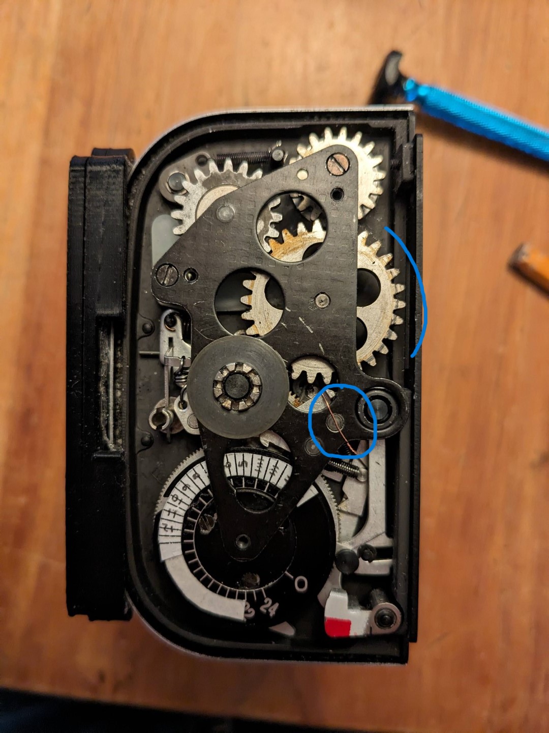

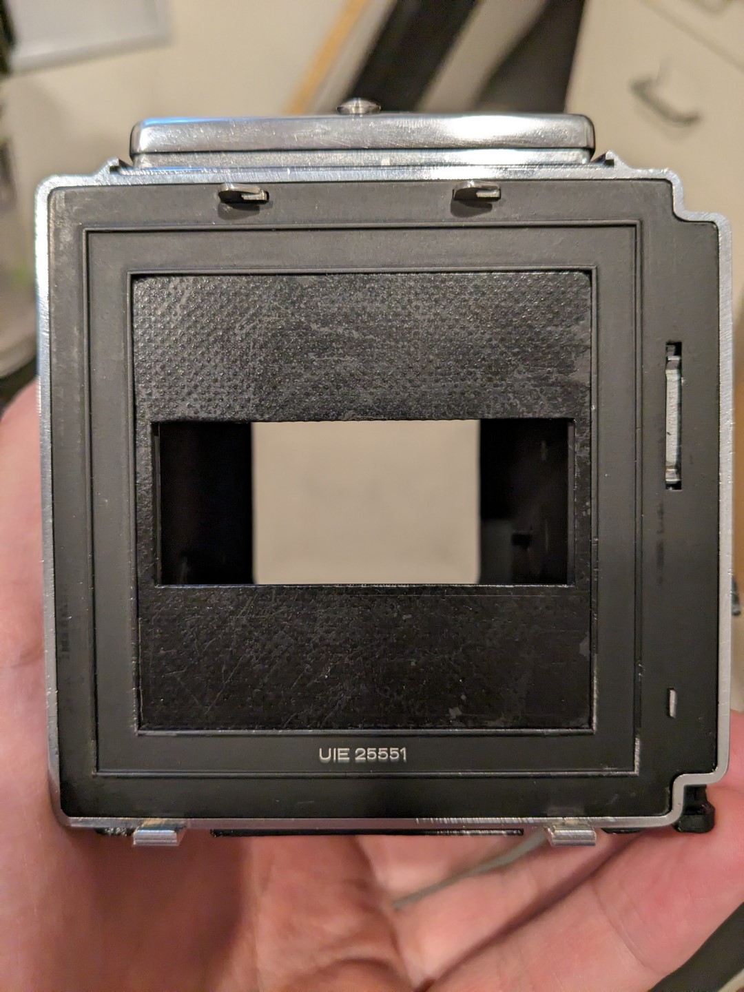

Did something similar for the Hasselblad SLR. Modified slightly the film back (removed the gear coupling to the body, disabled the auto stop at frame #1, put half-frame marks on the counter), and made a mask for the frame just behind the auxiliary shutter. You can switch format on the go using the dark slide.
PS. I was able to fix the light leak.

WOW this is so cool! I would love to learn more - did you document your process? What frame size did you get in the end?
Here's how I did it. Removed the gear and put a spacer. Attached the spring-loaded notched arm with a piece of copper wire. Added half frame marks on the counter (you need to eyeball it to the reference dot). The mask snaps on the body, 22x55mm size. Hasselblad manufactured a similar "6x3" mask.
