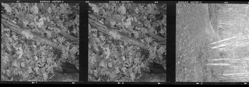

Kodak puts 1-12 on one side of the rebate - spaced to match 6x6 cameras - and 41-55 on the other side - spaced to match 15 exposure 6x4.5 cameras and of some use with 6x9 cameras.
An example that shows the numbers on a 6x6 strip:
I don't know that I have a scanned example with rebate numbers fron a roll of 6x4.5.

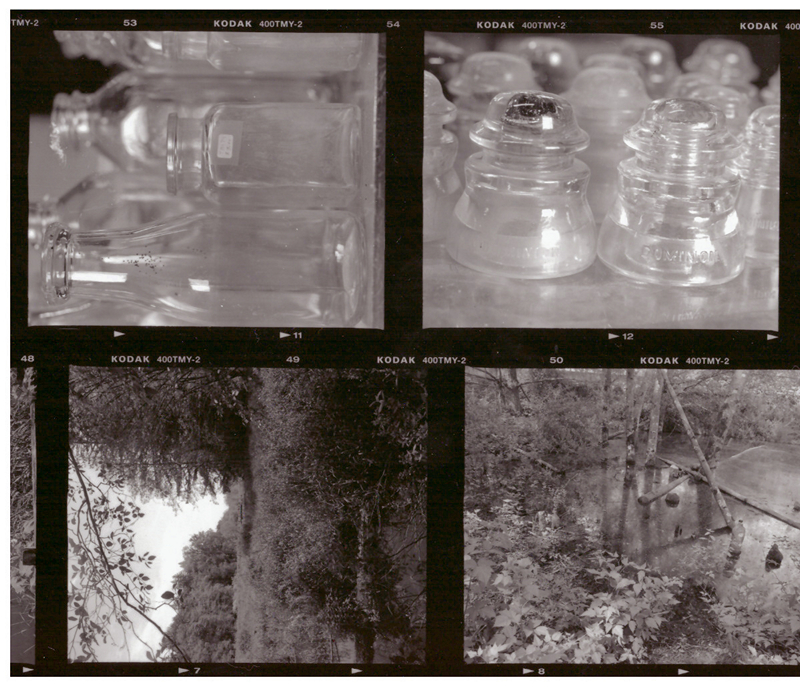

And here is an example with 6x7 negatives - that don't match the spacing at all!
