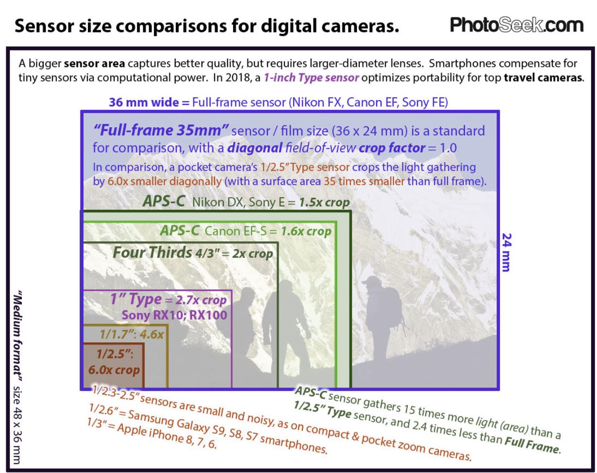

Now no nothing about digital, what do you mean when you say its a crop sensor?
No controls on a Nikon lens is an E series, think electronic control. It will function at full aperture only on your F2 and may vignette. if for DX (APS C).

By "crop sensor" he means that the sensor area is cropped compared to 24x36mm, or, with other words, just smaller....
The sensor on the camera is not 24mm x 36mm, but rather APS-C size - 25.1mm x 16.7mm.
So if the lenses were designed for that smaller size - Nikon refers to them as DX - then they won't cover your full frame of film, and won't mount (I believe) on your film camera.
Unless you have one of the very few APS-C size film cameras that were sold before that film size was discontinued.
This information is wrong with his crap factor equals zero it should say the crabshack sure equals one!
Likely you misread something. At that table I see the crop factor for 24x36mm format given as 1.0 thus 1.
But yes, other than in this case, people often have difficulties with factors. Which might lead some to say zero, when there is no difference, but indeed should say one instead.
