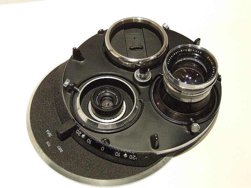

Lachlan Young
Dec 2, 2005
4,957
Glasgow
Hi.
Interesting lens holder, does it have a name?
Does it allow for off center enlarging? that would be handy when cropping.
Durst TRIPLA, fits in place of the massive UNIPLA on the 138, 184 etc. Lets you switch formats very fast or to a longer lens if you need greater working height. No to your question about off centre. Large format enlarger & glass carrier are the answers to your question instead.

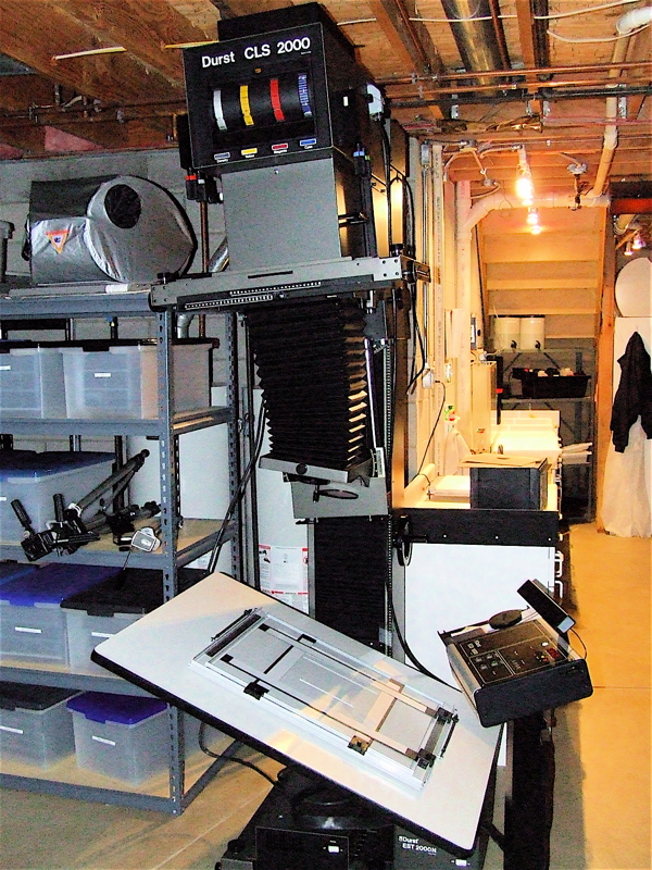

When using the tilt function for perspective control, the assembly can be rotated slightly (per the indicator marks) to re-center the lens. My L1840, actually has a shift lensboard to do this, but not all the Durst enlargers had the shift function to re-center the lens. (I have the 'deluxe' version, so I can also shift the 8x10 negative 12 cm each.)

Actually, with 8x10 it may be just as frequent to have lenses that won't allow movements!
Symmar-S 210mm (image circle 294mm) on 8x10 with a 'fake' extreme rise. This is the print from enlarger settings pictured above. As an interesting fact, any light falloff at the top of the image during negative exposure is counteracted by light falloff during printing (being farther from the enlarger lens), so the exposure of the sky becomes surprisingly even.
