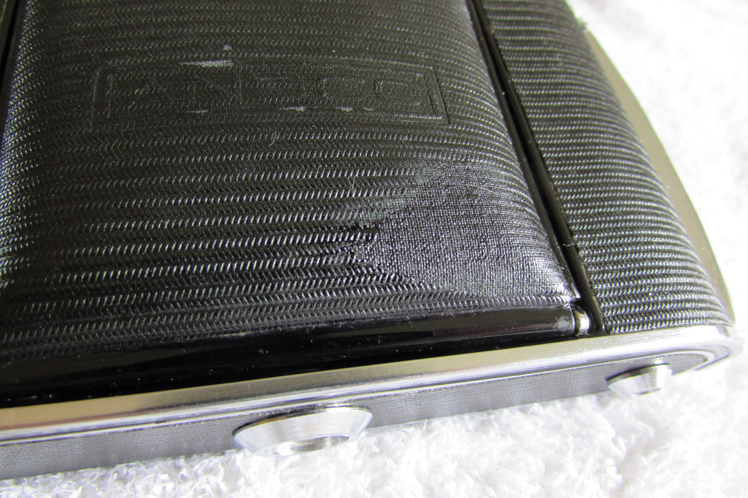

A while back I acquired a nice Mamiya 6 V with the Olympus D.Zuiko 75mm f3.5 lens. Other than being a bit dusty the camera was in quite good condition. The only blemish I found was a scuffing of the covering on the lens cover and a lifting of a couple of corners of the covering on the front of the camera. The scuff lifted the top layer of the covering, leaving a flap of fiberous material that looked like some sort of paper product rather than leather or leatherette. Were these cameras covered with a paper material that had a glossy embossed top layer?
Since it appeared to be paper, I hit upon the idea of using model airplane dope to re-cement the loose flap and to cover and seal the blemish. I bought some clear butyrate dope and thinner and made up a small batch and brushed it onto the covering at the scuff and, voila! It re-cemented the covering and sealed the loose flap quite nicely. I also used the clear dope to re-cement the lifting corners of the covering and it worked wonderfully!
This worked so well on the Mamiya that I also used some black butyrate dope to cover a blemish on the lens cover of an Ansco Speedex recently purchased at the online auction site. Something had been spilled on the camera box and had leaked through onto the lens cover and basically dissolved the plastic coating on the covering material. The fabric weave was showing through and looked quite unsightly. I used the black model airplane butyrate dope to paint over the blemish and it covered it well. A couple more coats and it the blemish should be almost invisible.

In my model airplane building days, I painted the outside edges of the balsa frame with dope, let it dry, then laid on the tissue or silkspan covering and brushed fresh dope on top where it met the framework. This technique would soften the dope on the framework and bond the covering to the structure. So, I'm guessing that if you do use the dope as a cement, then using thinner later on by working it under an edge would soften the dried dope and allow lifting the covering. I think it would be a time consuming affair though as you would have to work from the edges inward. There wasn't enough loose covering on my camera for me to lift and examine it closely - I still think it is something besides leather.
On this camera I used a very small amount of Propert's All Purpose Cleaner and Conditioner on a microfiber cloth to clean the covering on my Mamiya 6. The bottle says it's a Kiwi Brands product made for cleaning leathers, imitation leathers, and plastics. I've had my bottle for ages and it's almost gone, but I can't find where it's still available. I would think any high quality wax product, like carnuaba would be a good protectant for this camera's covering. Thanks for the tip on the PEC pads.
