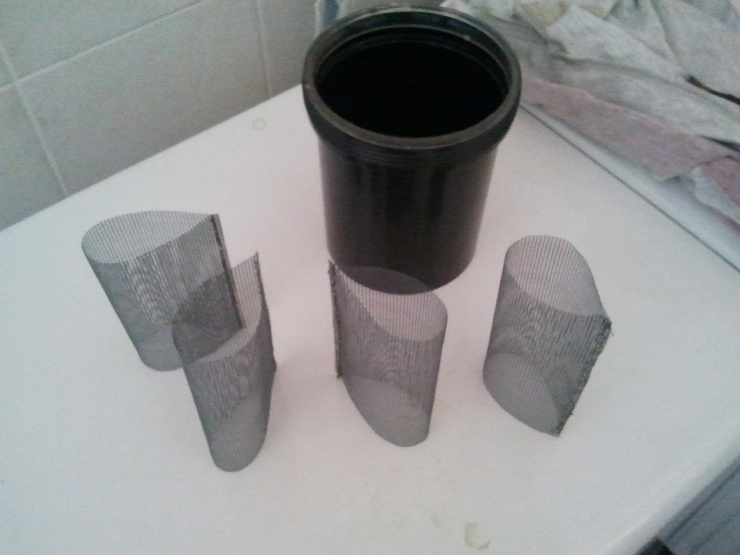

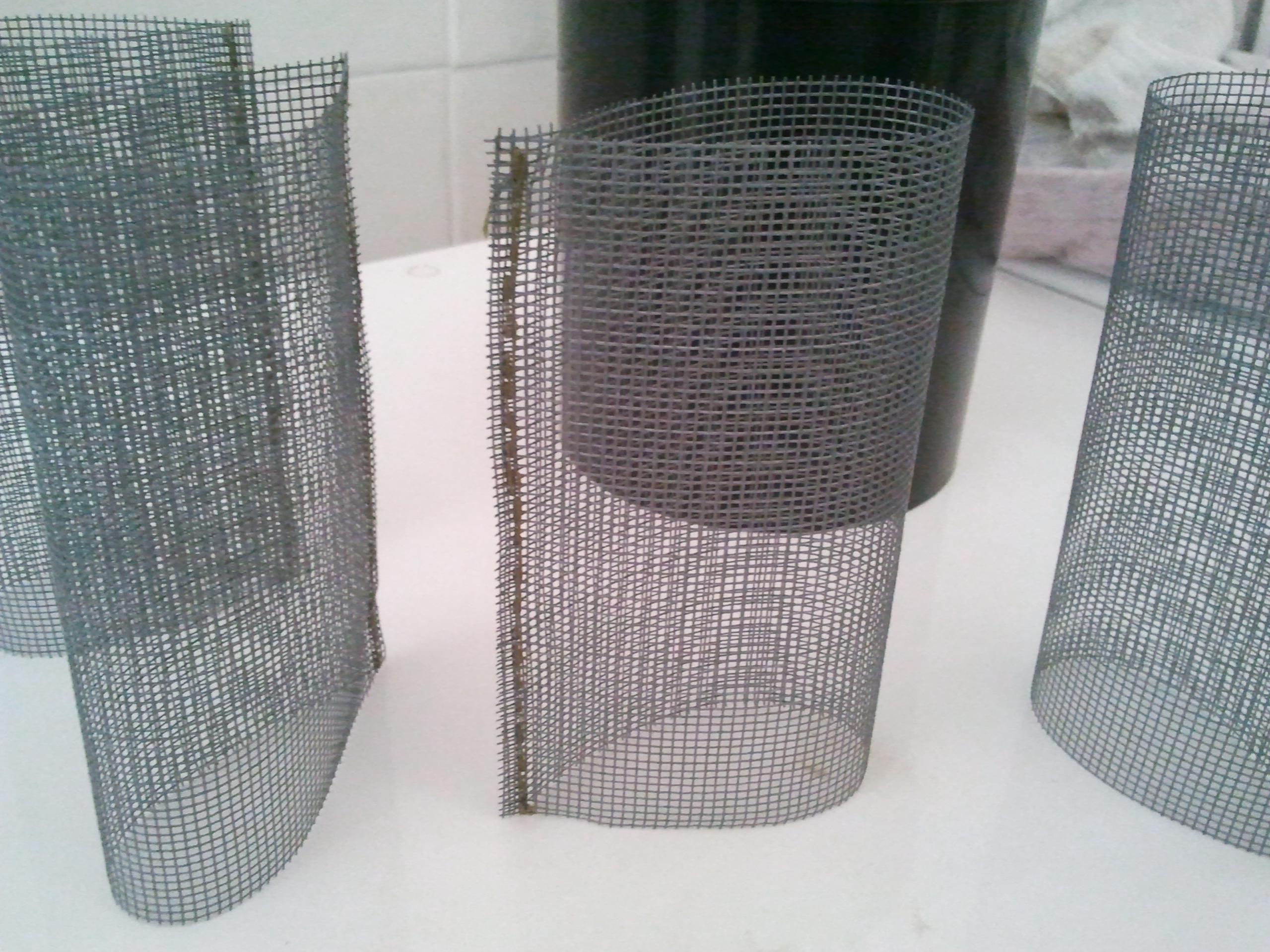

...or you can go taco-style with mesh inserts into a two-35mm-reel AP tank (Patersons will not do). I was using plastic bands for my taco-style development but I saw this idea from some guy over in LFF, and it seems to work better than plastic bands, since it does not put any pressure on the film.
See the attached (crappy phone camera) photos. I got some plastic mesh (the one you use to keep the bugs out of open windows, etc), cut it down to the appropriate size and stitched it up with plain sewing thread.
First test with b/w film was a success - it takes a while to get used to the mesh inserts but after a bit of practice in the dark, it becomes easier. This system allows me to develop 4 frames of 4x5 film in a inversion tank that uses 900-1000ml of chemicals, thus making it possible to develop C-41/E-6 films with the 1lt kit.
