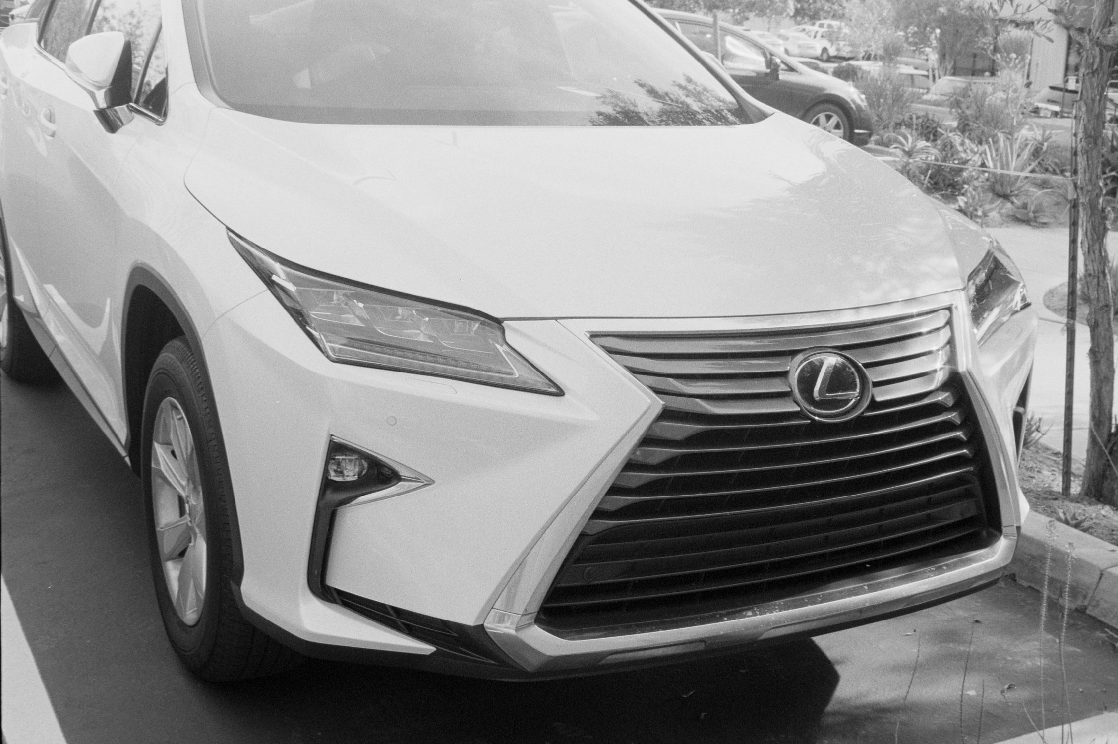

The attached photo came from this test-roll, and was shot with an Olympus Trip 35 with my manual-speed modification. It shows the laughable styling of cars nowadays: The car's grill looks like Dearth Vader's mask!
