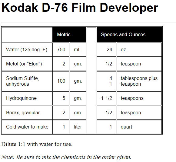

Here, as an example, is one mix yourself version of D-76.
I think most would agree that the Metol and Hydroquinone are both critical components, and that the relative proportions of Metol and Hydroquinone to the other components - particularly the Sodium Sulfite - is important.
The OP is starting out with a package that is 19 times larger than the recipe shown. The likelihood that a small portion of that much larger package will have, relatively speaking, the same proportion of components is quite small, no matter how much the package is shaken up beforehand.
