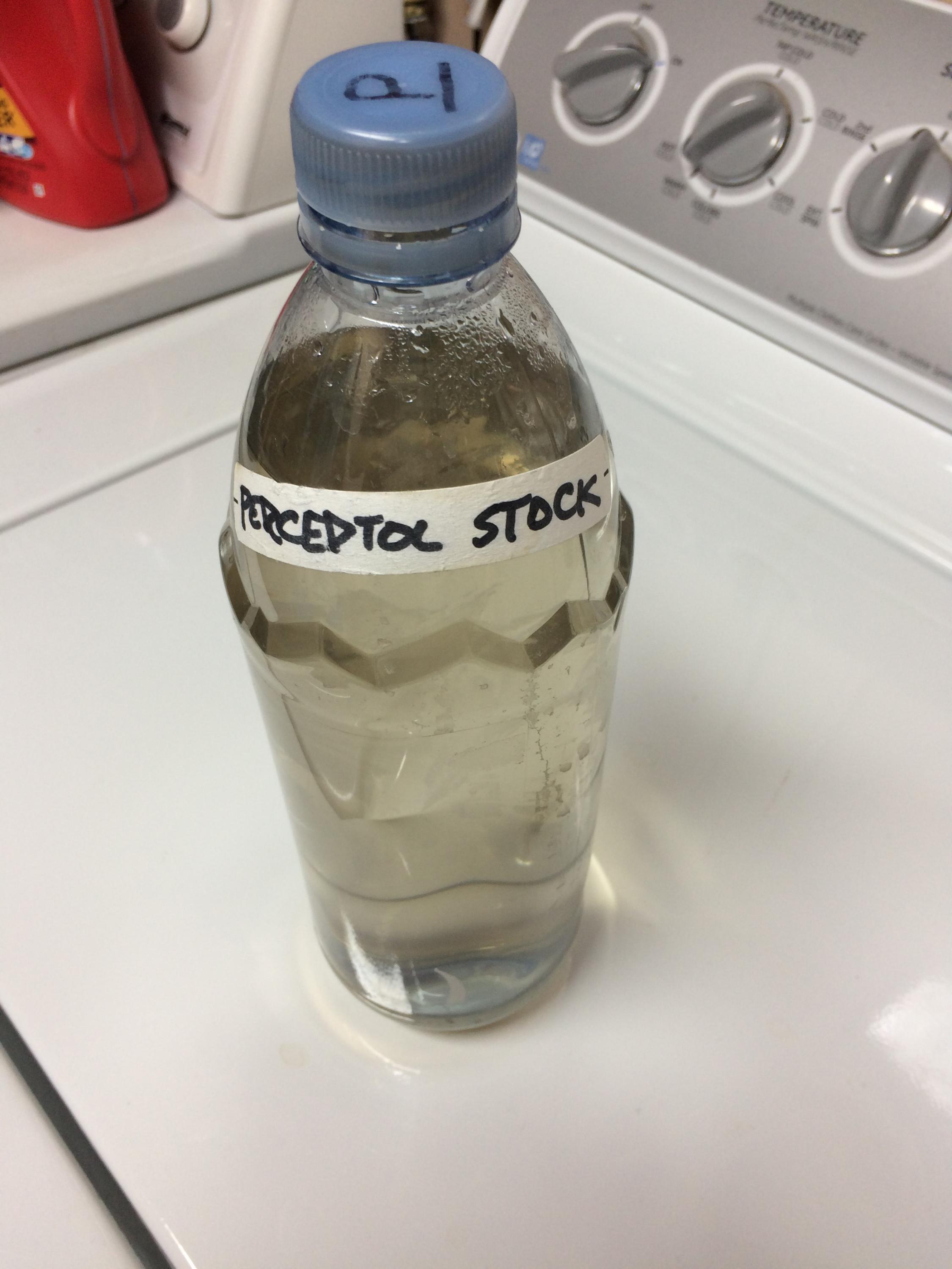

It's been a while since I prepared Perceptol. Part A was kind of brown and chunky (unlike B which has the color and consistency of white sugar). The final stock solution has a brown color to it -- you can see through the bottle, but it does look brown and cloudy. Is this normal? I'll clip test it of course...

Part A contains the developing agents. If it is brown then they have oxidized. Toss it.

Well, that sucks. And I have two more boxes from the same batch. These were just purchased last summer and stored in a relatively cool, dry place in my home, so I'm surprised. The powders are in sealed foil packets, so I wouldn't expect moisture to be an issue (referencing a PM I received). I'm attaching a picture of the stock solution. Thanks for the feedback.
You can toss it if you want, but by the looks of the bottle in the picture tossing might be a waste of money. If it has just a light tint I'd say you're just fine. If it's headed to coffee-brown it goes down the drain. My Perceptol has a slight pinkish-brown tinge to it and it works just fine. My homemade Perceptol is perfectly clear and it also works fine. Just do a snip test and you'll know for sure. John W

Fine grain developers like Perceptol and Microdol would produce poor results when used as a print developer. The brown color comes from compounds called humic acid formed from oxidized developing agents. The user runs the risk of paper staining. Trying to use oxidized developer is a false economy.
