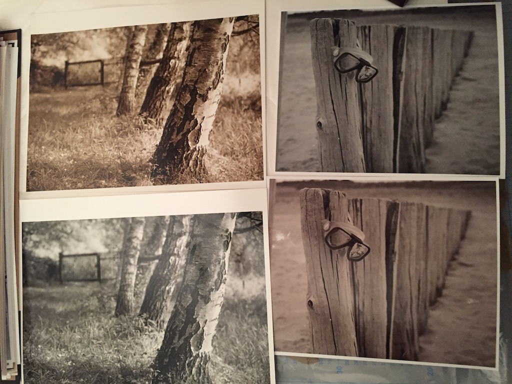

Toned two prints after making working solutions from the concentrate tonight. Smells as expected. Works ok. The print on cool tone paper (MGCT) turned into a cool brown, somewhat unobtrusive. The print on MGWT turned into a fairly warm and strong brown. Without having seen them dry next to untoned prints, my favorite would be the MGCT. For MGWT I might still prefer Moersch's carbon toner after bleaching.

Just to sum up: here is a snapshot from two untoned vs toned prints (trees are on MGWT, the goggles are on MGCT). Both directly toned as described above, roughly 10mins.
Lars
