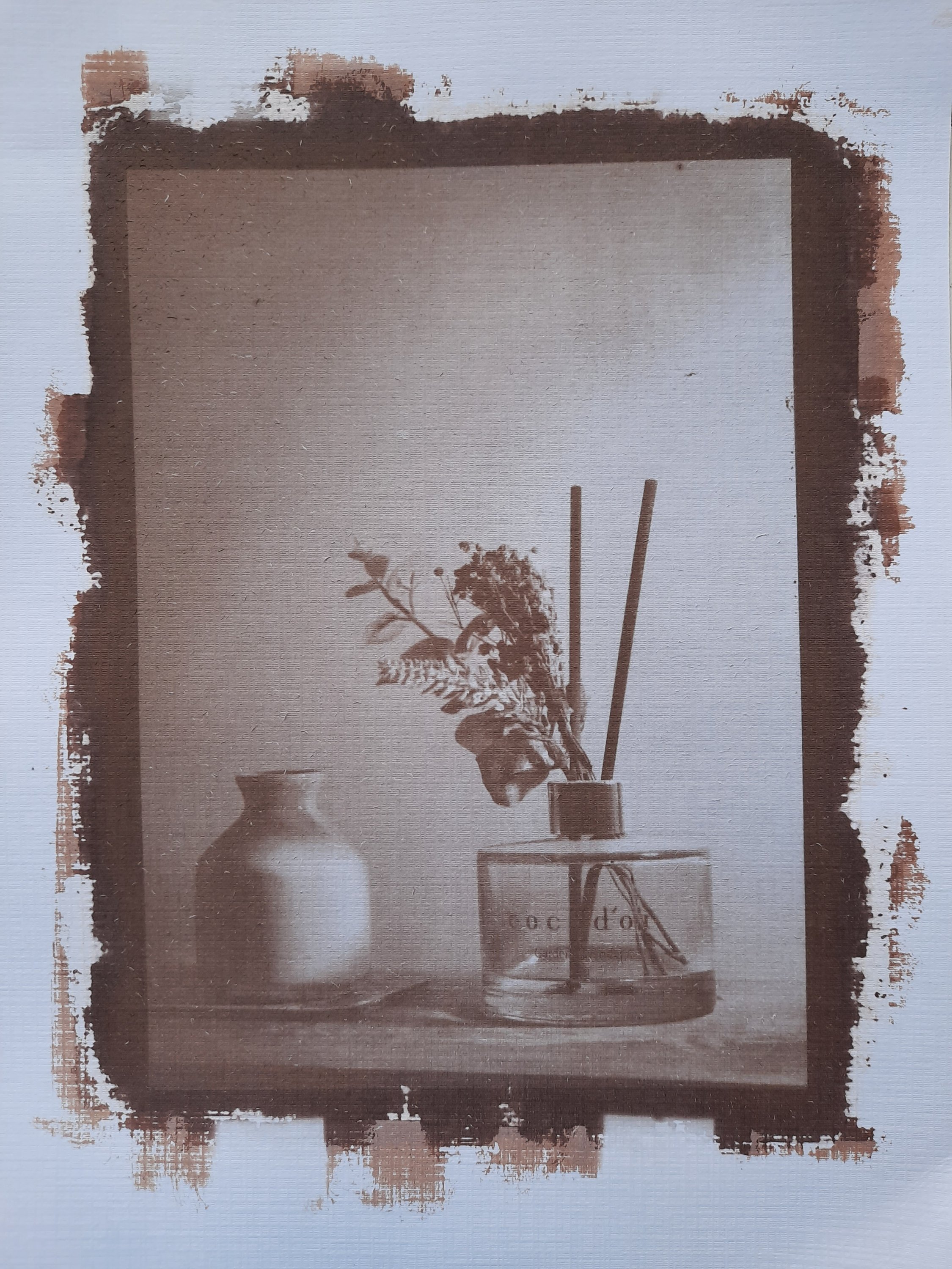

Hi,
I am new to the alternate processes space and I have started my exploration with salted paper print.
I have made my first print with 2% NaCl and 12% AgNO3 solutions. The image came out okay but it seems to be embedded in the paper and lacks sufficient sharpness.
I believe this is happening because the paper is not sized. I have attached an image of the print.
In the article titled A Dash of Salt, I see the author recommending a recipe for sizing. Which is an independent step.
I have seen people on YouTube mention that they add the gelatin in the salting solution itself.
Can someone please share the recipe for a salt solution with gelatin?

Lovely photograph!
I have used a gelatin sizing solution that is 10% gelatin, 1 tablespoon of KOSHER salt and 1 L of water.
Put it in a light tight bottle. It might smell fishy that is normal. I have also used the salt without gelatin on Hammermule Platinum Rag with no issues.
I add my silver nitrate (and citric acid ) to the coated paper after the sheets are dry.

There's several recipes for sizing paper. I've seen recipes that call out gelatin, salt, ammonium chloride etc. I would find a reliable book

Hi,
This is a characteristic inherent to salted-paper printing.
The image is a bit soft because it is embedded in the paper rather than lying on top of it.
Yes, sizing the paper either before salting it or while salting it will keep the image from 'sinking in" as much.
I would recommend getting a copy of Chris Anderson's book "Salted Paper Printing. A Step-by-Step Manual Highlighting Contemporary Artists".
She covers many recipes (formula) for sizing salted-paper prints. I am not sure she has a recipe for gelatin sizing but she does cover using casein and various types of starch. This book covers much much more that is very useful to know about.
I can't recommend one particular method as I prefer the look of the original "just soak the paper in salt water" method so I have not experimented much.
