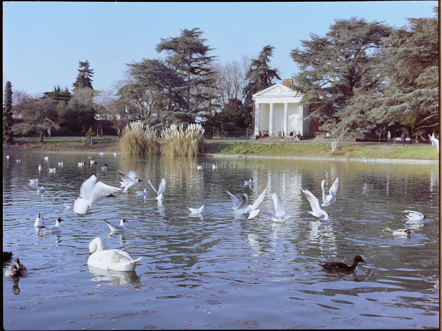

I mixed Portra and Cinestill this weekend and fairly sure it affected the colour cast of the Portra roll . I won't be mixing Cinestill with daylight film again .

@Heathcliff Can you post photos of the negatives as well as scans or print photos so we can see what you're claiming? That's certainly not something we'd expect...

here's a couple from the roll of Portra 400 shot at normal , both in daylight . Very washed out looking colour wise , if there's another explanation I'd be happy to hear it . I was surprised and after reading the original discussion here thought mixing Portra and Cinestill could be the reason . This was roll 5 and 6 processed in Bellini chemicals which has a capacity of 16 rolls , so shouldn't be exhausted yet .

If you exposed that as Portra 400, we found your problem -- that's 1 1/3 stop underexposed. Portra 160 in the edge markings...

That's a typo error on my part , I shot the roll at 160 as I changed the fiddly iso dial on the GS645 to do so .

Those look pretty near normal to my (admittedly not very critical) eye. If you want more saturation, one way to get it with C-41 is to expose a little more -- 1/3 to 2/3 stop (so EI 125 or 100 on Portra 160) will produce more dyes in the image.
For the portrait, when shaded and lit mainly by sky, the color will always shift toward blue, and I do see that effect. The duck pond looks slightly cyan casted -- potentially due to developing problem (unrelated to having Cinestill in the same tank), or as likely due to a scanning error (wrong film profile?). For both, it looks to me as if you can correct the color, either in software after scanning or with filtration in a darkroom print.

Yes back in the nineties when I shot neg as a newspaper photographer we used to push 2/3rds quite often to make the image more punchier . I’ve had a long break from processing colour neg but would like to do more but only if I can get decent results without a big investment . At present I’m
Using Patterson tanks and spirals and a Cinestill heater . I’m scanning with a 5d and an Essential Film Holder using Negative Lab Pro . Very happy with the software and compare favourably with Lab scans for a fraction of the cost .

I was wondering if a depleted bleach or fix could also affect colour . Thanks for the advice anyway .

If your bleach was getting exhausted you would get retailed silver in your negative and it would make the negative look dense. To confirm this, if you hold the negative by the edge, emulsion side facing you and tilt the neg back and forth you should see the image change from a negative to a dull positive.
The cyan look to the images ( I know you can colour correct) reminds me of underdeveloped negs. I think the edge markings should have more density.
