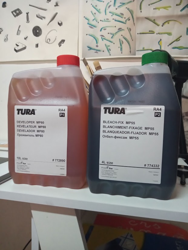

Thanks for the precision. It is known that Tura has been bought by PhotoStar some years ago; actually what I should have said is that ra4 paper signed as Tura is still available. Even according to its website it seems to continue to be distributed. By the way, I recently bought ra4 chemistry from them in my country (Ecuador). It says Made in Belgium. I can't find the production date either, but the label says: Tura.
http://photostar-germany.de/products/
Very interesting! These are the same type of bottles that some of Fuji's minilab chemicals come in, and they are also produced in Belgium
Should be from Fuji-Hunt. Or from Agfa, A SP 95, but then it would be at least 7 years old.
