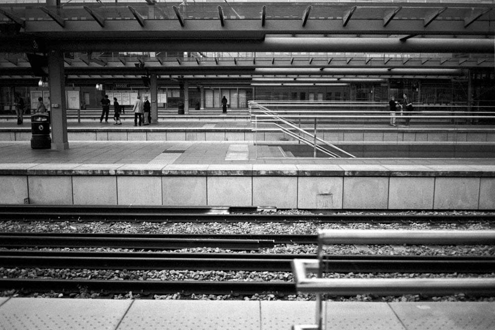

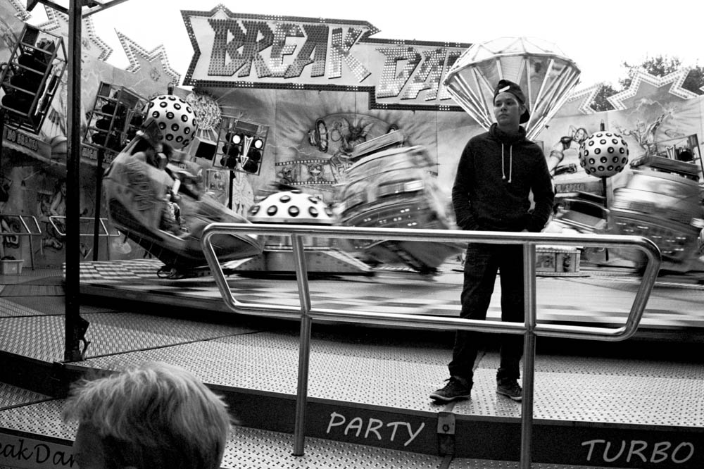

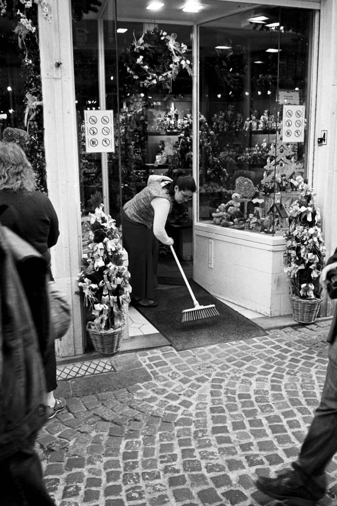

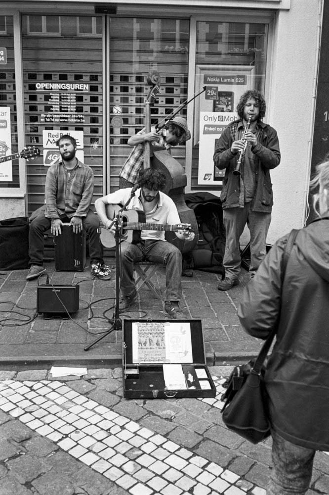

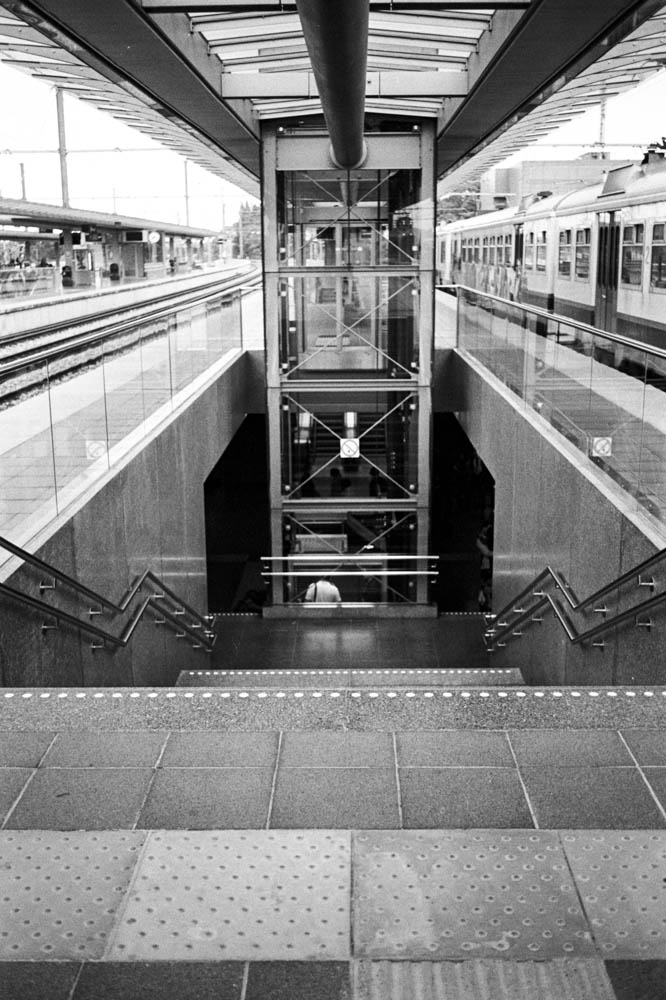

So what's the problem? Well, when I'm on the streets, I'd like to shoot some pictures too (no models).
My negatives look really "dull". Probably because the light isn't always so interesting but let's give an example.
I really like these shots on Tri-X (the black & whites): http://www.johnnypatience.com/london-on-leica/. They are really contrasty & poppy. Bright and clear.
I tried a mid-yellow filter this time to increase the contrast but no real improvements. Look at the shots below. These are by no means good shots, but they prove what I want to show and what I want to work on.
What should I try improving on them? They had a little post-processing when I scanned them. Mainly exposure, pulling blacks deeper as they were even more flat / dull before that.
If you see the differences between Johnny's black & white and mine's. What are the key improvements I should make that could get close to the look, I'm looking for?

You can expand your developing time, but unless you print on paper(enlarge and chem bath) there is no real way to determine what you need to do. Post processing after scanning doesn't show what is really needed. Controlling contrast when printing is IMO the true test of a negative.
Looking at your photos as posted I cannot really figure out just what your problem is or what you think it is. I can only suggest you try to add to your development time or try another film developer, maybe D76. What works for other people may not work at all for you due to the difference in the ways you do things -- even a slight difference might make a big difference -- and the fact that you use a scanner. I get good results from making scans of b&w negs but it took a year of spare time and input from real computer-based pros to get me at that point. Good luck. I like your images.
Under-exposure is a pretty common issue when first starting out. Can you post a scan of your negatives in question? Prints from under-exposed negatives tend to lack contrast and need to be printed on a higher grade paper.
Thanks :smile:! I know Johnny's pictures are developed in XTOL. Maybe that's a difference? And mostly lightning conditions I guess. Should shoot and try more.
What do you mean by "add development time". Just develop for a little longer on the same dilution? For now, massive dev chart says 6 mins on Tri-X 400 , Dilution B (HC-110). Doing 6m30s for now. So maybe 7 mins?
The negs I shoot from models are mostly spot on (or at least that's what my lab told me). As I use an external meter for that. Missed it once due to harsh sun lights, the bright overcast fooled my meter which gave me one stop less than I should have. On the streets I use the M6 meter. Feels like I'm missing with it regularly as I don't use it that much. Maybe the third time in 6 months since I've used the internal meter. Could be the lack of experience with the meter. Well probably it is just that, which made me underexpose.
Jessestr, I am also not sure what you feel you are missing because your shots do not seem flat to me. Many of your shots were taken in open shade while the reference shots from johnnypatience are taken in direct, afternoon light, some backlighting with flare.
johnnypatience demonstrates awareness of the light, while you might be more interested in the subject regardless of the light. (If you've heard of projection, I might be doing that here. I often reflect on my own photographs and think they could be improved by paying less attention to the subject and having better awareness of the light).
johnnypatience's cafe shot is an example where he plays with light. The left background is straight gray, the right background is rich black and the centerpieces on the tables are each bright white. But you've got the shot of Lynn on the rocky beach with great lighting so I can't say you are ignoring light.
If you can separate your shots taken in shade from shots taken in bright light, you might consider developing shots taken in flat light... for longer time like snapguy suggested. This will brighten them. ic-racer hinted that you might expose more. For example instead of shooting at 400, set the meter to 250. I don't think your grain is real, it might be an artifact of scanning.
So to sum up: 1. Nothing is wrong with your photographs. 2. To avoid underexposing, set the meter to slower setting. 3. If you think the negs look flat, you can develop longer. 4. If you think your photographs need some key light, make sure to shoot in that kind of light (Ignore 3. if you do 4.)
With Trix use 200 ISO and incident meter off nose of model dome pointing back at camera.
Assistant with big reflector.
If model has dark skin give extra stop of exposure.
Though some people like all black shadows you get from underexposure it can be difficult to avoid with candits.
+1 on the comments of snapguy and Bill Burk.
Looked at your photos (the attached thumbnails) and to me they look fine, and have just as much "snap" as those in london-on-leica. In both cases, flat lighting, yet pleasant contrast with good midtones. I also second the comments of Rick_A; see also my response #22 in (there was a url link here which no longer exists).
Your photos look fine.
Surely there is plenty of detail on the negs to play with during printing.
You want contrast? Use a contrast filter.
You want more "pop"? Do a split contrast print.
And anyway, I'm not sure why you're impressed with that Johnny Patience guy.
I knew not to expect much when I saw he went out of his way to make known he shoots a Leica (great, another guy with Leica doing "street").
But I visited the site anyway.
His shots (the London ones) are pretty cliched and some downright bad (the crooked buildings ones).
Turns out the guy doesn't even develop himself, he just sends them out to a lab.
And his wife sells instagramy hipster filters/presets for Lightroom/Photoshop for a living.
I don't think this guy is someone you should look up to in any way.
Jessestr, I think you are looking in the wrong place for a fix.
From the looks of what you've shown so far I think you probably need to be talking about how you print, not how you expose and develop.
What I'm getting at is that you are not shooting slides or JPEG's; negatives are just a storage medium, if you want a little extra snap, just adjust the print.
Your photos look perfectly normal.
What I do notice is that they seem to be shot in mainly overcast conditions (the shadows are very weak). This results in a flat light in the images.
There is nothing you can do about flat outdoor lighting (except bring a flash or reflector for portraits). I tend to avoid shooting on really cloudy days (unless there is a chance the sun will break though, then you'll get spectacular results).
Wait for a sunny day and watch the difference, i.e. more dramatic shadows and highlights.
