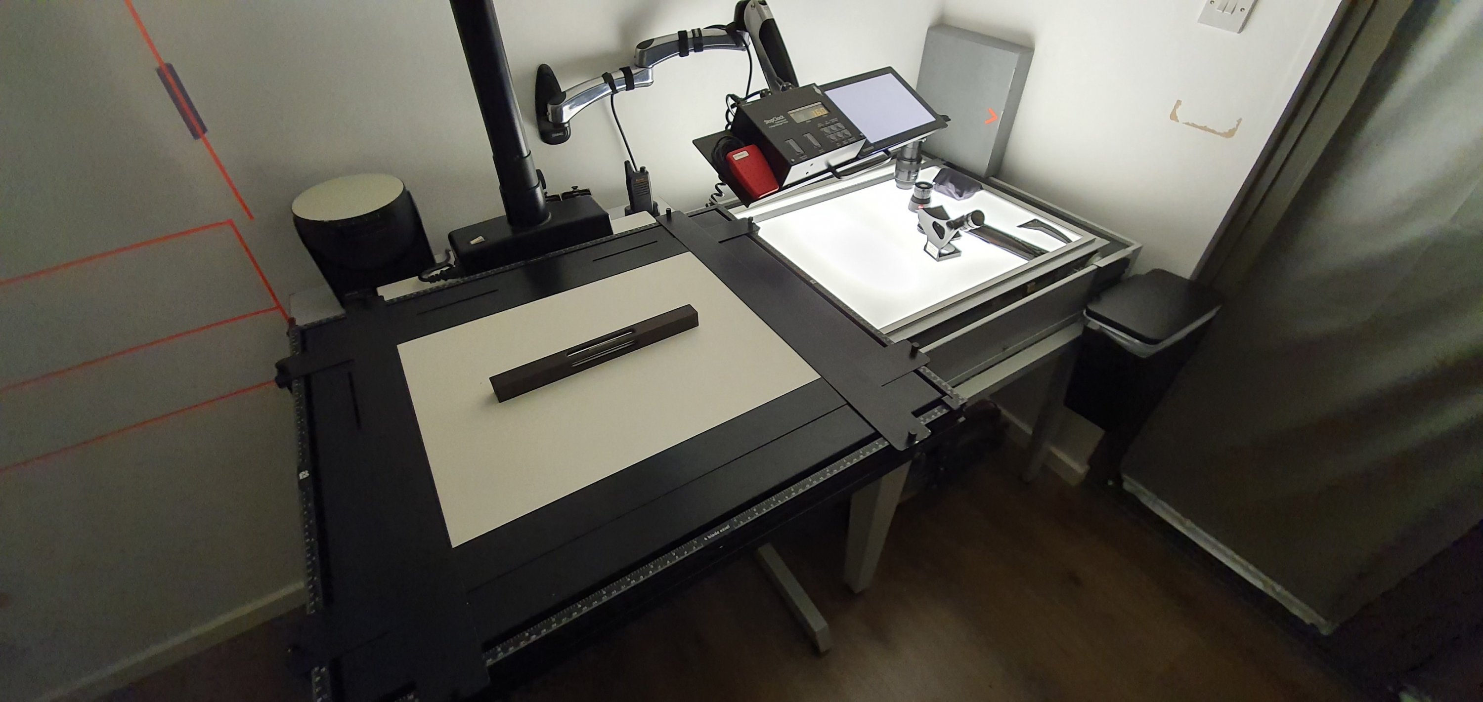

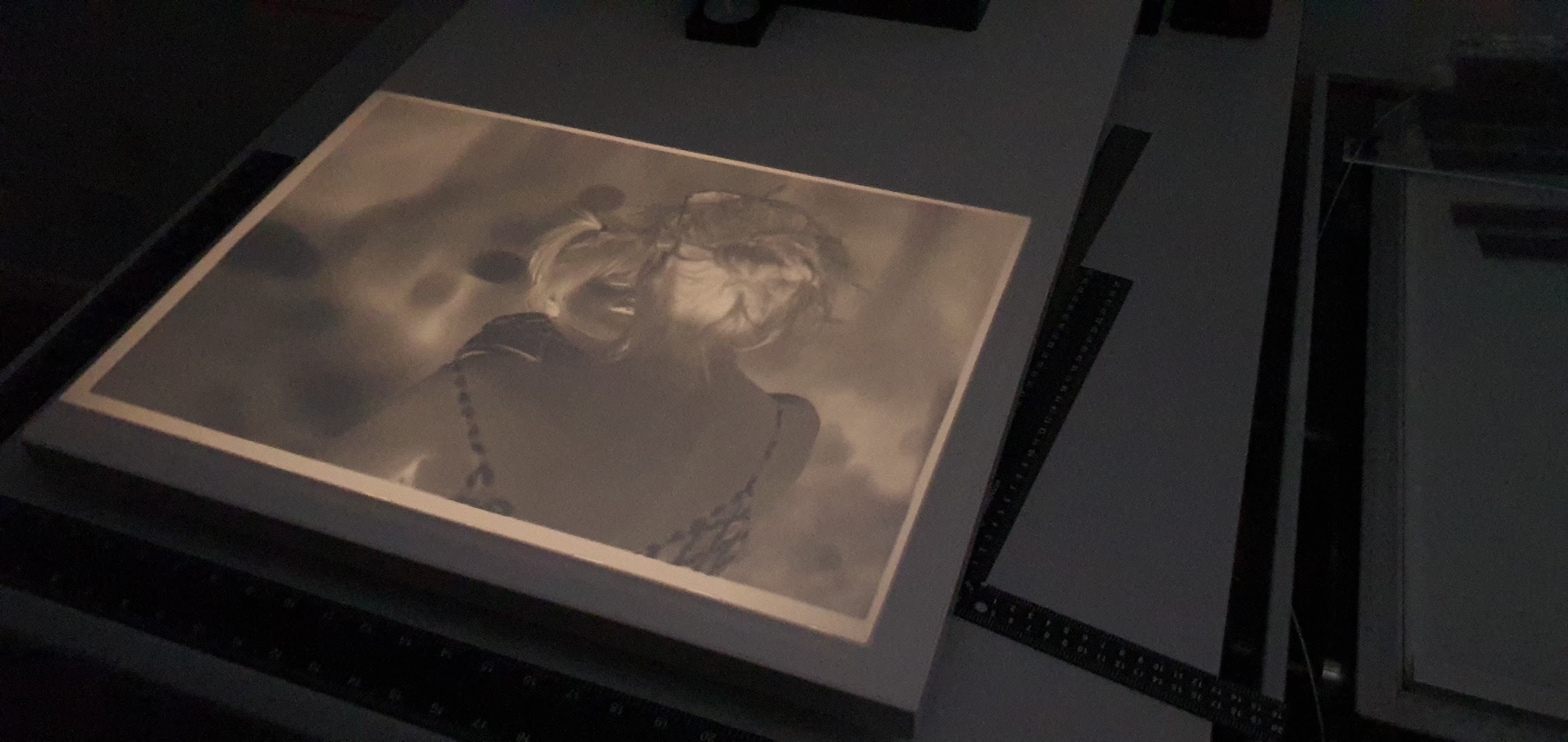

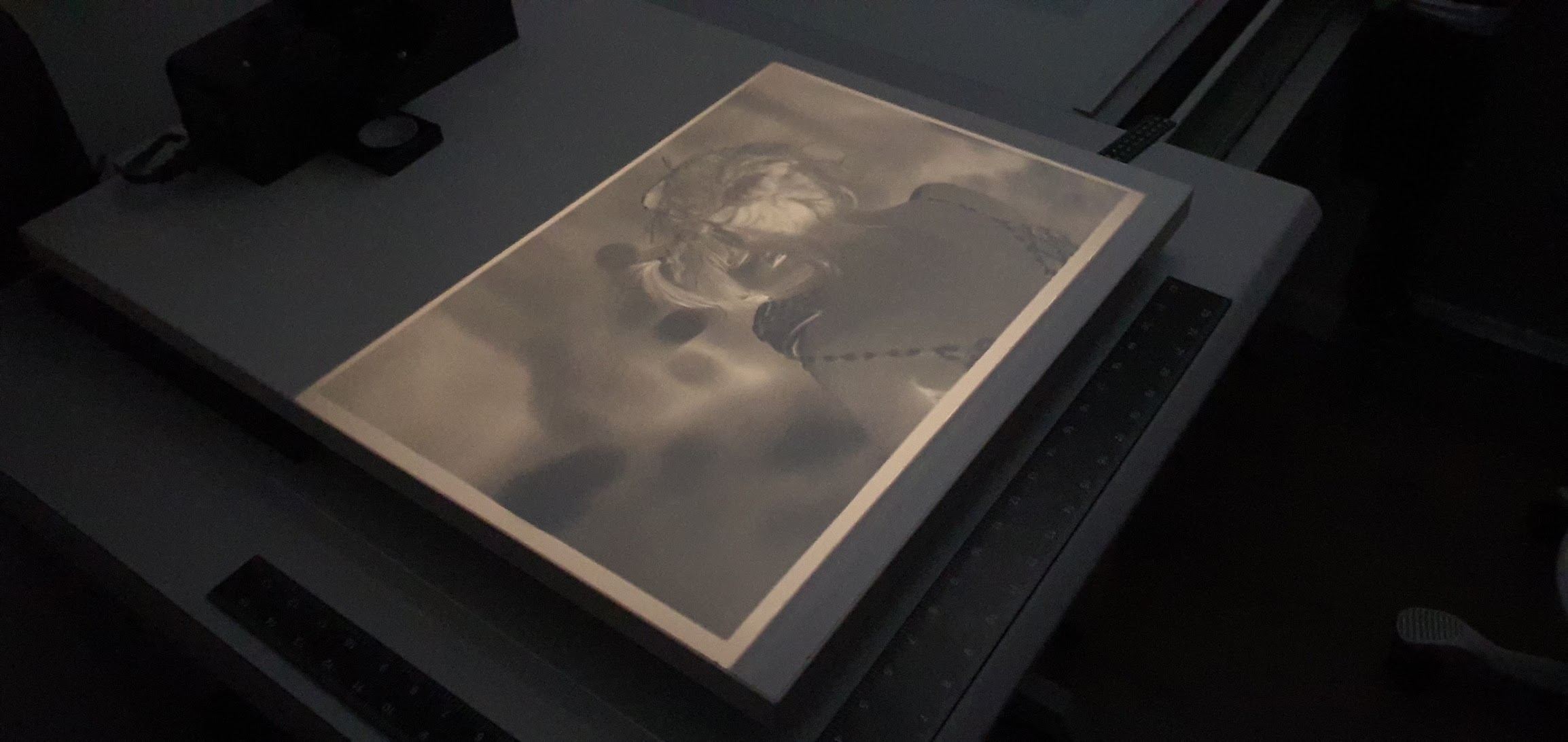

ISSUE: Despite the easel being level the enlarger is projecting an image that is not perfectly rectangular. (clearly seen in the last image).
Beard easel = 20x30inch
Leica V35

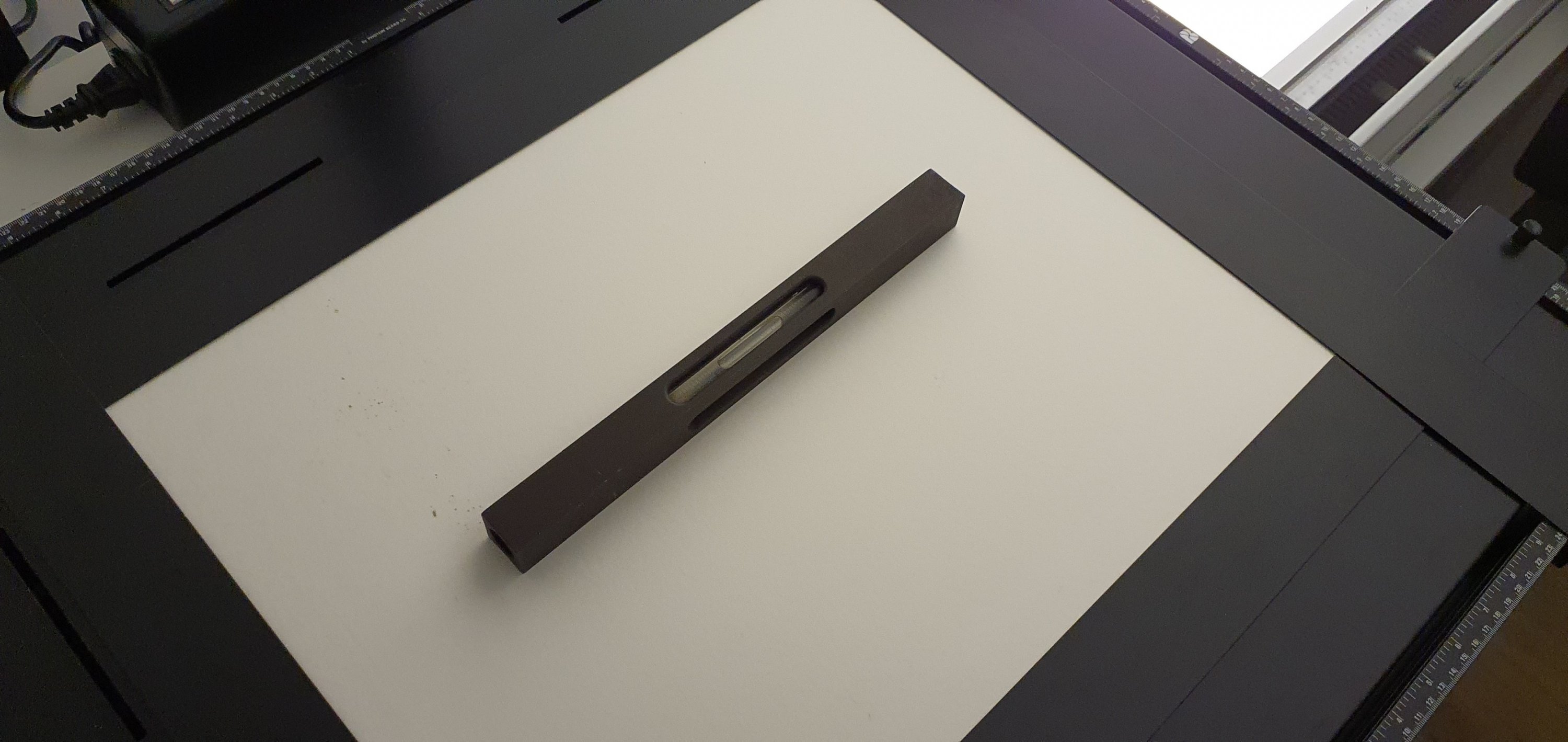

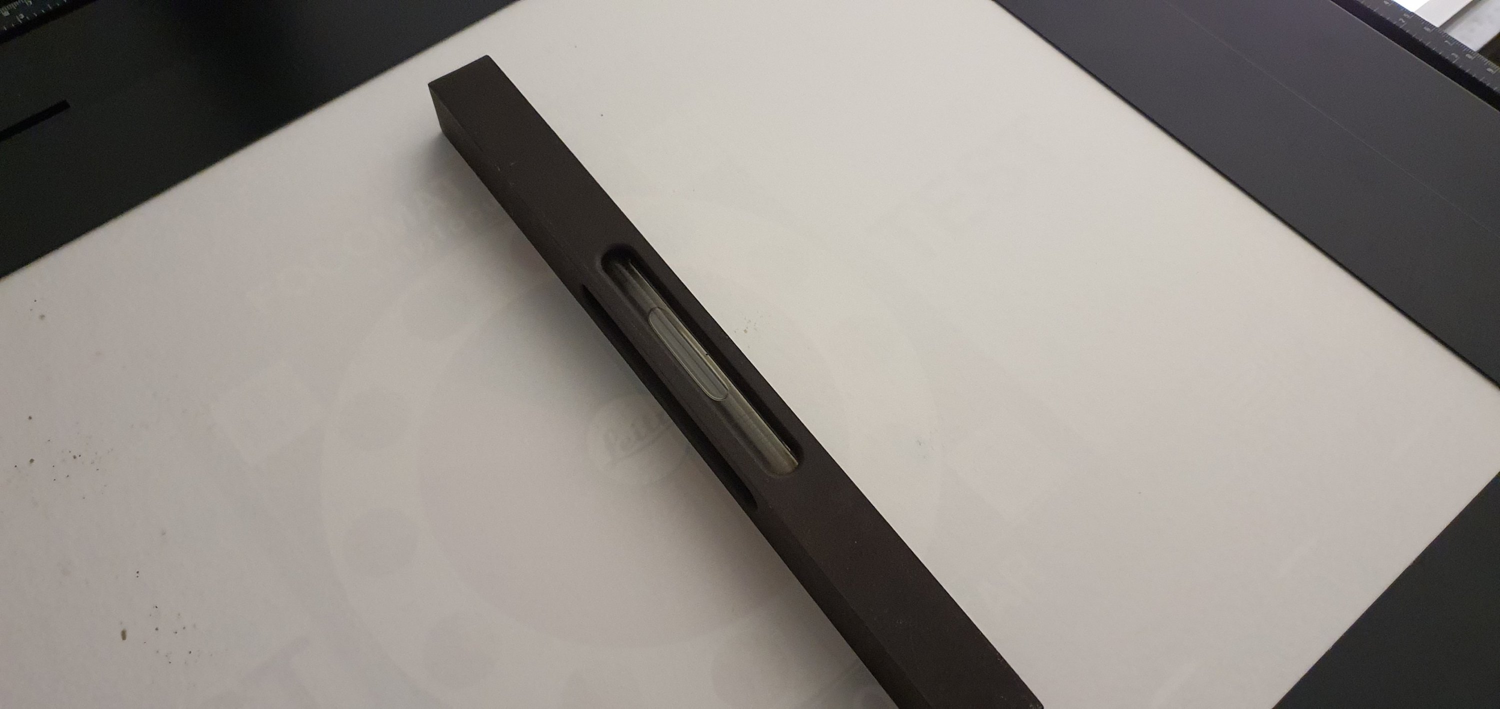

Image 1. Easel not level

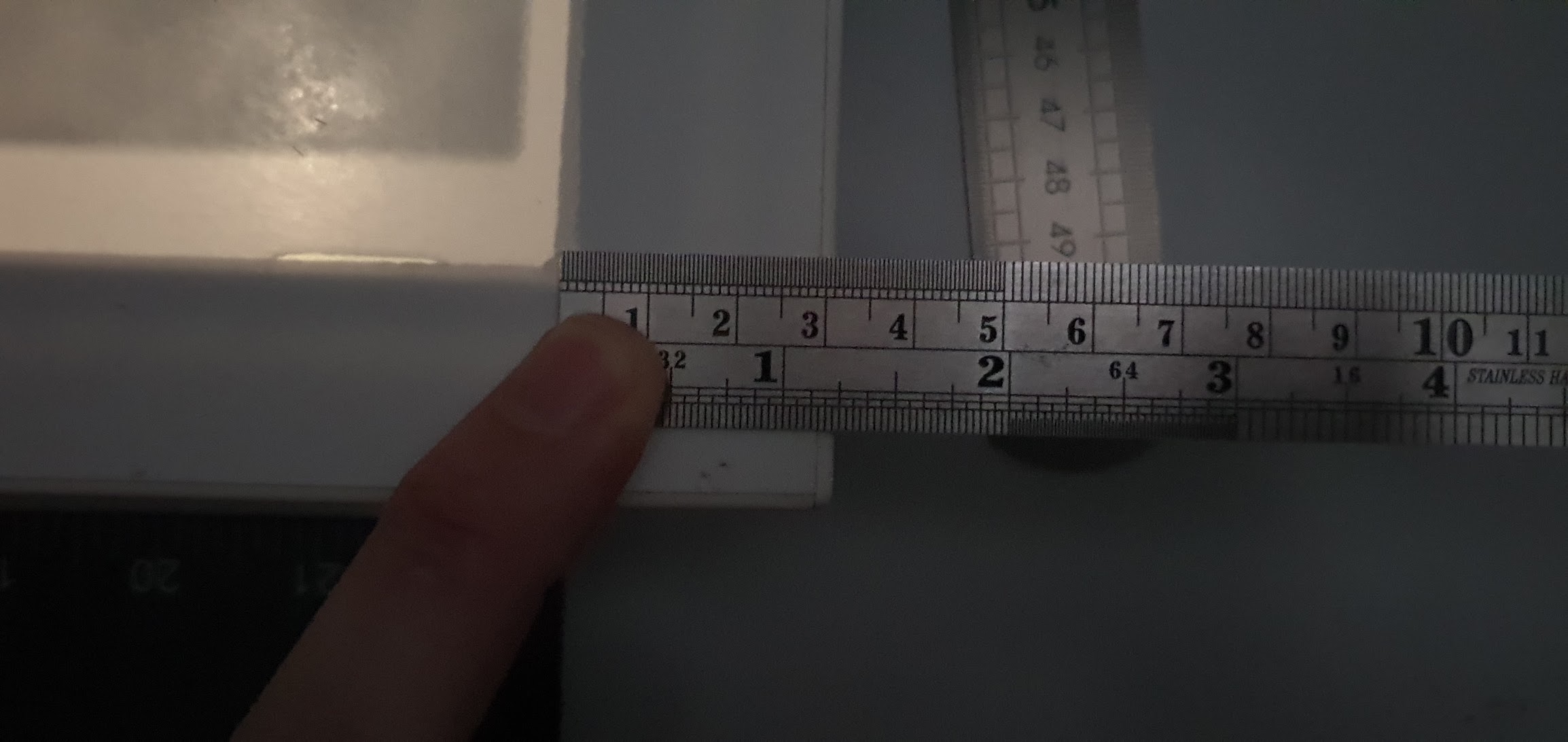

Image 2. Underside of the easel: This is the reason for easel not being level. Is this normal for beard easels?
Image 3. Using blue-tac the easel is now level-ish, is there a better way than this?
Image 4. Using blue-tac the easel is now level-ish, is there a better way than this?

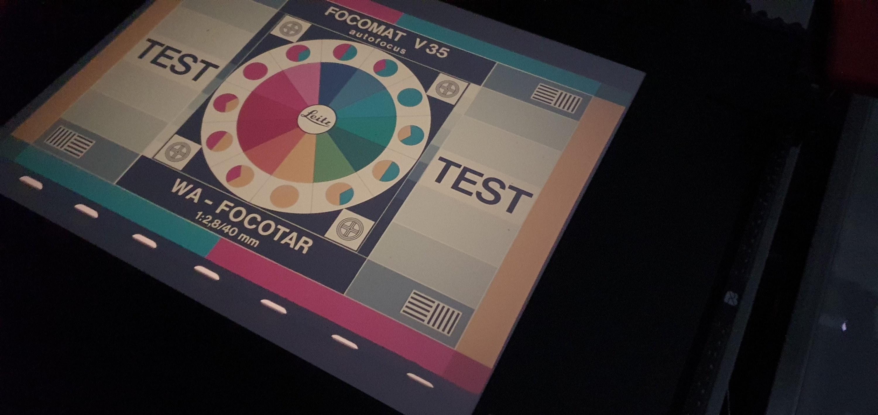

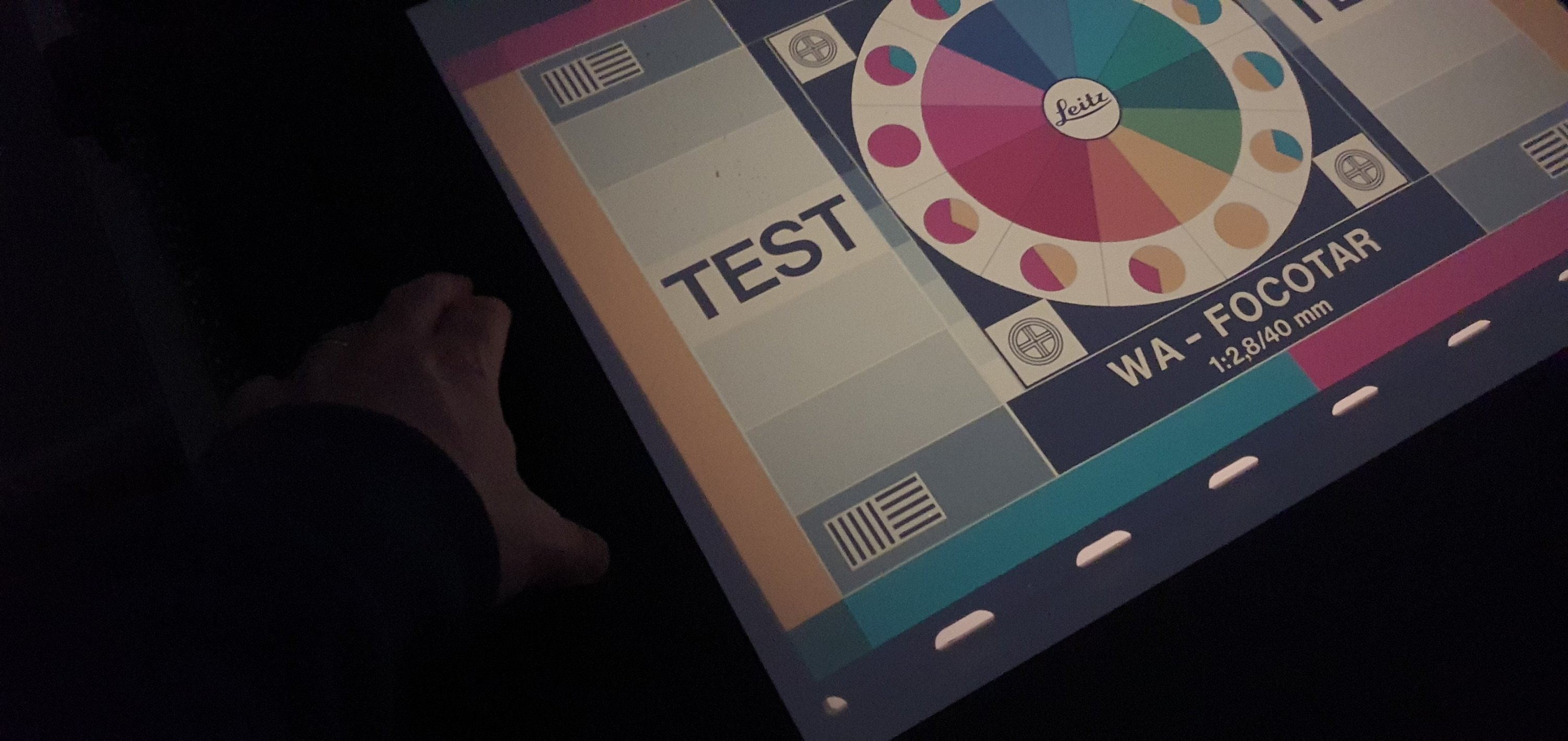

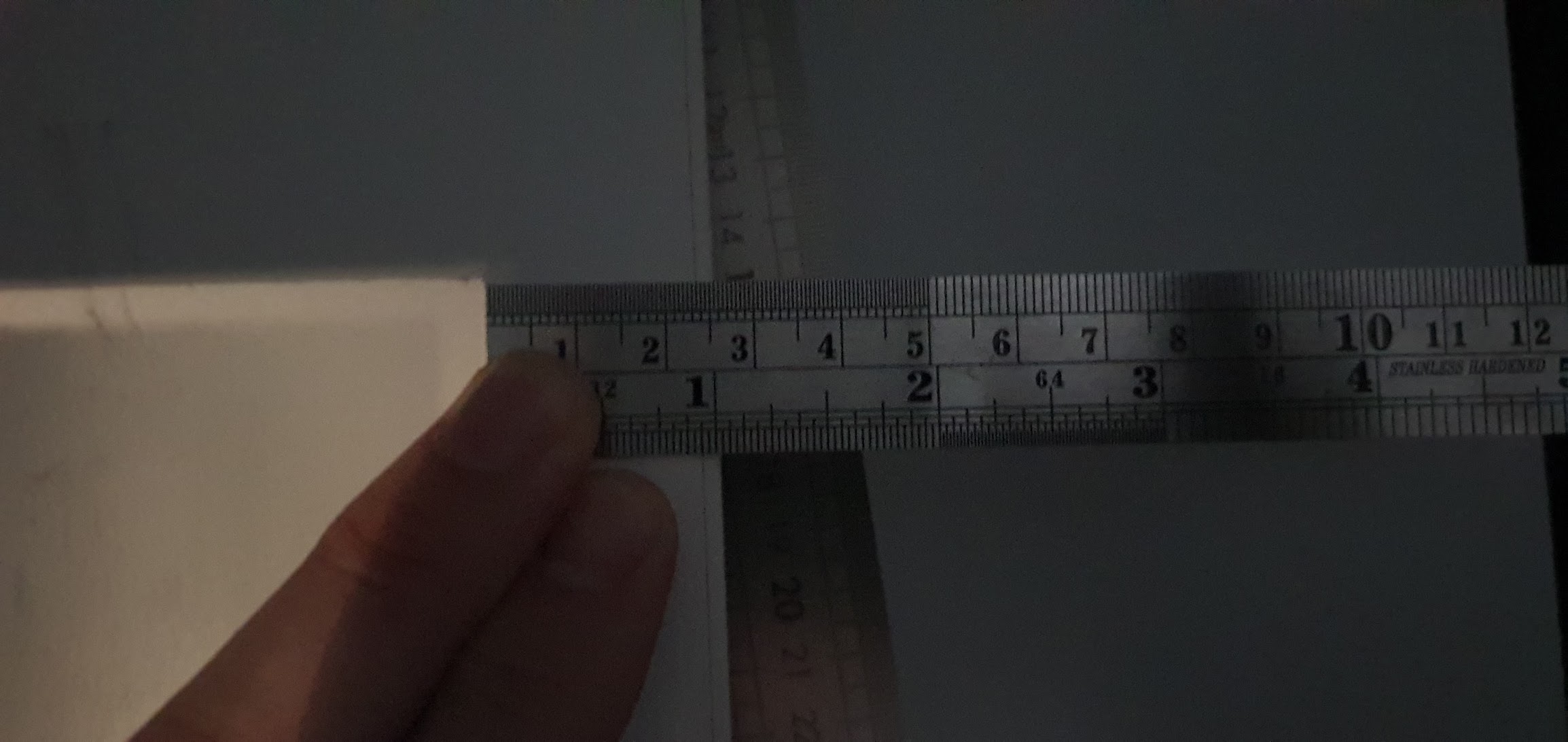

Image 5. The right hand side of the test Negative is square with the beard easel

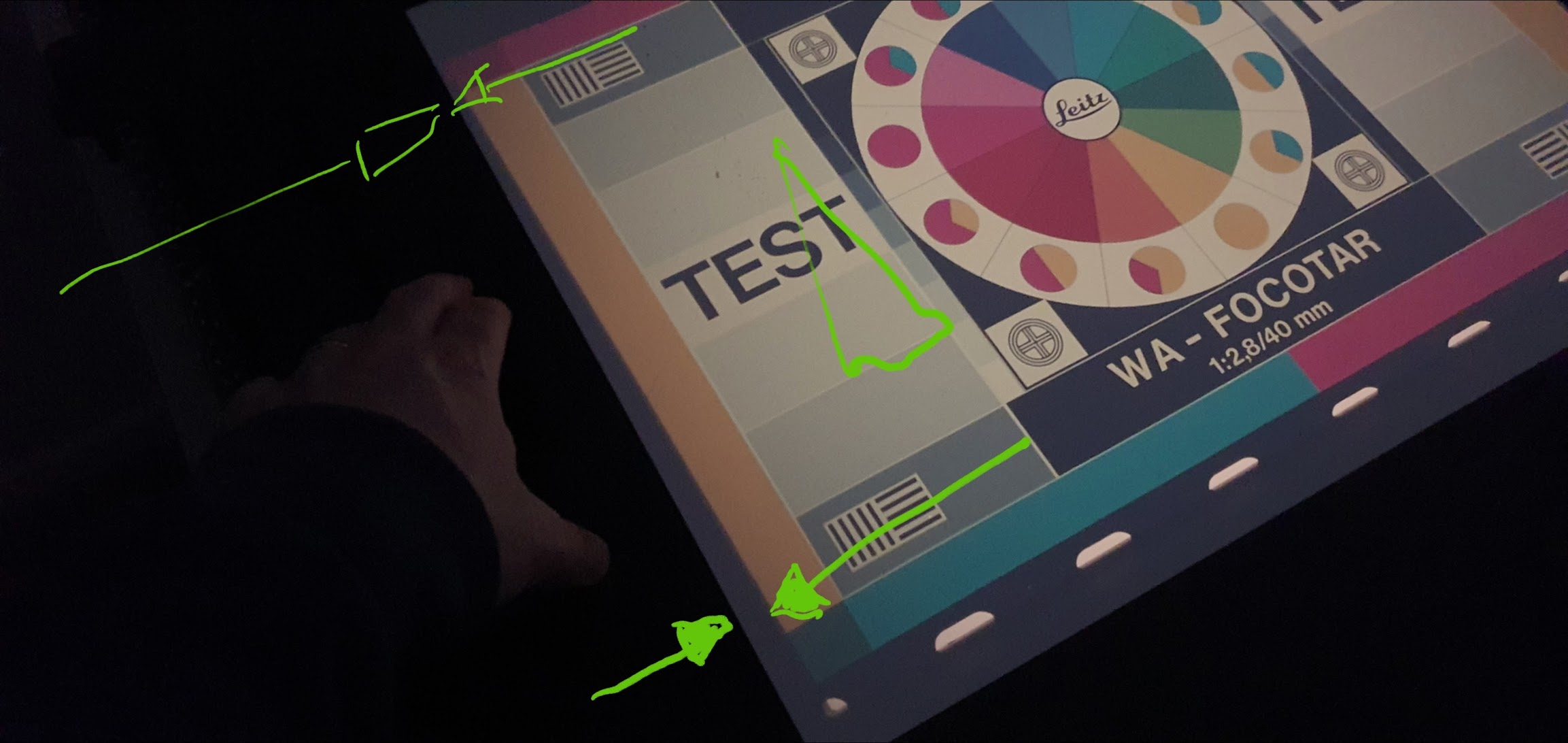

Image 6. The left had side is clearly not square. (Here you can see that the easel blades at the top of the photo are much closer to the projected negative that at the base of the easel blade. )
Can anyone shed some light on what is going on?
I'm a little stumped to why the image is not being projected straight square and true.
Thanks in advance.
Jamie

I read your post, examined the photos, and initially failed to notice the small detail you referred to. By blowing up photos 5 & 6 and comparing the right side of photo 5 to the left side of photo 6, I now see what you’re referring to.
The angular narrowing of the left side of the projection might be explained in one of two ways.
1. Something is masking the right side of the negative to project the angled side as seen at the left of photo 6. This seems unlikely, but should be considered.
2. If no such masking is present, then the lens axis is skewed relative to the baseboard so that the projection is distorted. Essentially, the projection distance is greater at the upper left corner than at the lower left corner [note: I exchanged "upper" and "lower" in the sentence to correct the statement from its original form]. That gives a varying magnification of the image. Closer areas are magnified less. Farther areas are magnified more.
The small amount of adjustment obtained by adding tape to the contact pads of the easel is too small to account for the problem as shown. Since you’ve adjusted the easel so that its top surface is parallel to the baseboard, the problem is clearly not connected to the easel.
Given the depth of focus above the image plane, you can make a crisp, well-defined print as is. If you want to eliminate the angular distortion (too small in this case to matter for most photos), you’ll have to adjust whatever is causing the misalignment between the lens axis and the baseboard.

Removed the easel.
...alined the projected image with the left hand side of the bace board.
the right hand side is out by at least 5mm or 13/64ths inch.
