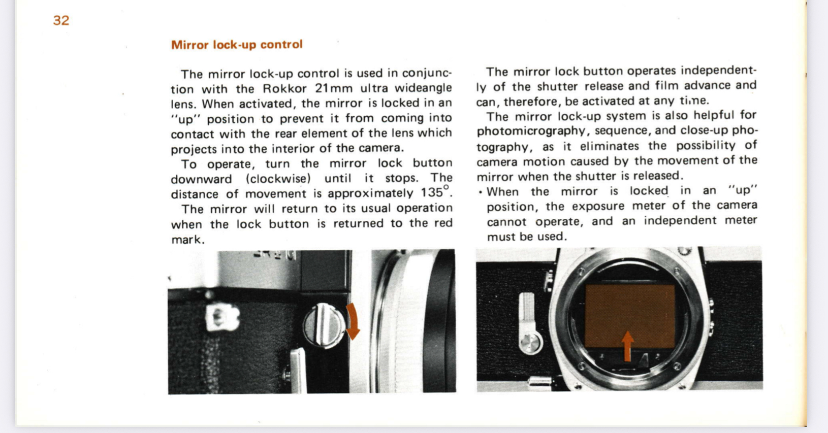

According to the SRT manual the mirror lock up was to allow the 21mm lens to perform.

That is partly why Minolta removed the mirror lock-up. First, not all SRT 101 cameras have it. It was added to the cameras in 1962 when they introduced the SR-7 and the 21mm f4 non-retro-focus lens which needed it. By the time of the third version of the SRT 101 was introduced in 1971, Minolta was already selling 20mm f2.8 retro-focus lenses so it was dropped from the SRT 101, as well as the SRT 102 in 1974. It did not appear in the SRT 2XX models, or the XE cameras -- which had a shock absorber built in to deal with it. However, all the XK/XM/X-1 models retained the mirror lock-up until the end of their production around 1979.
