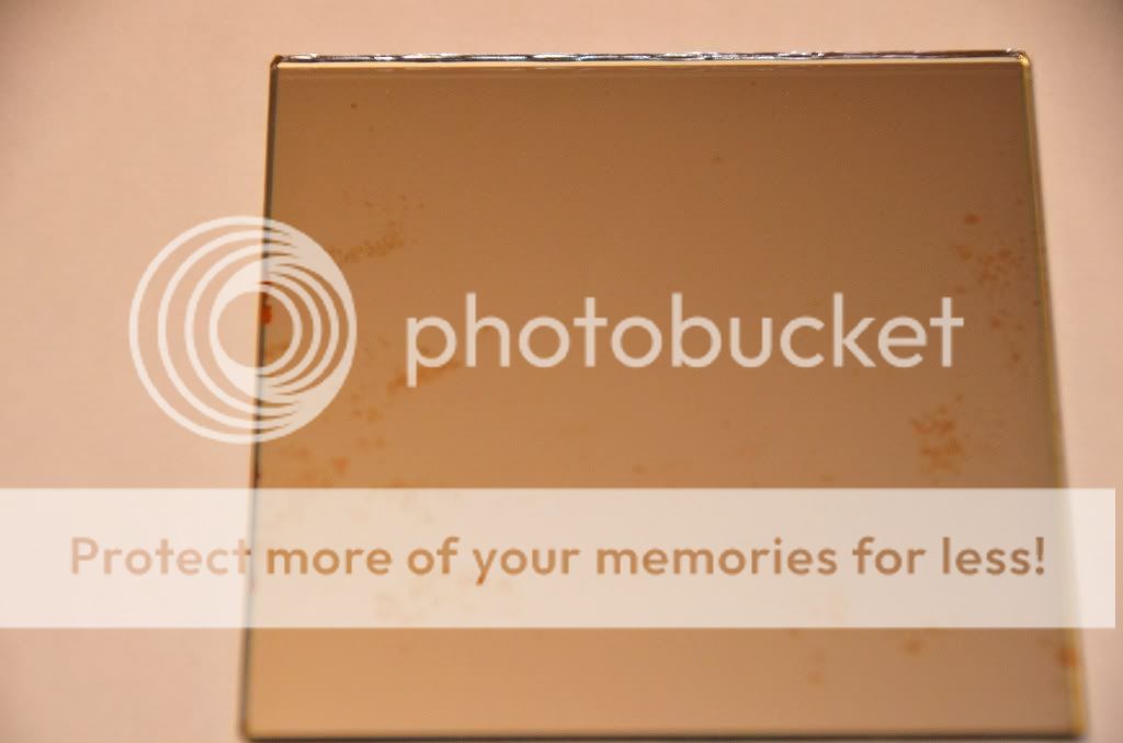

Hey folks, I am trying to get my 1st darkroom built and got said enlarger for next to nothing. The only issue is that the mirror seems to be comprimised, see below:
So what do I need to do? I have read on 'the net' that I need to go to a glass cutting shop and get a first surface mirror cut for the dimensions I need (about 4X4).
Is it that easy?
Durst parts in the US are next to no where (unless you want to pay way too much on the Bay) and I dont want to "throw out the baby with the bath water" and get a more American enlarger (i.e., Omega, Bessler) since this is perfect else for the mirror, so what do you think? This a easy fix for say $20 US or do I need some special Durst F60 branded mirror?

I don't think this needs to be a front surface mirror.
A quick simple fix to get up and printing is to put some diffusion material (Rosco Roscolux #116: Tough White Diffusion) in the filter holder and use it as a diffusion enlarger with the existing mirror. It should work fine.
Is the mirror next to the light bulb ? While I don't use the F60, I have a similar Durst and the mirror reflects the light source to the condensor glass so that the light is more 'even'. Which means even if the glass is dirty, it doesn't matter. If u can get the mirror cut, then by all means.
Not sure about that unless the mirror is frosted. I do see the mention to that in the literature but don't know what they are referring to; perhaps that the side of the bulb produces more even light. Since this is a condenser enlarge, I'd presume defects in the mirror will be noticeable in the prints.
from the diagram it looks like you don't need a first surface mirror, any glass mirror will do it is only used to bend the light 90° onto the film plane.
Thanks for all the comments folks! The mirror is not frosted. Just a regular, maybe 2mm think, second surface mirror. It is roughly 4X4, beveled on two of the edges. I am having trouble finding anywhere that has 2nd surface mirrors inexpensively cut to order online. And re-surfacing seems like a lot of work and costly. I called a glass store yesterday and the person about laughed at me when I asked for a 4 by 4 mirrorÂ…he was thinking 4 feet by 4 feetÂ…he he.

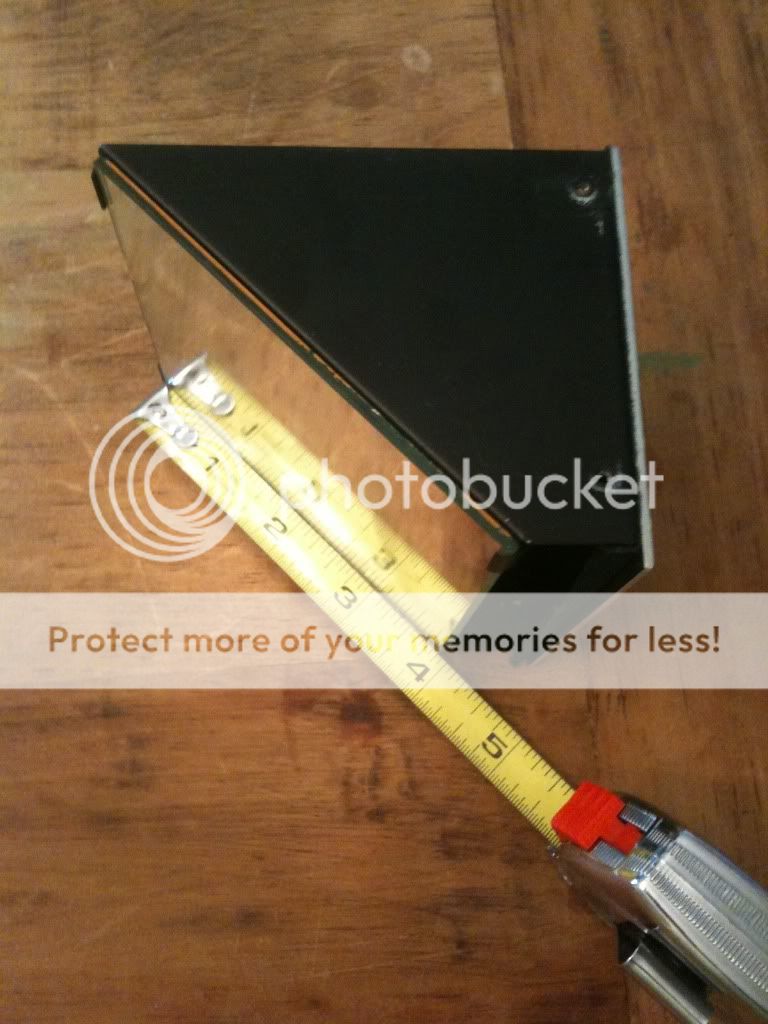

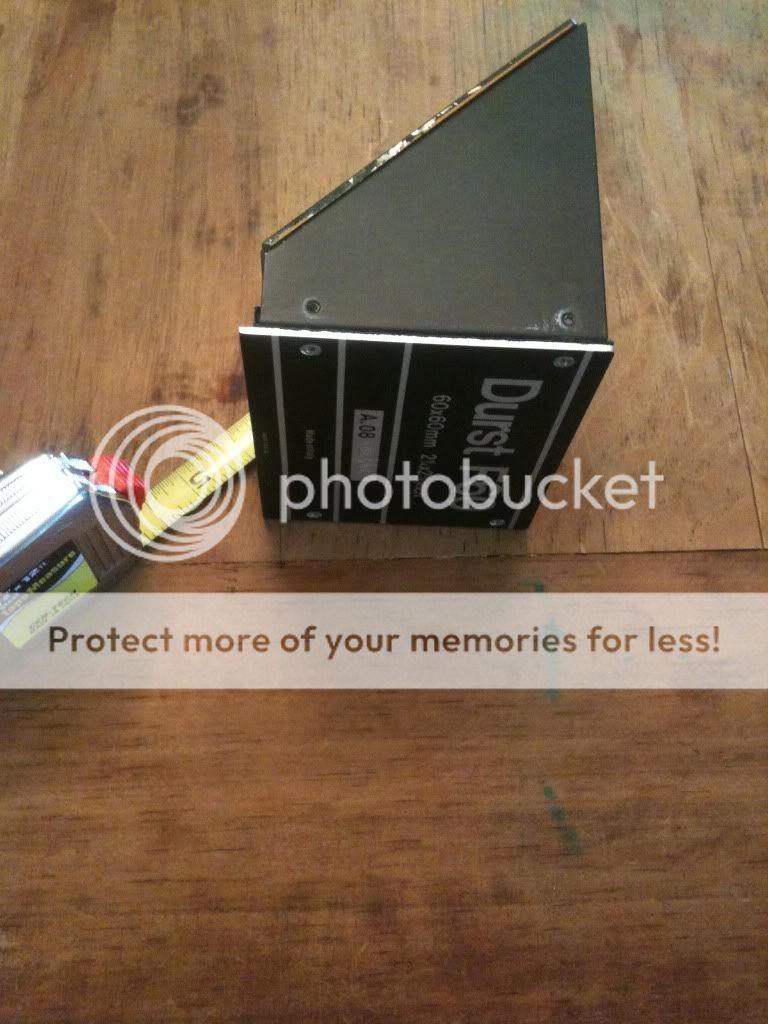

Some more views of the mirror assembly.
Any mirror rwill do, thickness isn't important either, it's just a shiny surface to bounce the light off. Ask the glass shop to cut a 4x4 single thickness mirror. No need to scrap a perfecly good enlarger over this.
Bring the block to show the guy in the glass store so he sees how it fits and maybe can compensate the size for the bevel on the edges.
Stuff at the class shop may be too thick. A hand mirror or mirror from a women's compact or makeup case might work with some cutting, which a glass shop or hardware store could probably do.

I have a Durst L184 10x10 enlarger with the V184 condenser head, and the two mirrors in that system are both back silvered.
Front silver seems to be a requirement when you are reflecting am image (e.g. SLR mirrors), but not where you are reflecting light before it reaches the negative.
Hence no need for cost and fraility the front silvered mirror...
Thanks Len for the confirmation. I agree this is a back silver mirror. Very thin but not front silver. Agree, no need to waste cash of something that adds no value to the enlarging.

How uneven is the illumination on the baseboard with the mirror like that?
Also, as I had mentioned, a six-dollar Rosco diffuser in the filter drawer can fix it for a few dollars.

Hey folks thanks soooo very much for all the advice. I think I am in production. I went to a local craft/hobby shop and bought a mirror then cut it myself. (Mirror $2.50 and glass cutter $6). I think it works just great!!! The Durst only projects the middle 3.5 inch square, so my rough edges dont affect quality. I am thrilled (I was able to test that by putting a plasic obstacle over the edge and then removing it and the light emitted was the same)!! Thanks so very much for all the ideas.
