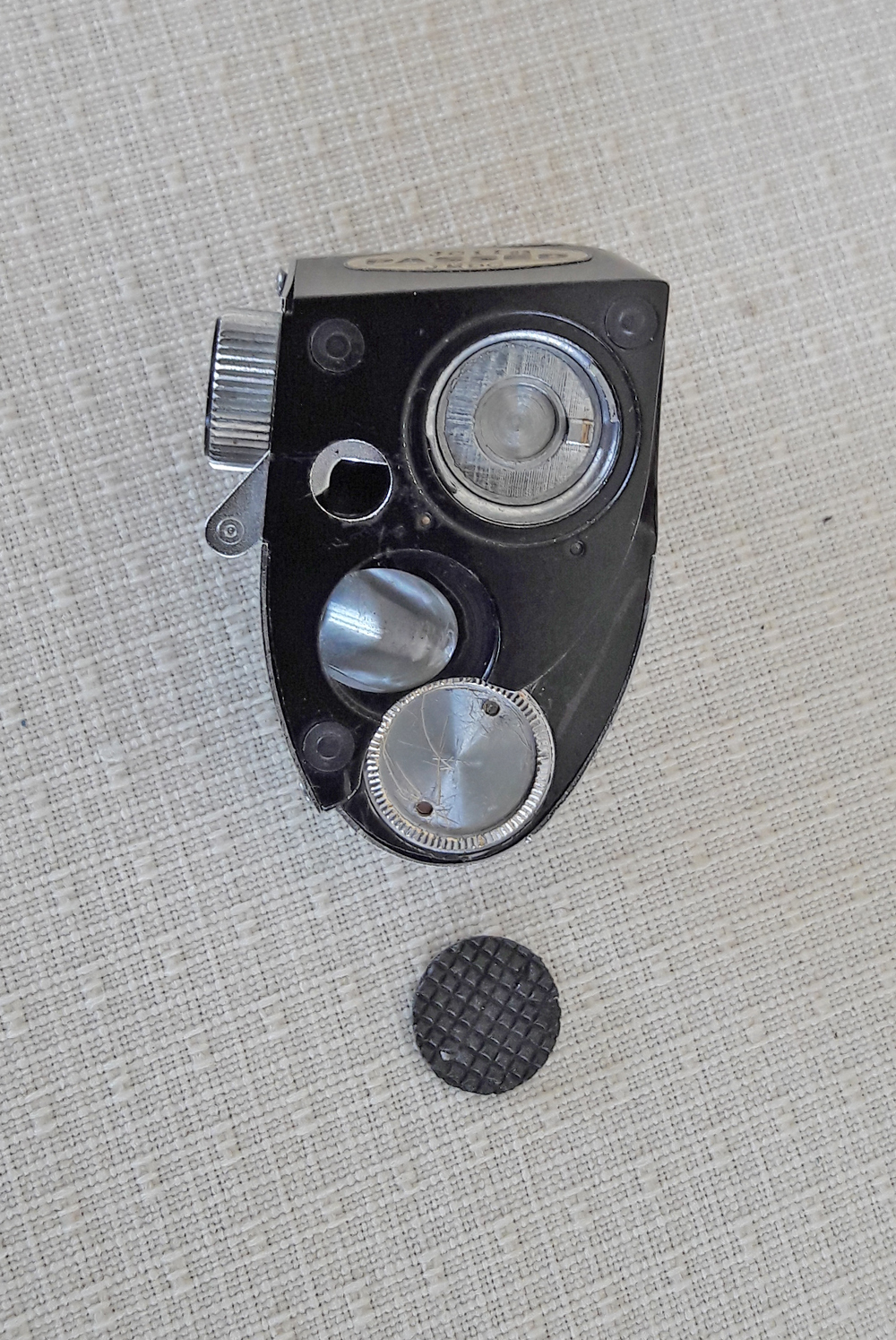

I cannot remove the battery cap on the cds meter used with a Miranda G camera.
The cap has a silvered knurled outer ring and a 'dimpled' inner central section.
However no matter what I try the cap does not come off.
The manual states remove by turning CCW.
Any help or suggestions welcome

I've tried exerting pressure/torque but to no avail - its extremely difficult to grab hold of the cap as it is almost flush with the surface of the meter into which it is screwed.
There is no slot into which a screwdriver/coin could ne fitted.
I've tried an eraser pressed hard against the dimpled surface of the cap AND tried pushing with a screwdriver and knife blade against the knurling.
The super glue option is possible as that would ensure a large torque BUT I think it a last resort.
One alternative is to do away with the meter (after all it is an accessory) - but I do not have the original speed dial to put back on in place

EUREKA - problem solved
removing the dimpled disk reveals two pin holes in the 'metal case' which enables the cap to be removed
regards
Tony

Removing the dimpled disk reveals two pin holes in the 'metal case' which enables the cap to be removed.
I do not rember ever having seen such design. Thank you for sharing.
Well, there are designs with plastic coin-slot cover and metal construction undernereath (eg. Minox 35), but then cover and metal threading are moulded together.
tonyowen34
Jan 22, 2017
50
Anglesey, UK, 53.3N 4.4W
Some further information:- The 'dimpled pad' had/has some 'sticky' adhesive that enabled it to adhere [albeit not permanently] to the 'metal ring' I've found that if I push the pad back into the ring it 'seems to' click into place and stay there; until I lever it out again!!
