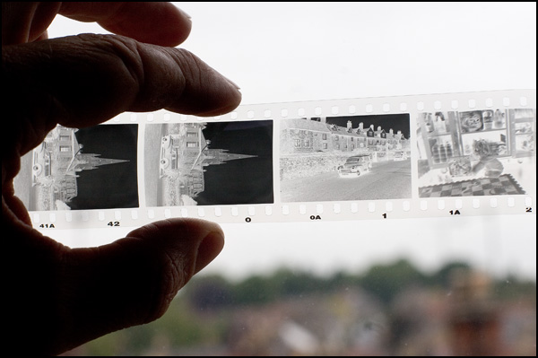

I have used a fair amount of Gigabit it looks like this:
It's pretty contrasty even when used with the SPUR? dev I have heard that some people have processed Copex in Rodinal 1:100.
