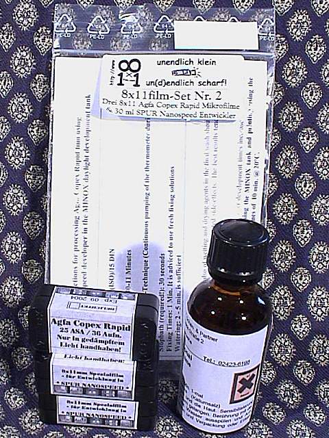

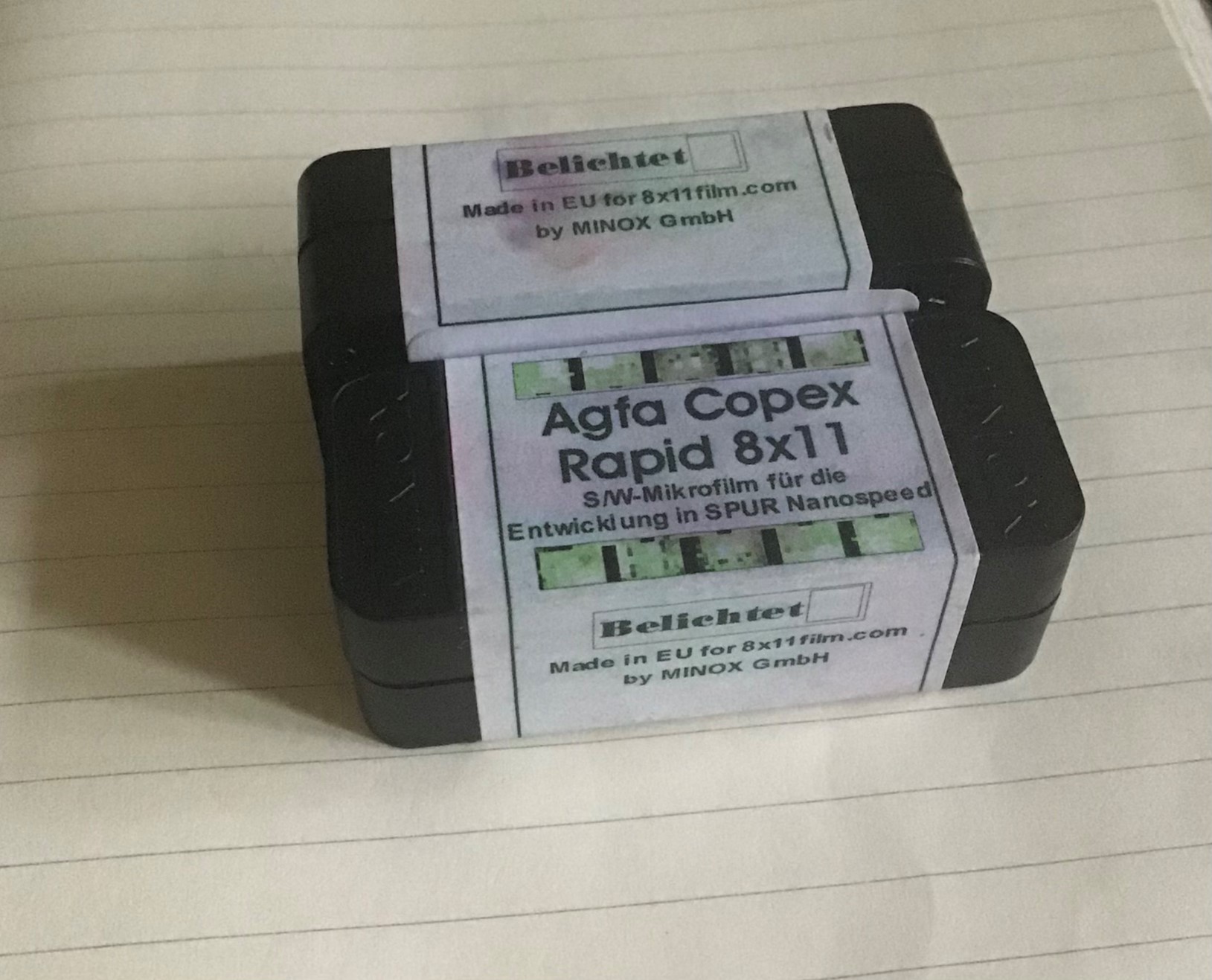

I bought a lot of old Minox film on ebay to harvest the cassettes. In the lot were two rolls of Copex Rapid sold by 8x11film.com:
Given the slow speed of this film, I think it might be worth shooting them. Two questions:
Can anyone estimate how old these are?
Can anyone recommend a developer?
Thanks!

The label indicates to use Spur Nanospeed. Looks like one could buy them together at one time.
Yes, it seems Spur partnered with Minox to market interesting film / developer packages. Digging around on Subclub, I think the films are probably 20 years old. With such a slow speed I don't think I need to reduce ISO any lower.
