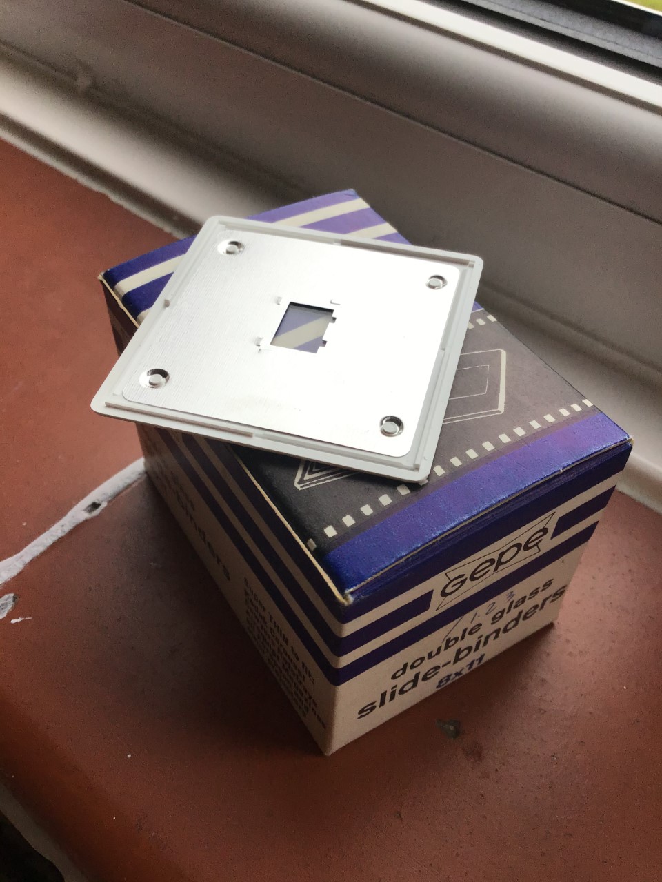

Hello All,
  • I've got some Gepe slide mounts for 8x11 - not the tiny Minox mounts for the dedicated projector - but rather 35mm slide mounts masked for 8x11.
  • I've got a Minox B
  • And I've just noticed MS Hobbies is selling Velvia in Minox cassettes
I can see a fun project here. I wanted to know has anyone here ever projected 8x11 slides? And especially, what was mounting them like? I fear that will be awfully fiddly.

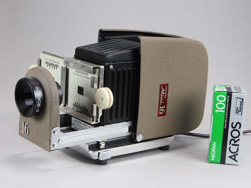

I have projected home developed Anscochrome slides in cardboard 2x2 mounts using a Minolta 16 projector "back in the day." I honestly don't remember how much trouble the mounts were, as it was probably in the late 1960s or early 70s that I did it. I still have all the aforementioned stuff, and I did recently try the projector out -- the original bulb still works! The years have not been kind to the slides however.
The projector uses a 75 watt bulb and has a 40 mm f2.5 P-Rokkor projection lens.
From such a small frame the results on screen will not be confused with medium format, but it could be fun (and today's color films are likely better).

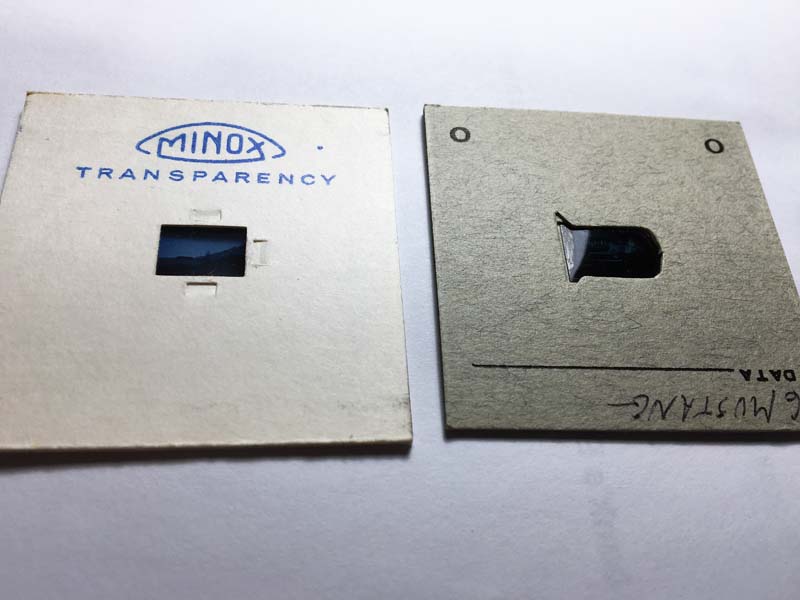

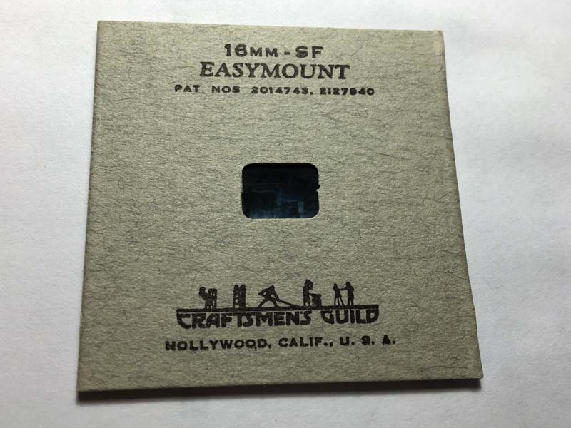

A minuscule amount of information from the "museum" here ...
2x2 mounts from Minox and "Easymount" from the Craftsmen's Guild (Hollywood, CA, USA.)
_iP9841_2x2_MinoxSlideMounts_PositioningSide.jpg _iP9842_2x2_Minox_Mount_Mfr_Info.jpg (click to enlarge)
I believe the Minox was a heat sealed cardboard item which I no doubt would have done with an iron used for clothing (but no steam enabled). One can see the backs of some nubs that were raised on the inner surface to provide guides for the film. The Easymount has a widened slot at one end of the frame mask that permits just sliding the film in until it snaps into place. I no doubt would have cut the film over a light table (or equivalent) with scissors and maybe used tweezers -- or not. (But then 50+ years ago was before I wore glasses or went through cataracts and surgery!)
