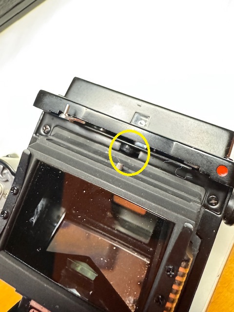

So my new flea market find -- a late-model Minolta XK in excellent condition -- has an issue I'm looking to fix. The AE-S finder's "aperture follower lever" is stuck to the right (as you face the camera, next to the red dot as in the photo below).
When I remount the finder to the body, the aperture lever remains in this position and is unable to properly engage the lens' aperture ring.
Above is the correct and only position when mounting the finder to the body. The finder will not snap mount if the aperture follower lever is on the left side.
There is a springed plunger button in the middle of the finder's bottom front that is supposed to unlatch the aperture follower lever, sending it back to the left (so that it might engage with the aperture ring tab on an MD lens).
I was able to trigger the plunger button with a small screwdriver, however, the plunger was not depressing far enough when I remounted the finder. Pictured below is the button circled in yellow, with the aperture follower lever "unlatched" on the left from the red-dot side:
As this is my first XK I'm not sure how this mechanism should work.
I cocked and triggered the aperture follower lever several times to see if it was just gunked up. No change.
The finder won't mount unless the aperture follower lever is on the right side next to the red dot. But how should the lever swing back so that it catches and controls the lens' aperture ring??
I guess that in my example the button circled in yellow is not depressing enough under normal circumstances. Maybe it needs to be adjusted from the inside?
Thanks in advance for your suggestions...

This is a common "problem". Usually it just means that the finder was not put on to the camera straight enough. Since the plunger works, it's just a matter of getting the plunger to connect correctly with the edge of the camera body. If inserted at an angle, the connection won't occur.
The plunger does not look dented/bend/worn-out/etc. Give it a few more tries. My guess is that putting the finder on straighter will solve the problem -- but what do I know?

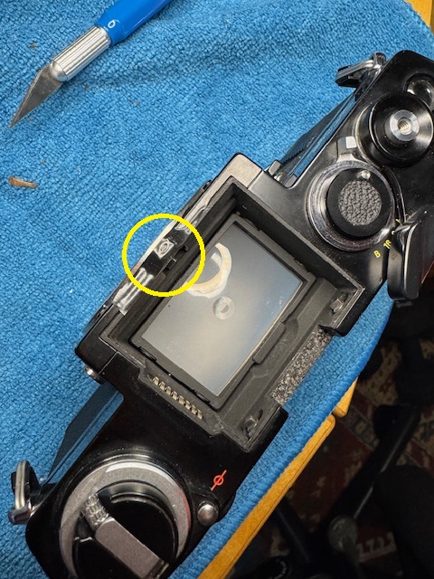

Thanks very much, xkaes, for looking at this. Further searching led me to what I believe is the issue and a solution that I'll try.
It's described here:
(Start reading halfway down the page at the paragraph beginning with "Below is a very different problem which afflicts almost every Minolta AE-S and AE viewfinder...")
His solution is to build up the body edge where the plunger strikes so that the plunger depresses more deeply into the finder, thus releasing the cocked coupler lever to the proper post-mount position.
gummybob uses a bit of wood covered with electrical tape 🤨

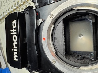

Fixed it. Following Gummybob's instructions, I cut a small piece of a wooden matchstick and electrical-taped it to the front body panel like this:
The nub there is enough to trigger the aperture arm when the finder is mounted.
I'll go back later and improve my taping but for now, I can meter/shoot with MD auto lenses and further test the camera.
