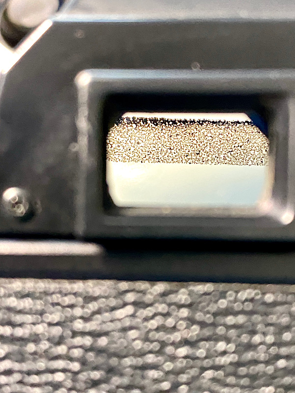

Hello all.
So I just got this XG-A. I'm going through the cleaning process. I just replaced light seals and cleaned the view finder and mirrors. I'm totally new so I couldn't/ wouldn't know what each mirror / part is called.

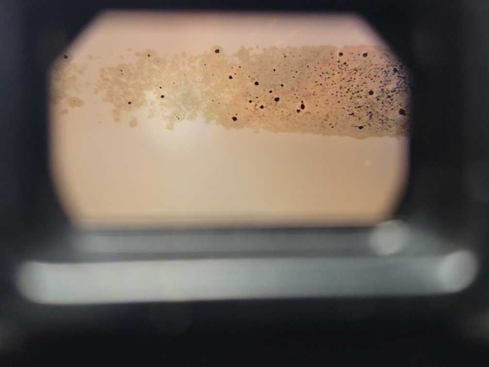

Anyway, I cleaned what I could see but there's absolutely no difference in the dirt you see. It looks like a strip of tape or something was across somewhat of it. How would I clean this? What do I do? I used glasses cleaner but like I said, there's zero difference. What do I do from here?
I've been told I need to replace the prism. Is that correct?
If it is correct, I've searched Googles but there's different part numbers etc. I'm sure it's like old car parts, some are specific, some interchangeable.
Do all X models use the same prism? Only one model?
Do I have to get an XG-A for a parts camera?
Is it even called a prism? What's the proper part name?
Are there manuals on how to replace this? I have yet to find anything.
Other forums provid me with the useless "it's easy" then someone else says "it's complicated " but absolutely no one has answered me on how to repair it.
I cannot find a service manual anywhere.
Any help would be greatly appreciated.

Images of the prism

You'll find a lot of tape around the prisms in Minolta cameras, so that's nothing unusual.
One thing to keep in mind is wherever this dirt is, it won't affect the pictures. And the dirt could be anywhere. Replacing the prism should be the last thing to do. Even if you could find a replacement prism it's probably going to cost more that a replacement XG-A.

It looks like the dirt might be on the focusing screen. If you have the tools & time & talent you might be able to fix it, but there are lots of better XG cameras that you can get for close to the price of shipping. Here's a comparison table. The GREAT XG-9 can be found for $20 and has many more features.

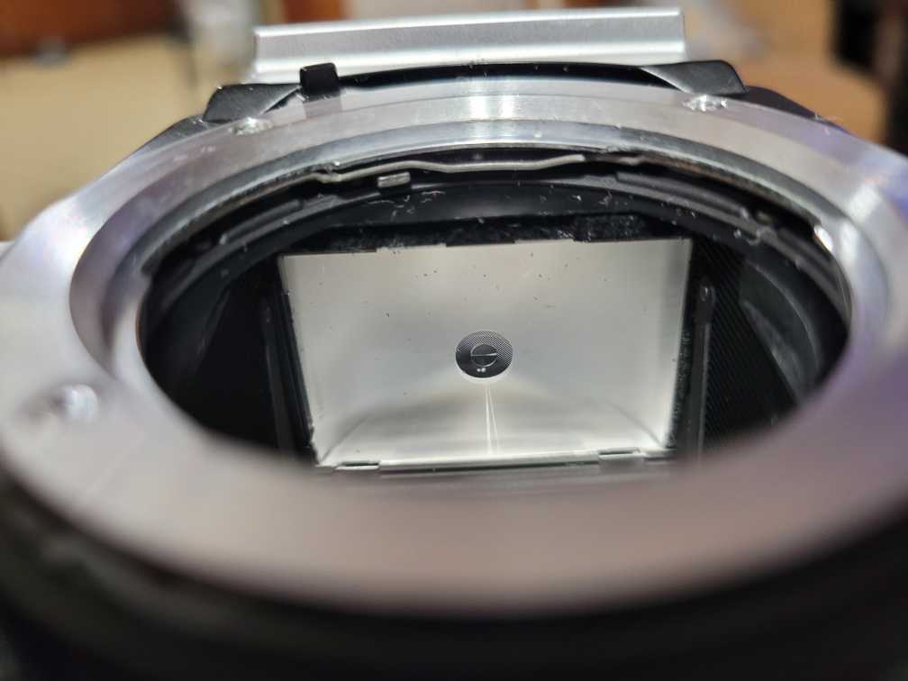

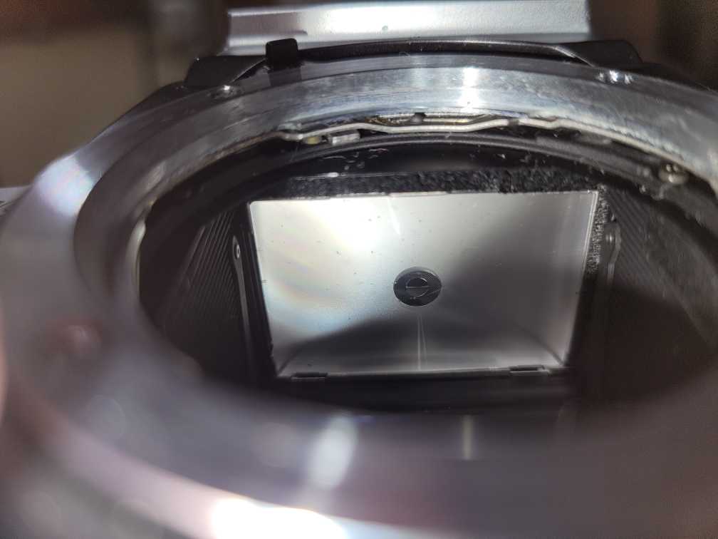

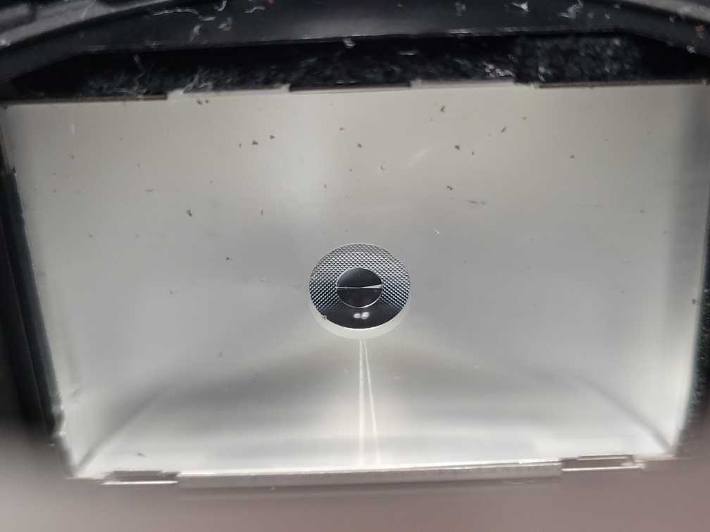

So like I show in the pictures, is that the prism? That I see through the view finder?
http://www.subclub.org/minman/slrtable.php
So like I have in the pictures, the shot I have looking through the view finder, is that the focusing screen?
Or is that the plastic piece opposite the mirror?

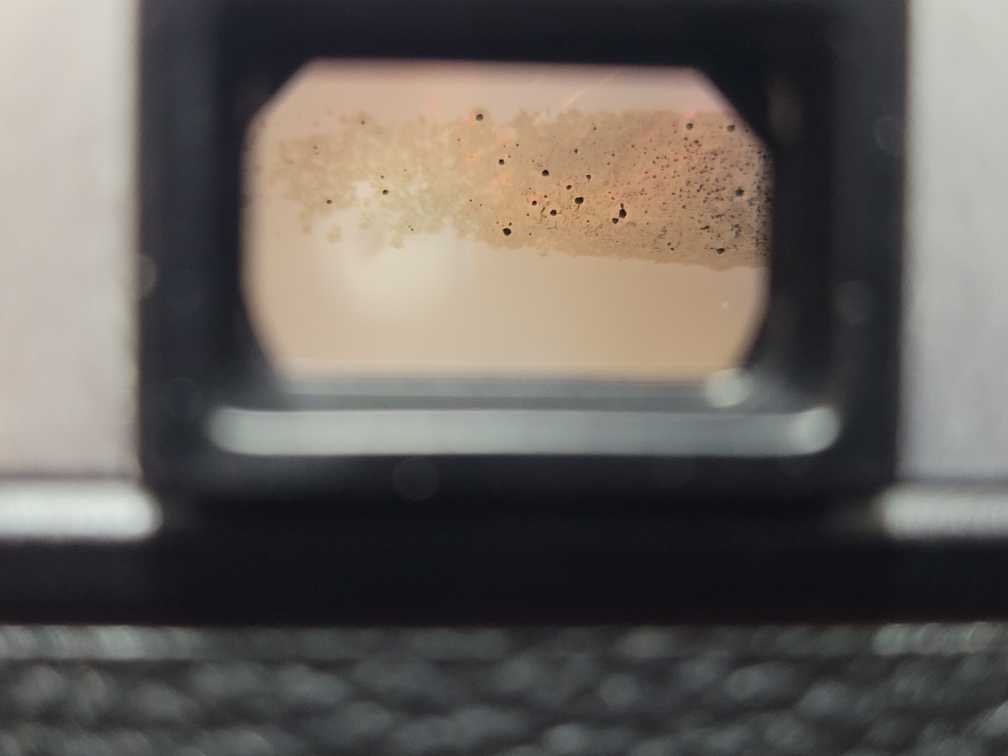

I have this problem with a Minolta X-7.
Apparently the coating on the outside of the prism has come off due to a rotting adhesive strip.
Perhaps the reflective coating can be repaired with silver paint.
Otherwise, it is possible to install a replacement from another X-7. However, this might also have the problem.

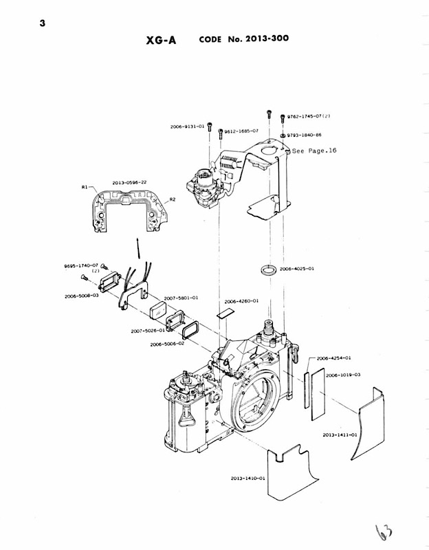

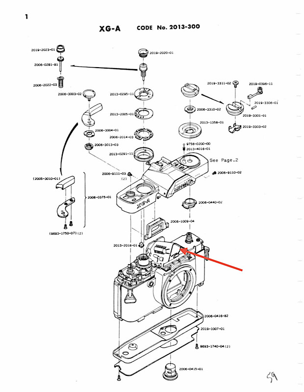

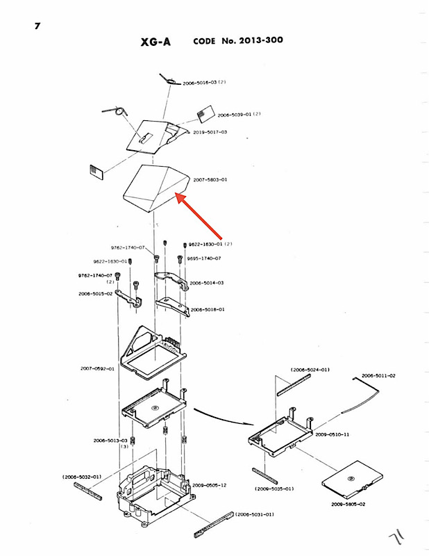

The path to the prism (maybe also the mirror box has to be removed, see service manual):
A lot of work that requires experience, soldering skills and the right tools.
I don't think the camera needs to be readjusted after a replacement.
I have decided not to do anything about my X-7. But I will keep an eye on the problem to see if it progresses.
This should not affect the image result, even if the camera measures the exposure using measuring cells on the prism. The deviation should be too small for that.
More precise information would have to be obtained by measuring the exposure system or taking test shots.
With such extensive disassembling work there is always the risk of damaging something, so I would only replace the prism if the viewfinder image is severely affected.
With my X-7 the damage is almost unnoticeable when I hold the camera to my eye.
Your first two pictures should show the part of the prism that is probably damaged. On the other pictures you see the focusing screen from below.
If you hold the XG-A to your eye, you will see the focusing screen from above. If no artefacts are visible here, the focusing screen is OK.

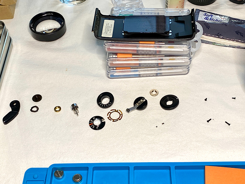

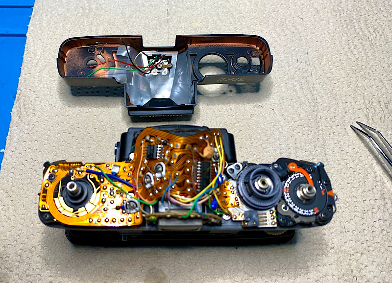

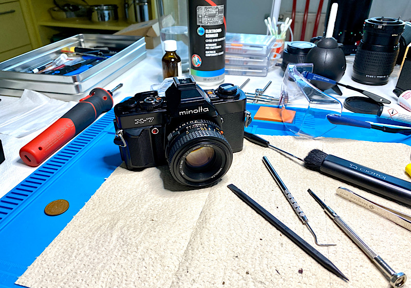

Some impressions of my Minolta X-7 project, showing the removal of the top cover, the circuit board underneath and some of the tools used (see link above).
There is still a long way to go to the prism underneath.
