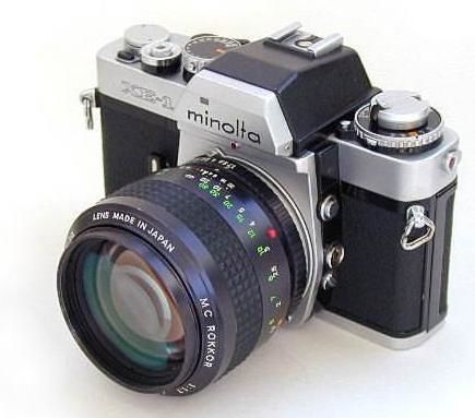

I have the XE-1 which is the European version in chrome and black rather than all black. It has become one of my favourites.
Steve.
