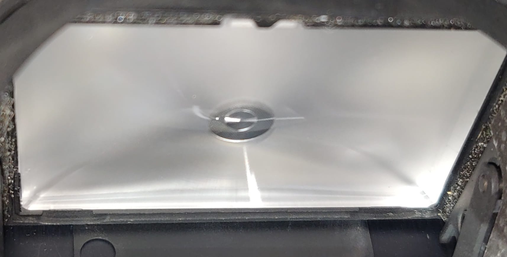

Dear all,
I bought a used Minolta XD7 (identical to the XD11 sold in the US), which works perfectly despite a misalignment of the focus through the eyepiece and the result on the film. With the aperture open, my focus is always behind the plane I'm trying to focus on. However, the misalignment is small enough for narrow apertures to compensate. I use M42 lenses through an adapter, but recently decided to use native MD/MC lenses from Minolta and also noticed that I can't go to infinity through the eyepiece. I assumed that I had messed up the focus somehow. But with that in mind, I'm looking for a solution.

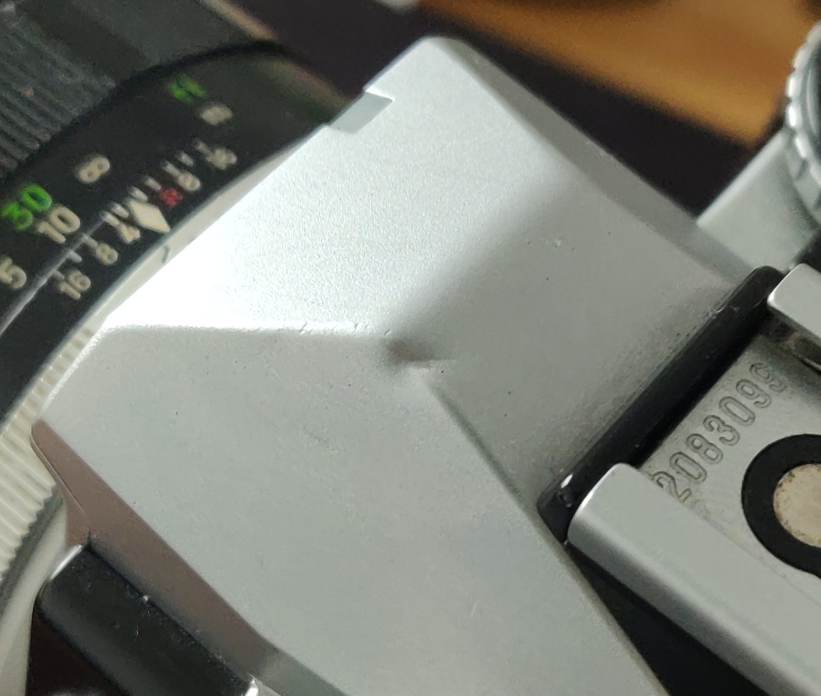

About myself: I'm somewhere between amateur and intermediate when it comes to do-it-yourself repairs. With a manual or a good hint I can work ok. So I have already tried to find some repair manuals or videos. However, I cannot seem to find anything. I have already taken a look at the ground glass and if it is not aligned properly. A photo of the current state is attached. From my point of view, the ground glass is properly mounted inside the body. It seems that the camera was also dropped before I bought it. A picture of the dent on top of the prism is also included. If it is not the prism, I assume that the screw holding the mirror in the non-triggered state is slightly misplaced. I cannot find any reference to ways to "recalibrate" the focus properly. Does anyone have a good source/manual/etc. that might be helpful? I've seen DIY collimator manuals before. So this tool should not be a problem.
Looking forward to your responses. Also apologies if I did not use the correct terminology in my post.
Best,
z0r

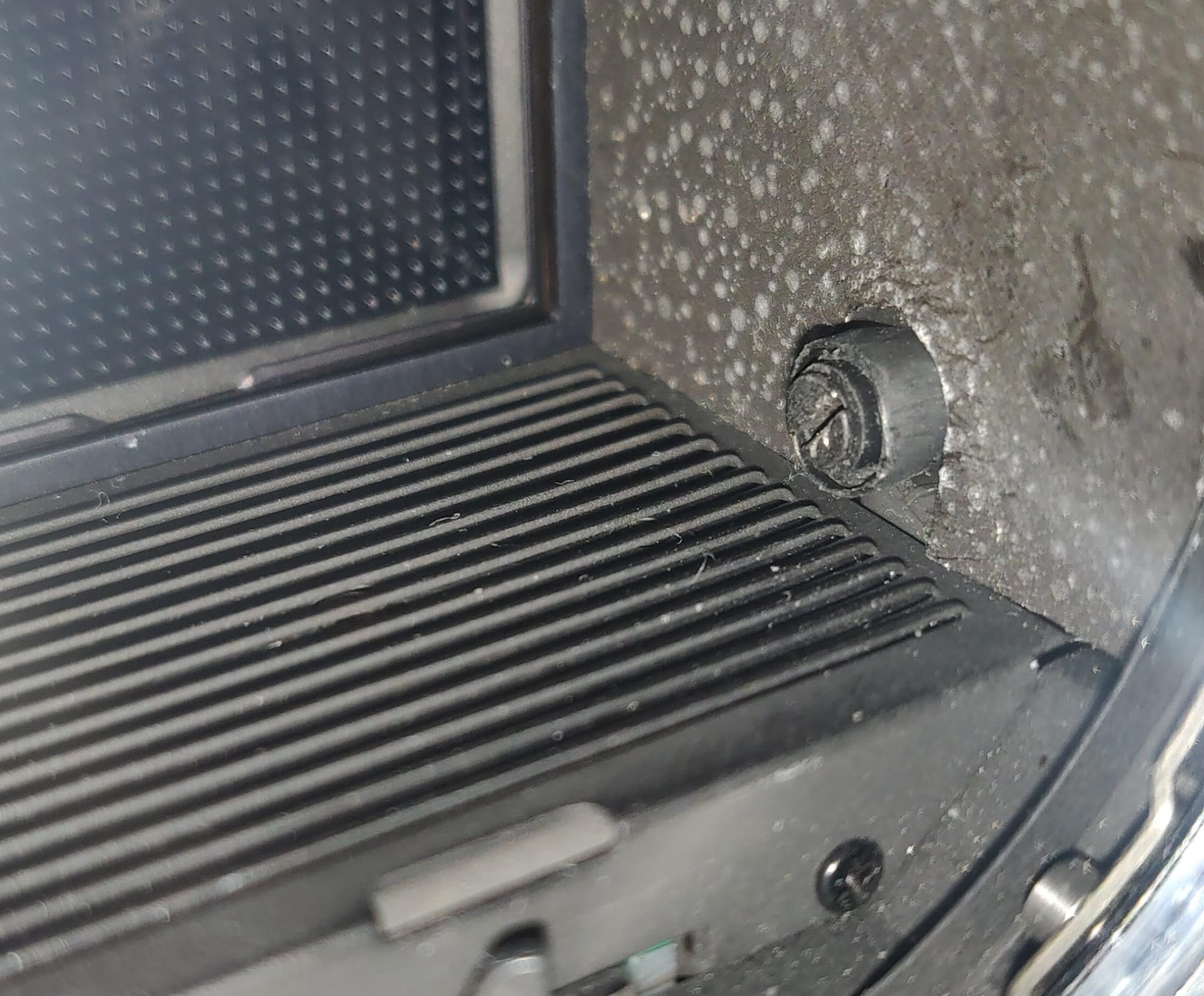

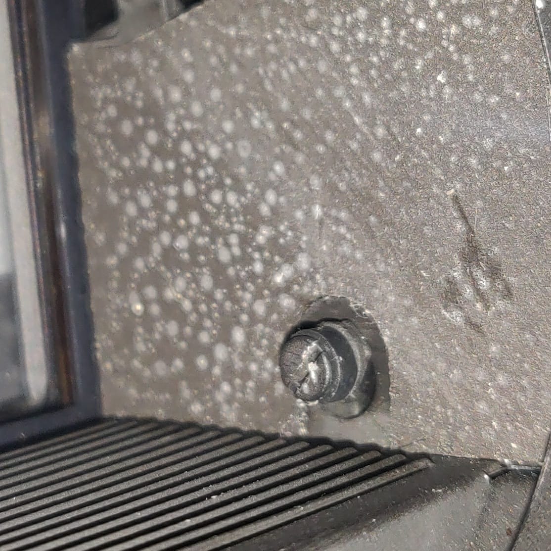

I have one of those where I've oddly needed to shim the lens mount (focus on film as well as screen was out) and another (or maybe both issues were on the same one) where the mirror appeared to rest too low. The mirror stop is adjustable, the stop itself is a cam, you just need to turn it. In my case the range was insufficient so I put heat-shrink tubing around it, I assume it has lost some rubber padding.
You will need some ground glass on the film rails to assess.

If I need to shim the lens mount, then my focus should be in front of my plane of interest, am I right? Because in my case it is behind the plane of interest.
In my case the focus was too far out/overshot infinity both on film and on the focusing screen, with all my lenses. Only mess with the lens mount if all three factors apply.
Readjusting the mirror stop screw seems quite tedious. Do you have an idea to do that properly?
I don't know about properly, to me the only way doable at home seems to be to adjust focus to film plane, then adjust the mirror until it matches. It's a flathead screw but you can't manoeuvre a screwdriver into it due to its location, so I used a small cheap kitchen knife. Not ideal, but worked.
Using heat-shrink tube is a clever idea on the other side. This might solve it "quick and dirty". Did you shrink it with a solder tip? Because using a lighter seems like a bad idea 🤓
Indeed, I used a soldering iron.
EDIT: Also: I guess the "professional" way is perform readjusting in the prism and induce a length modification there? Does anybody know something about this?
For sure, if the prism is the culprit, and the ding on the prism housing doesn't restrict its motion. I don't remember for sure whether it's adjustable but I think so. The service manual is online somewhere, check butkus and the "learn camera repair" websites.

By visually confirming best sharpness on the ground glass, the best I can achieve is done by three layers of heat-shrink. Shrunk them prior to insertion to a fitting size with a lighter. Using a solder iron inside the body was a bit tricky and I dismissed it. The result is attached.

As I wrote above, you can adjust the mirror stop itself, that just wasn't enough in my case. The stop itself turns, use the slot. It's a cam (ein Exzenter:smile:), don't worry, it doesn't simply unscrew. See how the rim around the screw head is thicker toward the front or bottom in your pic? Turn that part toward the mirror!

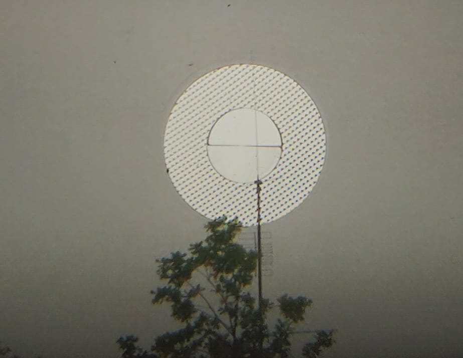

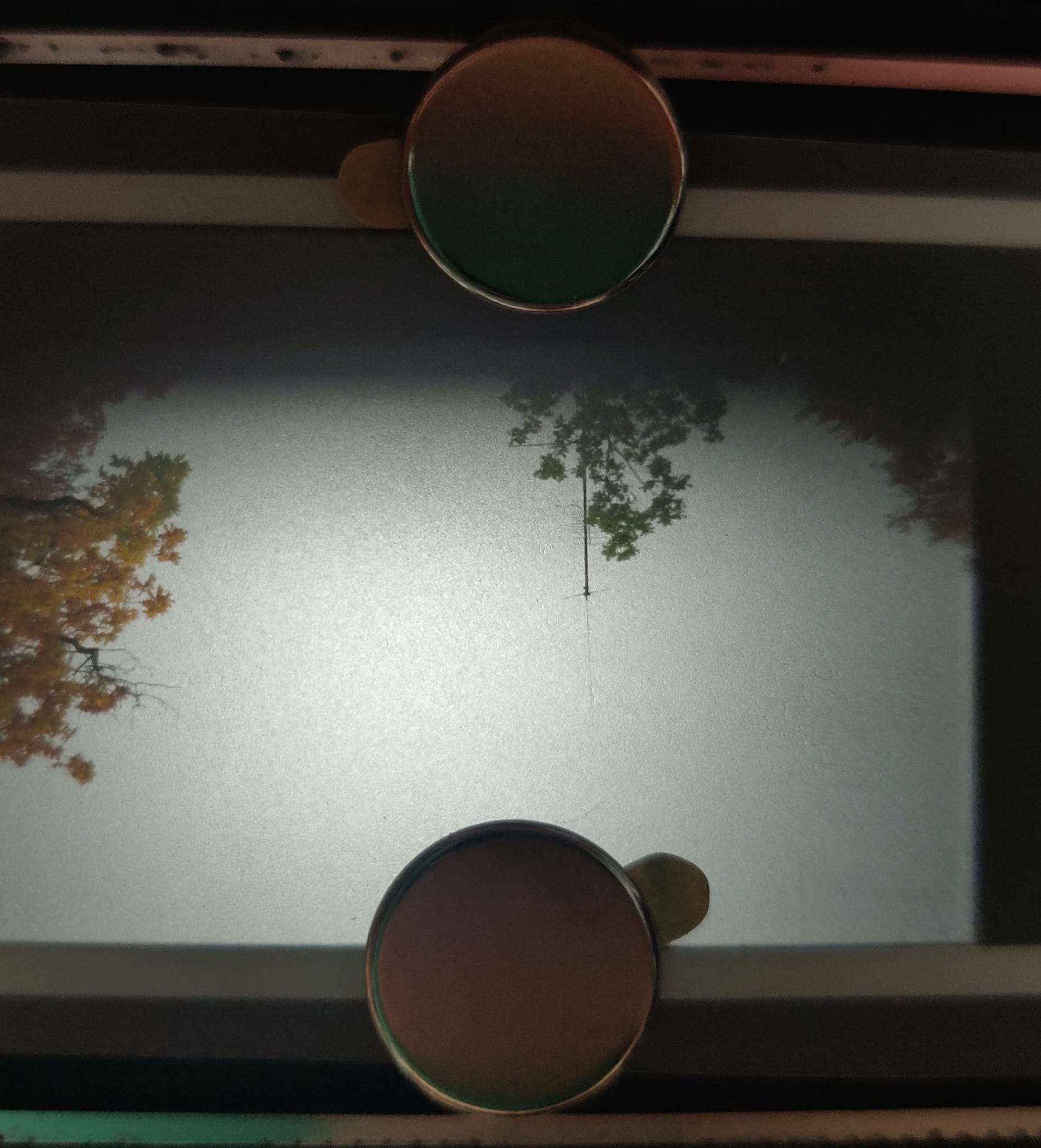

Attached are pictures of the current state with a 200mm MD Lens. one is through the eyepiece, having a far located antenna in the center (~86m away). The other shows the result on the ground glass.
What I set as plane of interest is now sharp. However, I can focus now beyond infinity as it seems. Can you illuminate me here? My guess is that the mirror is not the problem? I'm not completly sure, nevertheless.

Could be the lens, have you tried other lenses? If it persist and you're certain it's the case at the film plane, it appears that you need to shim your lens mount, too. Weird. But maybe these came with shims from the factory and they got lost during repairs?
