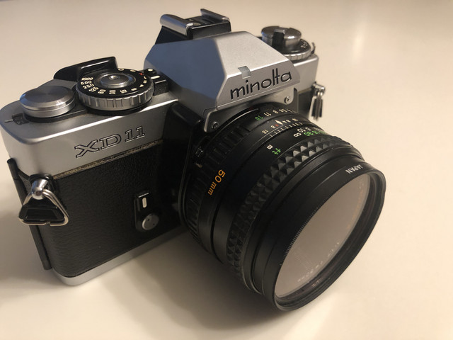

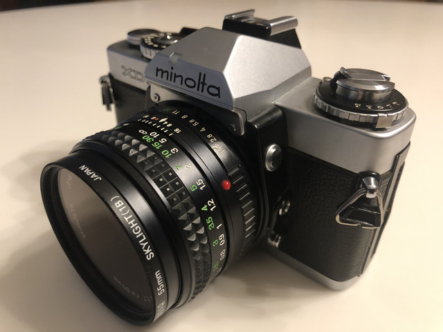

I'm a sucker for "broken" cameras. Don't ask me why, but I like trying to get them running again. However, sometimes they are beyond repair. It's always a bit of a gamble. Well, this gamble has paid off.
There was a Minolta XD-11 being offered locally; ad said that it was being sold for parts/repair because the mirror was stuck. I sent an inquiry requesting to see what the battery compartment looked like. Seller responded with a photo, and it looked clean. Price was quite reasonable ($38 shipped to my door) and camera came with a MD Rokkor-X 50mm 1.7 and an Auto 200X flash.

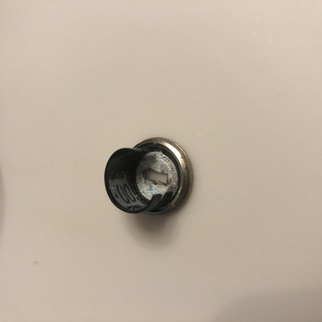

Camera arrived today. Upon initial inspection, when I removed the battery cover, I saw right away what the problem may have been: corrosion on the inside of the cover.
I have another XD-11 with batteries in it, so I just swapped out the batteries (and cover) of the working camera with this camera. Voila! Camera meter came to life. I then fired away a few test shots in aperture priority mode. All good. I then went through all of the shutter speeds in manual mode; again, all good. Self-timer works just fine too.

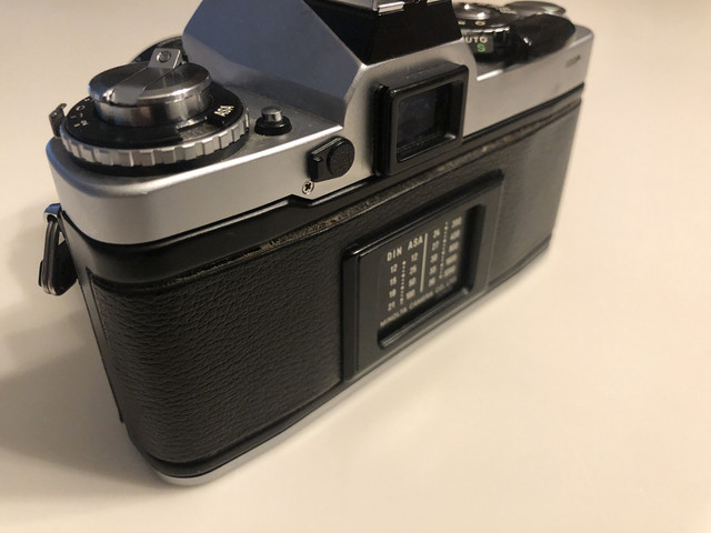

This is a nice XD-11 copy that appears to have been well taken care of. The battery cover should clean up and be useable again. The film advance smooth. Only thing on the camera that needs any work are the light seals, which is expected of a camera of this vintage.
The lens, though, may need a tune up. Focusing is a bit too firm, and it feels a bit "grainy" when it is turned; needs to be cleaned. Also, the UV ring is a bit stuck; will play with that more a little later. As for the flash, while the battery compartment itself is clean, the metal on the inside cover looks just like the camera's battery cover. Will clean and test that later.
Overall, I almost feel bad for having picked up this camera for such a low price. But it was a gamble on my part, as I have many a story of picking up old cameras that didn't turn out as well.
