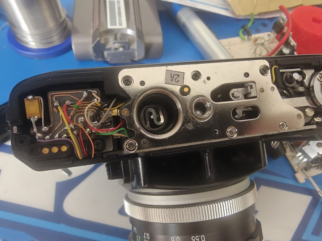

Hi guys wondering if you can help, Im try solve the shutter getting stuck problem on my Minolta's X700.
I replaced both capacitors ..bottom and top .. even if they seemed to be fine. Once inserting the battery everything works fine...the problem is when left in the OFF position overnight...in the morning it will not work...it will not fire at all ...the only way to bring back to life is to pull out and reinsert the battery again and everything is back to normal.
Yesterday I left the camera with 2.8v at the battery and 1.8v at the cap...... overnight the battery is down to 1.3v and the cap is at 0.8v....it will not fire. Replaced battery and is back to normal....2.9v at battery and 2v at capacitor. Definitely something draining the battery overnight
๐Ÿ˜ต
,any ideas ? it seems the caps are not the problem as was the same problem with the old caps.. thanx
Welcome to Photrio!

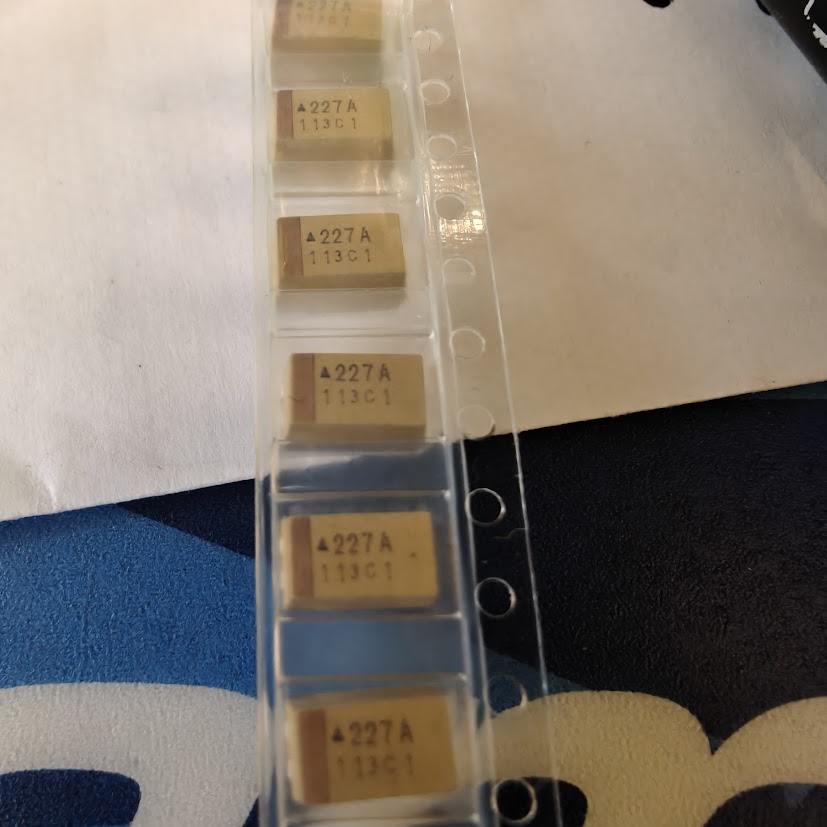

I see you replaced the original electrolytic capacitor with a tantalum capacitor. If you reverse the polarity on those, they'll act as a near-short and drain the battery. Did you verify that you installed it correctly?
Welcome to Photrio!
yes ..the - is the right terminal on the photo ..., previous cap was soldered same way with - on the right pin on the board, unless i got it wrong ...the line on the tantalum side is the - ? correct?
No, that's why I asked. It's a pitfall with tantalum caps. The band is on the positive (+) terminal.
thanx... i just swapped the polarity on the bottom cap , now it reads nearly 3v , in the process to swap the top one to , will update soon. thanx
Yeah, you need to do both. I bet this will fix the massive drain issue.
So I swapped the polarities on both caps ..silly me ๐Ÿคฃ, and it seems to have stopped the drain, I left the battery and capacitor at 2.9v.....,11 Hours later ....both still at 2.9v ๐ŸŽ‰๐ŸŽ‰๐ŸŽ‰ and firing along ๐Ÿ˜, , problem solved it seems Thank you for pointing out the capacitors polarities time to shoot some photos.
